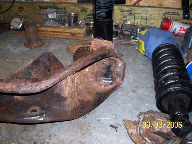

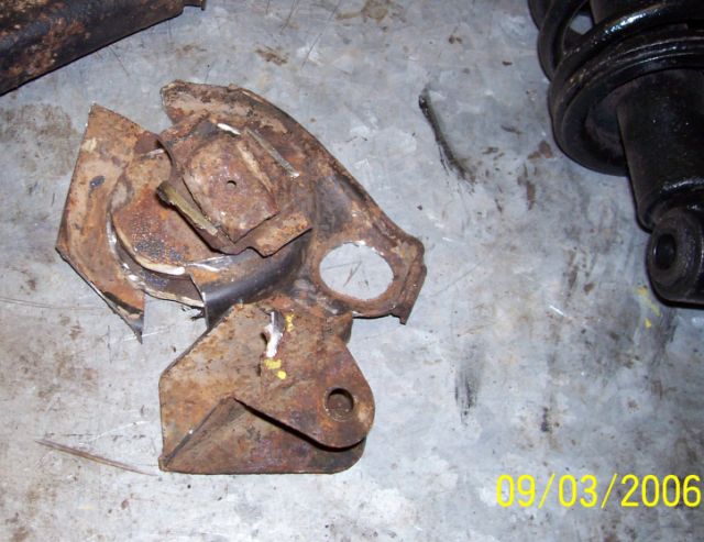

here are some of the pics of the start of the suspension upgrade will post all pics of the progress
here is the lower control are trimmed of all the unnessesary pieces
this is the jag coil over modified for ajustable spring height
easy to do just remove the stock spring and spring mount
then install the new spring and threaded sleave and install the spring stop
here is the cross member with the spring cup and bump stop removed

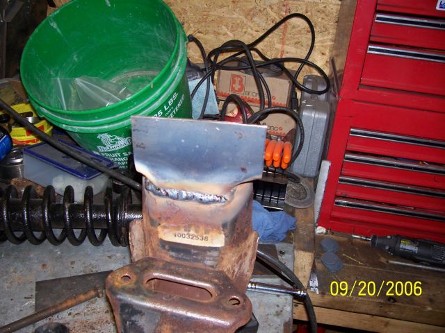

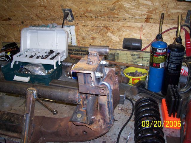

here is what has been modified to accept the new coilovers

using the jig I made will keep every mounting hole exactly where it needs to be

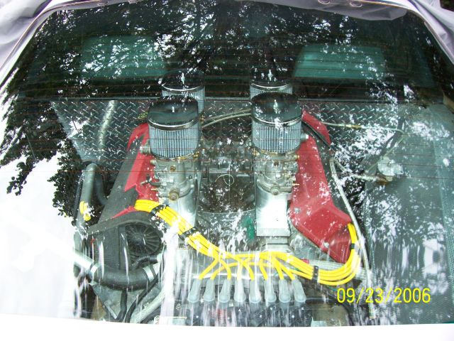

well picked up the new intakes tonight made of 2 30 LBS blocks of aluminum .They are made to be used with the carbs and if the carbs done give the the smooth responce I want I will bring them to the machine shop and have the butterflys installed and the injector bosses milled out for fuel injection
bubbajoexxx
Posts: 1537
From: Ontario Canada
Total ratings: 112
09-23-2006 09:49 PM Click Here to See the Profile for bubbajoexxxClick Here to visit bubbajoexxx's HomePageClick Here to Email bubbajoexxxSend a Private Message to bubbajoexxxEdit/Delete MessageReply w/QuoteDirect Link to This Post
well got the new intakes installed and now have the breathers back on they way I want them

Originally posted by bubbajoexxx:
That is the most beautiful thing I have seen in a long time. Nice work!!
Welcome to the light!!!

Is the bottom tapered to the square/rectangular intake ports?

That's hot.
not needed as they drop right into the ports and are equal to the carb bore

ahh. Are you using o rings for sealing like the stock '00 manifold?
btw, how much did they set you back? (dare I ask?...)
150 per side to machine and 7.50 per pound for the aluminum stock at 60 pounds no orings I use hight temp rubber gasket composite
wow, I would have thought that was backwards - $500 for the machining, $150 for the al stock. You should find a cheaper source of aluminum. Usually it's about $2/lb new, like 80c/lb scrap
