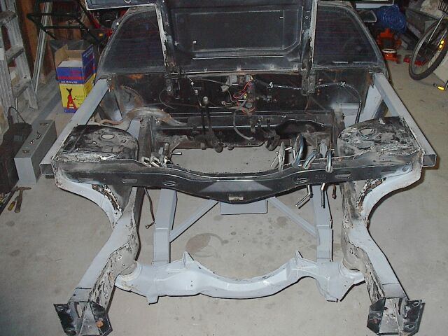

rear section removed from the car as you can see its not part of the car

Are you going to cut in some side windows to help with the HUGE blind spots? Or, yo could add some small video cameras.
Looking good,

bubbajoexxx, what thickness metal stock did you use for the extensions? Also, what did you use specifically on the cradle?

1/8 on extention and 100 wall on upper rails and cross bars and 3/16 on the cradle

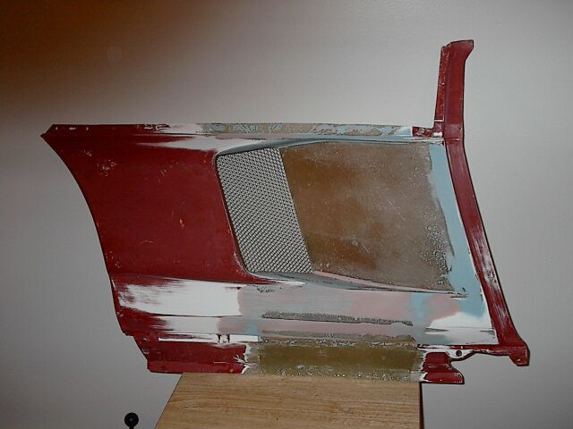

to answer 8ball it a north star and for todays update just finished the side scoops to fill in the lower body here are the before and after pics

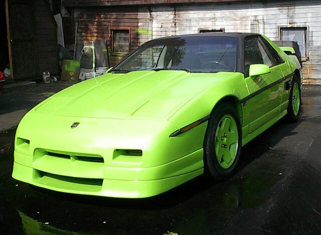

Hey bubbajoe, can we see that green car under the tarp next to your project?

Ya no problem GORDO
84 Fiero 4.9 V8 digital dash full gt package
86 vette hood scoop and much more

That green Fiero has a future in my driveway.
Built by Bubbajoe, it is one sweet ride!

latest update scoops on the car and they fit perfect
should provide plenty of air for the side mounted rads
