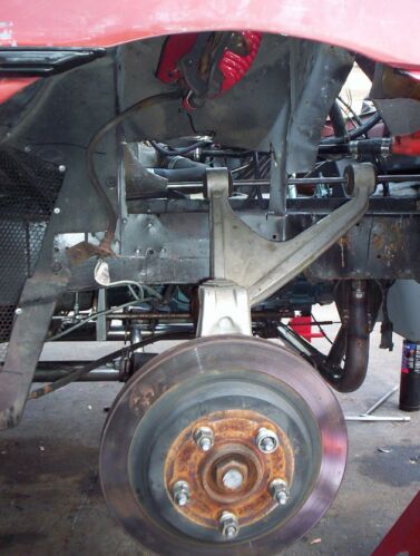

got some work in today removed the old suspension and made up the new coilovers
and stated to mock up the new uprights so I can make the upper controll arm mounts

one more pic of the rear upright

well got the rear mounts done and started to mock up the upperr controll arms in the car will be removing the old stut towers and installing a ladder style chassie cross bar to stiffen the upper frame rails. Here are the pics so far
as you can see here the rubber mounts in the rear have been elliminated
in favor of sold mounting
have also changed the rear bearings to S10 as they are the same dia. as the vette just had to move the holes outward 30 thou.
now I can keep my axles

well to day is a day with screwed ip weather fist sonny the duck weather changing to eskimo weather but I still go some work done removed the left stut tower to repair for the upper controll arm mounts and the new chassie renforcments here what it looks like ,by the way I also got riley's tach converted to read V8 pulses for his swap and mailed it back to him
bubbajoexxx
Posts: 1537
From: Ontario Canada
Total ratings: 112
02-15-2005 02:10 PM Click Here to See the Profile for bubbajoexxxClick Here to visit bubbajoexxx's HomePageClick Here to Email bubbajoexxxSend a Private Message to bubbajoexxxEdit/Delete MessageReply w/QuoteDirect Link to This Post
forgot one , have some rust to clean up that was behind the old stut tower
