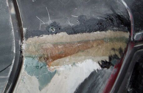

the roof section was boned in today and sloped to match the new roof line of the glass hatch here are the pics
the blue gray stuff is the bonding agent for SMC pannels and takes 3 to 6 hours to bond securly
so I will glass it in tomorrow once the bonding is fully cured

here is the roof section properly glassed back in
the best way to glass SMC is to ruff the surface with a wire wheel so as to get deap gouges for the glass to bond to as in the pics
now lay the glass in onl as needed to fill the area that is preped as glass wont stick well to a smooth surface
when sanded there is very little filler needed to smooth the area in as seen here
[This message has been edited by bubbajoexxx (edited 11-07-2004).]
