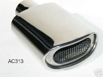

I think the only thing we haven't found yet are the exhaust tips that are going to fit in our rear bumper openings & make the right statement about the car.
Archie
Maybe something like this?
Not sure the size of the opening in the rear bumper, but these are 5.75" wide by 3" tall. Looks like it would be a good fit.
