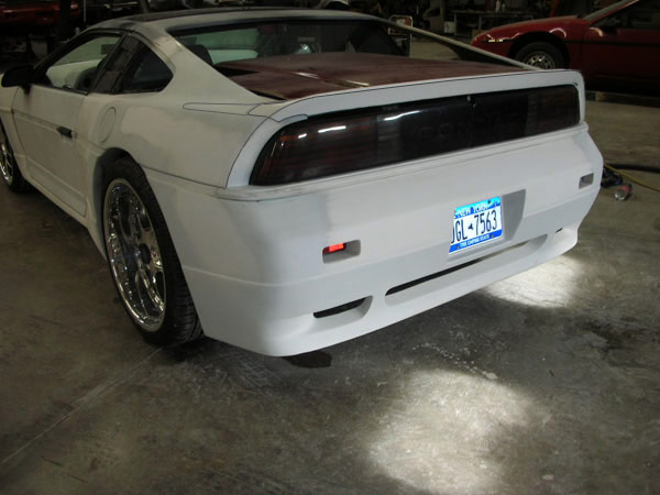

A few updates.
As many know we are working on a new decklid for the Perfect Union. We decided to build a new decklid rather than reworking the old one. Troy obtained a new louvered section to cover the engine area like we had done on the other decklid. You may recall the first one we installed was real thin & we had to do a bunch of glass work to thicken it up & get the warps out. He got this one from another supplier & it was plenty thick but it was warped quite a bit.
We tried heat & "C" clamps to try to straighten it out but the glass was just too thick & it had "memory" so we had to thin the fiberglass in certain areas to get it to fles enough to conform to the decklid. After we get it to lay flat & get it glassed in we'll build up the areas where we ground & sanded it thinner.
Archie
Posts: 9436
From: Las Vegas, NV
Registered: Dec 1999
Total ratings: 547
Report this Post02-02-2007 01:43 PM Click Here to See the Profile for ArchieClick Here to visit Archie's HomePageSend a Private Message to ArchieEdit/Delete MessageReply w/QuoteDirect Link to This Post
Archie
9436 posts
Member since Dec 1999
Here we are glassing the vent in & fitting the wing & glassing it in.
Here we have it on the car & are beginning to work on the wing ends because the wing has to be made wider for this body & the ends have to blemd down into the existinf body lines.........
More later

Well, there is still fiberglass hanging on it but I think it's lookin' good.
Archie
troyboy
Posts: 2075
Registered: Sep 2005
Total ratings: 154
Report this Post02-06-2007 10:15 PM Click Here to See the Profile for troyboySend a Private Message to troyboyEdit/Delete MessageReply w/QuoteDirect Link to This Post
Looks good Archie!

Report this Post02-07-2007 01:14 AM Click Here to See the Profile for XzotikGTClick Here to visit XzotikGT's HomePageSend a Private Message to XzotikGTEdit/Delete MessageReply w/QuoteDirect Link to This Post
Oh, I am sick!!! That has to be the best spoiler EVER on a Fiero.
