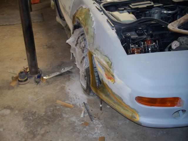

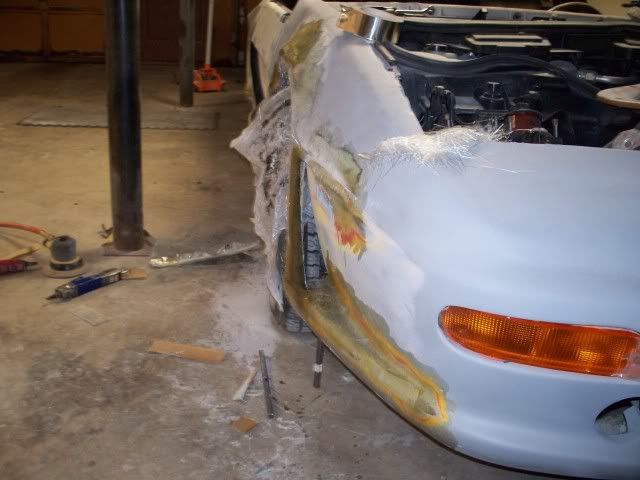

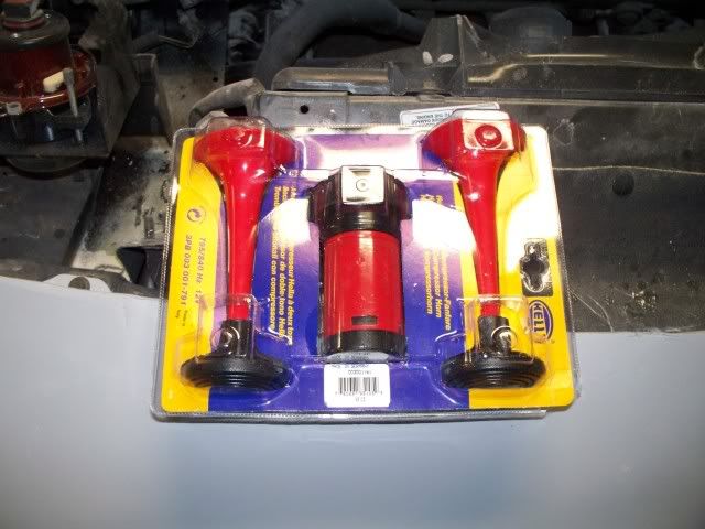

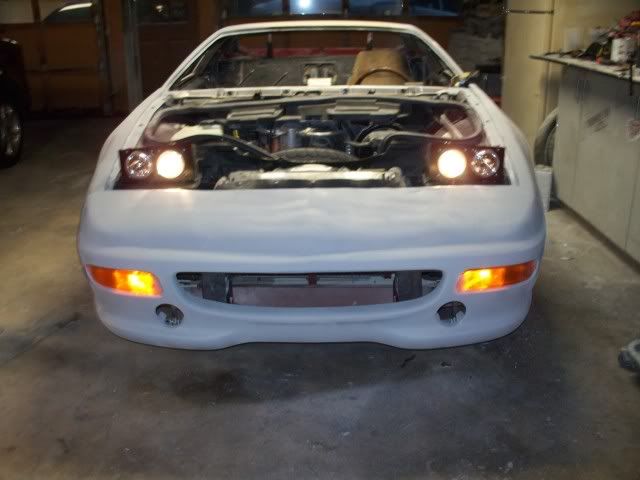

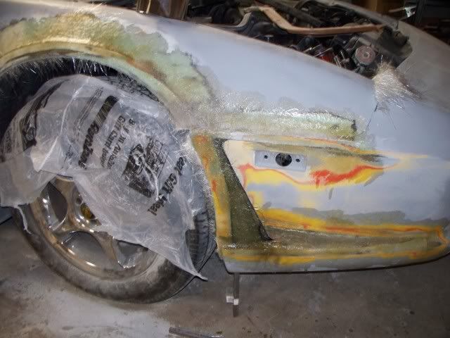

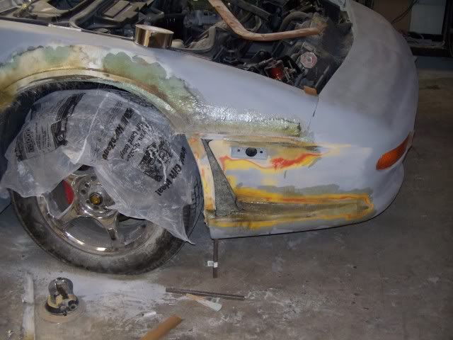

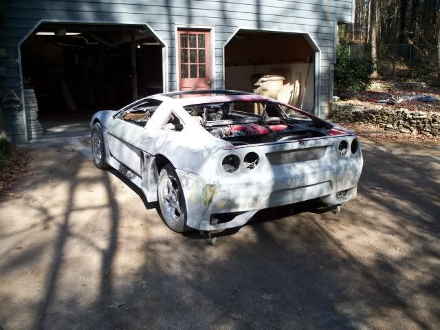

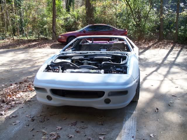

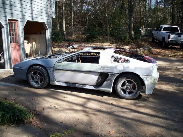

monday morning update.....
I did not feel like doing any body work this last weekend so I worked on other parts of the car.
I was able to finnish the mirrors so I can take them to my friend so he can pull a mold off them and make me a set out of fiberglass so I can work with them as far as
fitting them on the car and monting them. I also installed A new Hela air horn set on the car that give the car that Euro sound I wanted. I went to work on the wireing for
the lights. I made the harness for the headlights and installed them also wired up the front turn signals as well as the tail lights.
I have the inner tail lights wired up but the outer ones are giving me fits! if anyone can help I would love to get them done.
after about 2 hrs of fighting with the tail lights I gave up and went to fitting the inside pannels to the chop top. I had to cut some of them to fit but I will say a heat gun will do alot as far as re shaping some of the plastic. I plan to recover all the trim when I do the interior.
I did pull the car out side so I could do a little clean up and I got some pics that show the whole car.
as I was typeing this my wheels showed up a day early! OMG they look great I can't wait to get them home and test fit them.
here are some pic's.

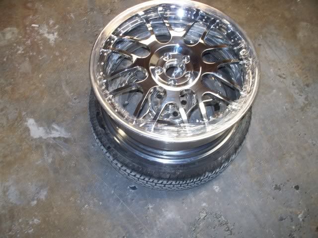

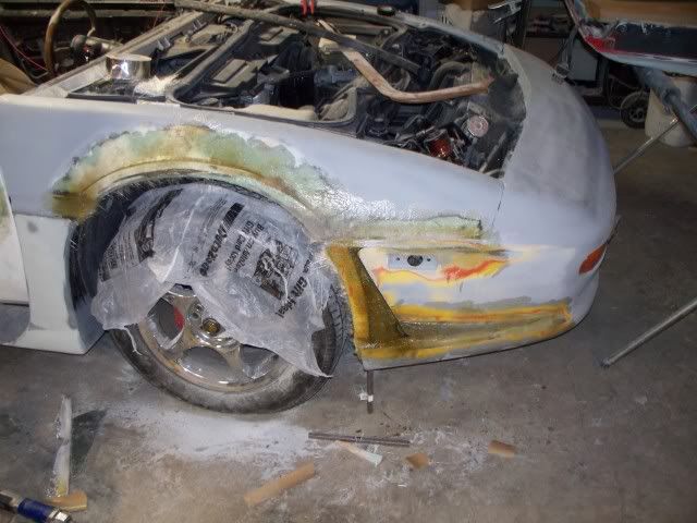

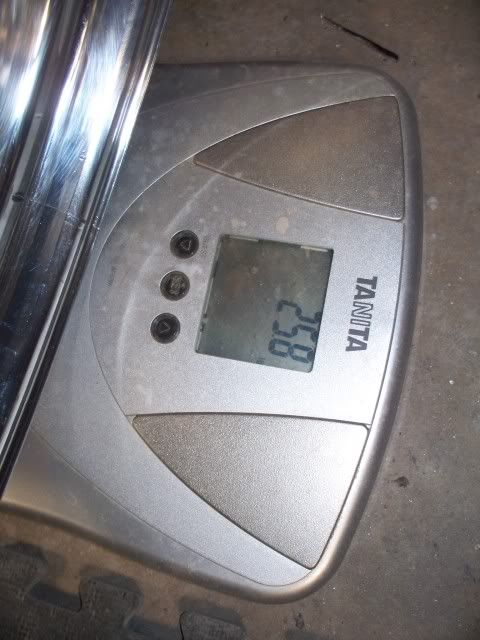

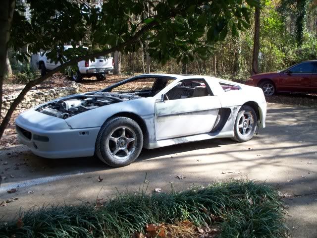

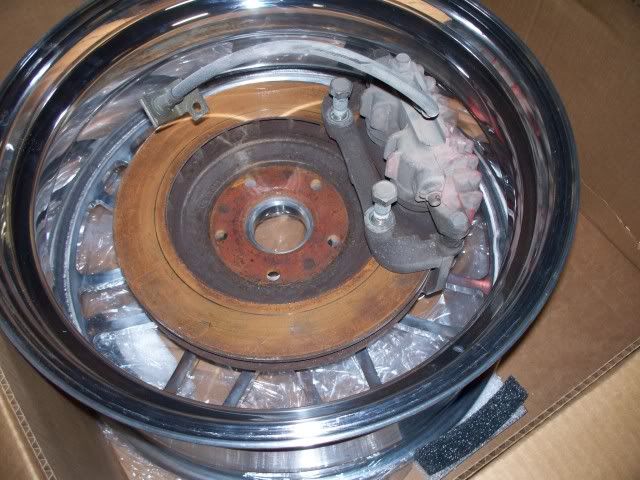

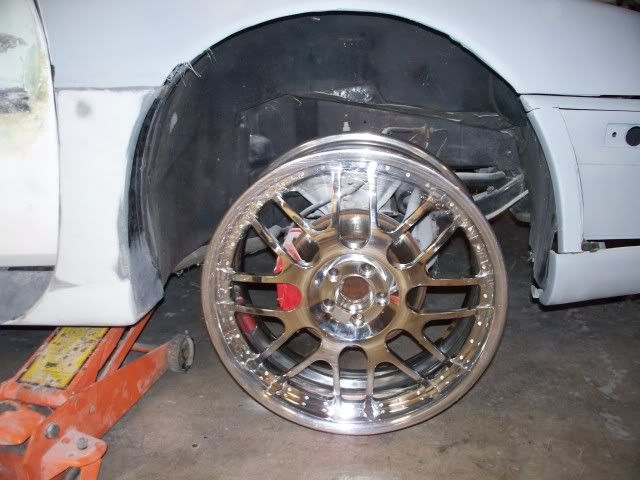

ok here is the update you have all been waiting for. last night I test fit the wheels and they fit exactly the way I wanted them to I could not be happier witht the fit.
even with the delays I would highly recomend BonSpeed to any one.
here are some pic's and info from last night.

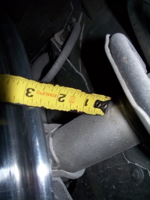

first off I took measurements on the clearance to the strut on the rear.
here are some pic's of the wheels on the car.
Rear
Front
the back of the wheel. also notice BonSpeed does what they call a hidden valve stem it is on the back lip of the wheel you can see the hole.
there is no problem with clearance but what I am using are the removeable stems. or flushmount as they call them.
this shot was just to see how much bigger the wheels were.
when I ordered the wheels they had asked me what brakes I was going to use so they could make sure they had enough clearance.
I had told them 13"Willwoods and later decided on Corvette brakes instead I called them and they were not sure if they would clear
so I told them to just build them for the Willwoods well last night I test fit the Corvette setup and they have more than enough clearance to the spokes 5/8" to be exact.
Just FYI.
Weight of the front wheel. if you can't see it 25.8lbs.
and the rear was 27.8lbs.
I knew they were lite but I was guessing 30+lbs.
all in all I am very happy with them.
as far as where they set on the body of the car the front set almost exactly flush and the rear set about 1/2" inside the top of the fender.
that is exactly what I wanted them to be.
as far as what I ordered here are the details.
my car 88GT
hole pattern 5 x 100, back space 38mm., front 19 x 8.5 and rear 20 x 10
I hope this info helps others with there choices for wheels.

Looking great! Any shots from behind?

no I did not take any because with the suspension hanging it would not show how they line up with the body.
I will get some when I get the tires on. but I will be out of town for the next few weekends and I don't know when I will get the chance to get the tires mounted.

Dean these wheels really put your car over the top as far as looking great,... now it is simply outstanding.

Simply beautiful.....
Using the 285/30/20 are 26.8" just shy of the dreaded 27.0". You will rub during dips in the road using stock springs (comfort springs, but hey they ride the best. I have stock on #015 )
Make sure the company that is mounting the tires uses or has soft plastic clamps during mounting phase. Otherwise, it might be prudent to use plastic lip protectors. They may have some at the shop so don't forget to ask (I have a pic some where).
Oh yeah, where's the center cap? Does the cap have a custom company logo etched into the center or did you go custom? I know so many question regarding wheels, but this is what choptop owners do, hehe.

Also I notice the tweaking has started on the front side nose for additional flaring... sweet! That should give the front end a meaner stance.

last night I was able to work on the front end of the car. since I have my wheels now I was able to figure out how much wider to make the front.
I am doing this because I did not like how the front curved under so much and showed so much tire.
so this is what I came up with rather than trying to figure out how to just widen the bottom I decided to add a scoop to the sides this will change the look of the 355 front and also give it the look I wanted from the front. a wider more agressive look.
I also cut the fender top lip and moved it out about 1/2" now the top is straght up and down and it covers the wheel the way I want it to.
keep in mind that it is no where near done yet but here are som pic's from last night.

Dude your little scoop matches the bigger one on the side. LOL. Whodeanie you do awesome work. That and in your own garage. I can't wait to see this one finished.

I am doing this because I did not like how the front curved under so much and showed so much tire. I decided to add a scoop to the sides this will change the look of the 355 front and also give it the look I wanted from the front. a wider more agressive look.
IMO your doing the modifications because;
1. It looks better than the F355.
2. It matches the Mad-Arch kit, and
3. This makes your own tweaking "Bad to the bone."
4. If I may add, if you use the Corvette C6 side marker lamps you'd have a far better look vs. the F355 side marker lamps thus adding to a truly custom ride. You've gone this far so there is no need to stop now.
As a rule, "you never bolt on parts without tweaking it." Be a leader, never a follower, and don't live in the past.
