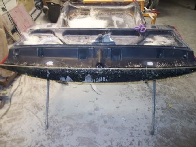

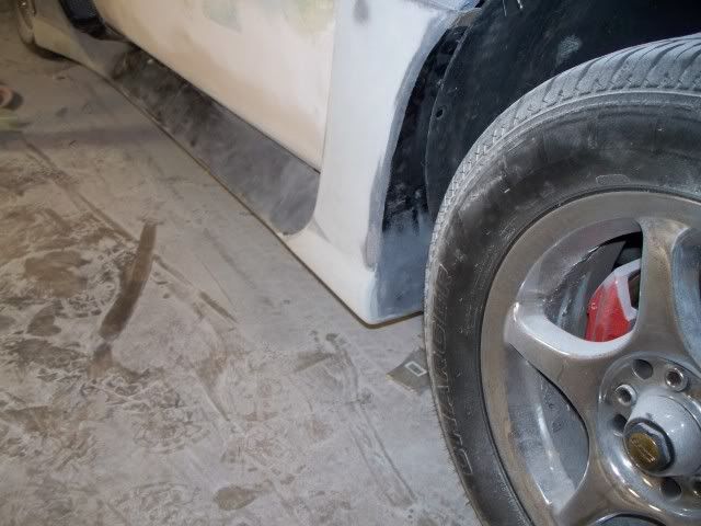

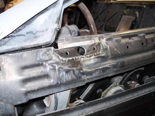

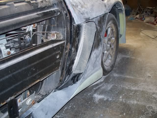

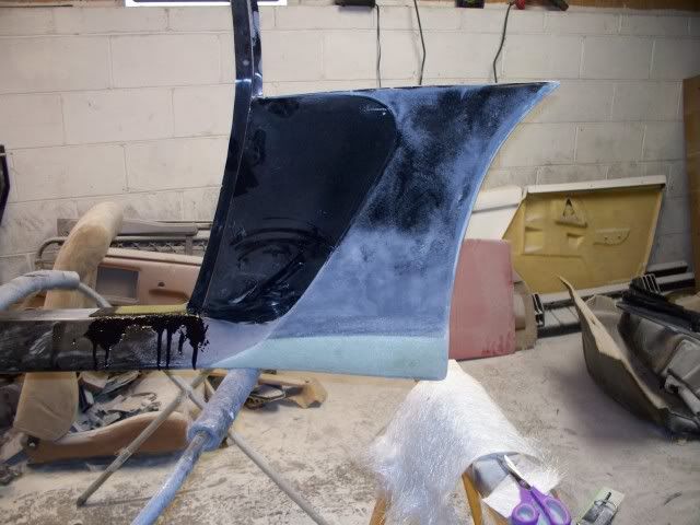

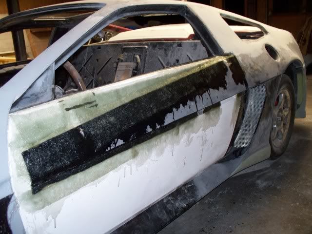

whodeanie
3819 posts
Member since Jan 2008

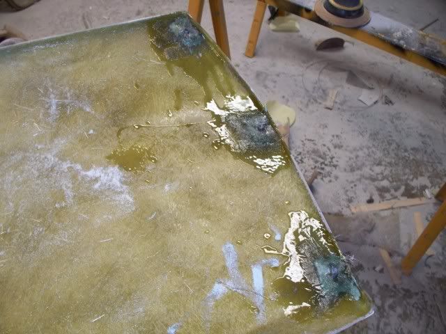

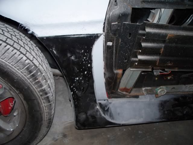

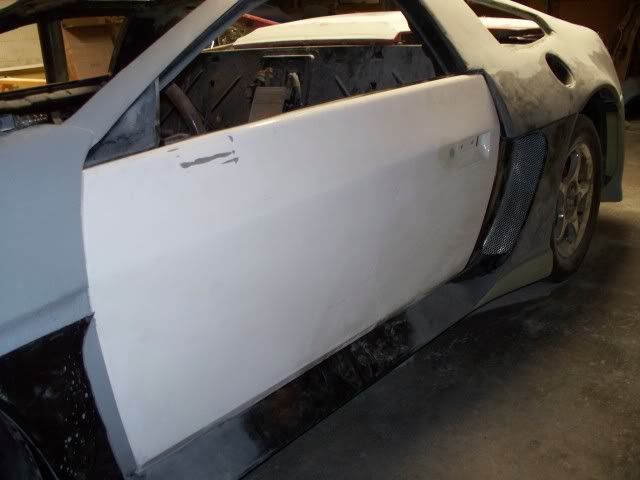

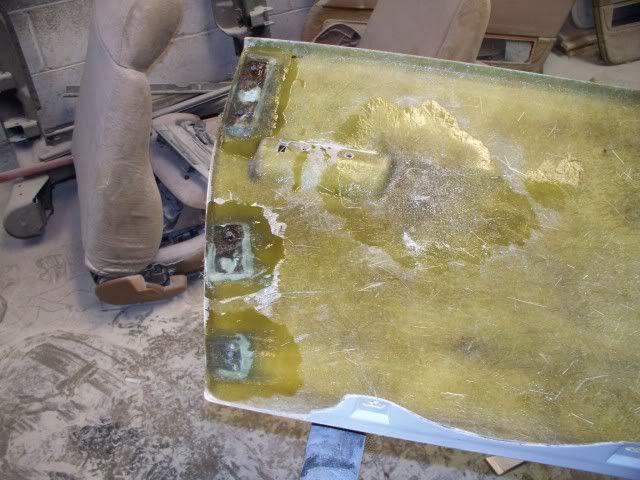

Last night I finally got around to working on the drivers door.
I got the old door skin off and mounted the tabs on the new fiberglass skin. while I waited for that to dry I reworked the door a little with the new door skins they have the mirror hole glassed over so it hits the original mirror mount so what I have done is cut the mount around the bottom and part way up the sides then hammered them flat to the rest of the door and re welded them back in there new location so they will no longer interfere with the new door skin. I then worked on the rocker and got it in to place so I could tweak the front of that side. I have not started it yet I ran out of time. I was able to get the new door skin mounted and lined up before I quit last night.
here are a few pic's from last night.
2 pic's mounting the door tabs to the new skin
A pic to show what I had to do to the door for the new skin to fit
2 pic's of the rocker installed
and last but not least the new door skin mounted on the car
on a side note.... the easiest way to get the tabs to line up on the door is to place the new skin on the door place 2 plastic rivets in the bottom and tape the top in place then close the door to align it then reopen it and take a marker and mark the holes. then pull the door skin off and mount your tabs.
the tab has a nut hole that goes all the way threw so you can see the marks you made and center them.
just a heads up for anyone wanting to do the same.
[This message has been edited by whodeanie (edited 11-04-2008).]

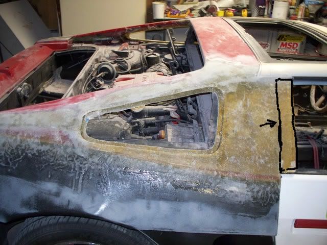

I have looked at this and I think I like this one the best.
if I just paint it black to the back of the door. and color match the rest it will size down the B piller look and not just look like the stock fiero glass.
I will be working on the car this weekend and I hope also a bit this week after work as well.
I will post pic's as soon as I get some more done.

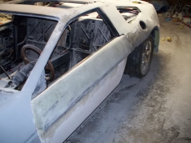

Report this Post11-06-2008 09:48 AM Click Here to See the Profile for whodeanieClick Here to visit whodeanie's HomePageSend a Private Message to whodeanieEdit/Delete MessageReply w/QuoteDirect Link to This Post

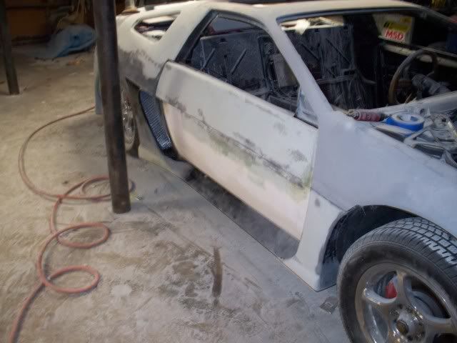

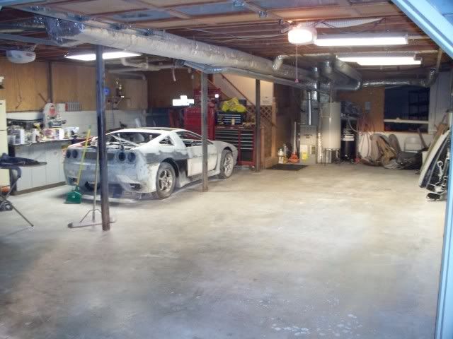

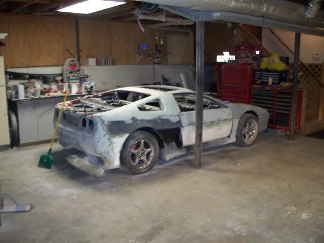

Just a little update.
last night I worked on the drivers door a little more. I got the wide body piece glassed on that makes the last piece of the wide body to be installed.
now it is a matter of fitting it all and a few more tweaks to other body parts. I will wait for the wheels before I do a few of them. it will still be some time before I can get it to paint.
on other parts I talked to Archie yesterday and the VDI hinges are well under way and should be ready for shipping next week. next big tweak Lambo hinges!
I am going to call BonSpeed today and try to get a ship date from them on the wheels.
I have this weekend off so I am going to try to get a lot done on the car and try to get it in to primer.
here is a pic from last night.

Report this Post11-10-2008 11:07 AM Click Here to See the Profile for whodeanieClick Here to visit whodeanie's HomePageSend a Private Message to whodeanieEdit/Delete MessageReply w/QuoteDirect Link to This Post

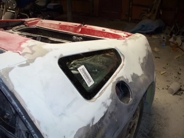

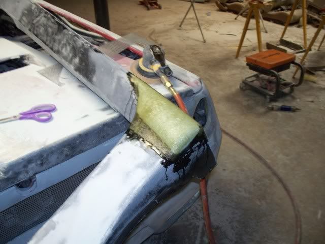

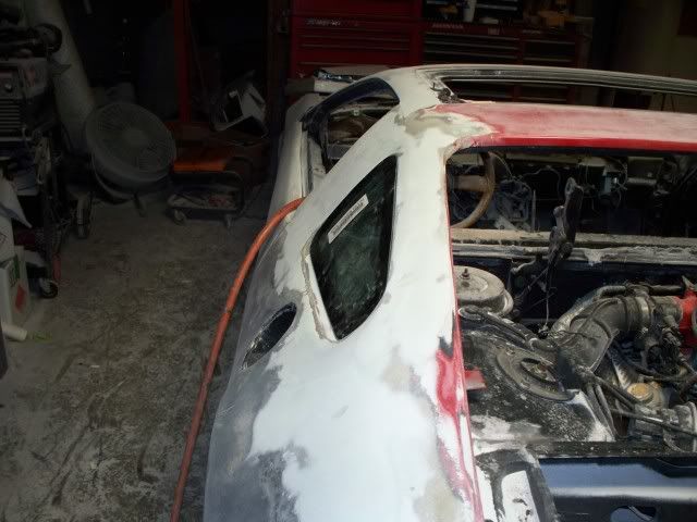

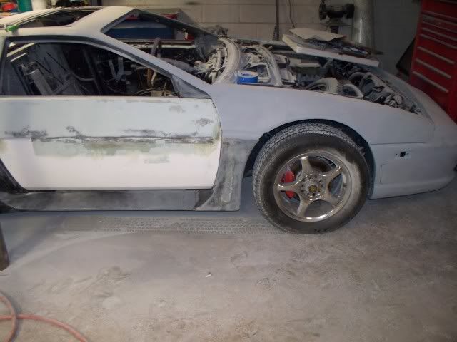

I was able to work on the car this weekend but not as much as I wanted to.
body work takes forever. I worked on the rockers to get them finished I widened the drivers side and did all the bottom body lines to match the front
and installed the screen on the passenger side. I also worked on the drivers door, the rear deck lid, the rear quarter windows, and a little on the rear fascia.
it is kind of a slow go and it does not look like much progress but a lot has been done. on the rear deck lid I glassed in the rear of the spoiler and made the screen for the hood scoop.
I wanted to get more done but it is just me working on it. so I will just keep plugging along and posting pic's as I go.
here are some pic's from this weekend.
hopefully next week I will have VDI hinges and wheels to post.
enjoy.

Report this Post11-11-2008 08:15 AM Click Here to See the Profile for whodeanieClick Here to visit whodeanie's HomePageSend a Private Message to whodeanieEdit/Delete MessageReply w/QuoteDirect Link to This Post
whodeanie
3819 posts
last night I spent a little time cleaning up my pig pen. I hate getting covered in dust and not finding things.
so a little cleanup was in order.
I was able to get a better pic of the car.
