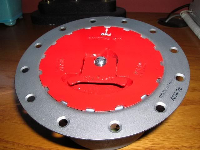

look what my UPS person delivered today!
it is going to look great on the car
thanks, Ferrobi
ferrobi
Posts: 650
Registered: Jan 2005
Report this Post06-10-2009 02:10 PM Click Here to See the Profile for ferrobiSend a Private Message to ferrobiEdit/Delete MessageReply w/QuoteDirect Link to This Post
Your welcome - be careful when you shut the turn lock. Line it up so that when you close it it does not hit the recessed area side walls that it goes in to and scratch off the paint.

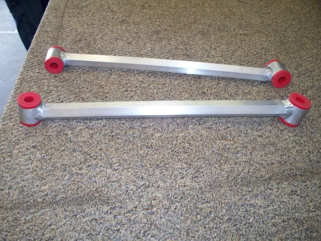

Report this Post06-11-2009 12:31 PM Click Here to See the Profile for whodeanieClick Here to visit whodeanie's HomePageSend a Private Message to whodeanieEdit/Delete MessageReply w/QuoteDirect Link to This Post

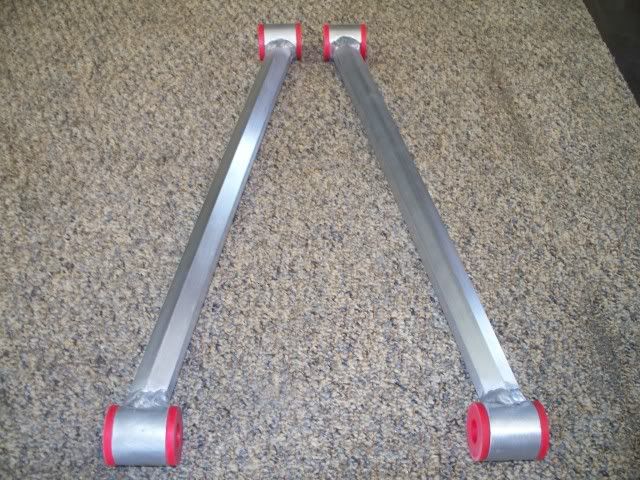

whodeanie
3819 posts
Member since Jan 2008
I finaly got these done. it was not easy or cheep but they are strong
if anyone is interested in them contact Erik at HT they will be about 2x the cost of the steel ones but no broken Heim joints with this arm.
D.
I made these, they were not bought. it would have been cheeper to buy and a lot less of a pian in the butt. the angles were not easy.
now I have a jig

Report this Post06-11-2009 05:22 PM Click Here to See the Profile for ClayTontoSend a Private Message to ClayTontoEdit/Delete MessageReply w/QuoteDirect Link to This Post
Sweet Those should be good for about 700 HP

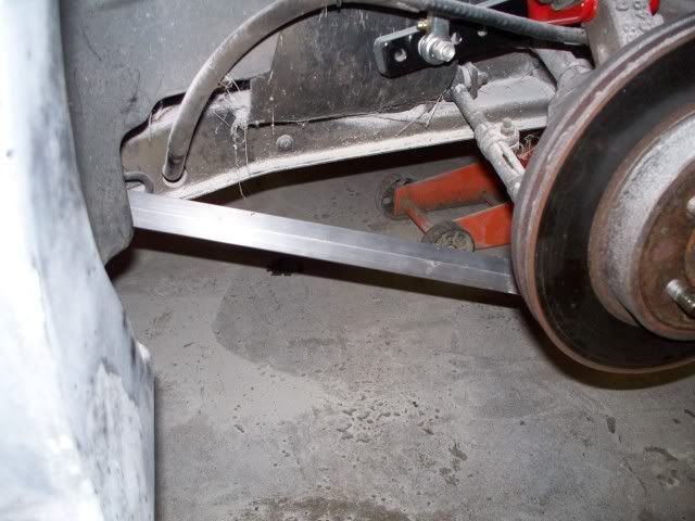

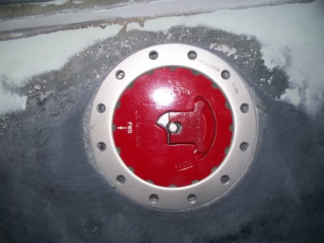

Report this Post06-12-2009 09:04 AM Click Here to See the Profile for whodeanieClick Here to visit whodeanie's HomePageSend a Private Message to whodeanieEdit/Delete MessageReply w/QuoteDirect Link to This Post

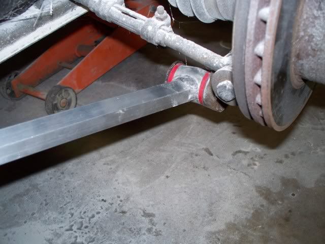

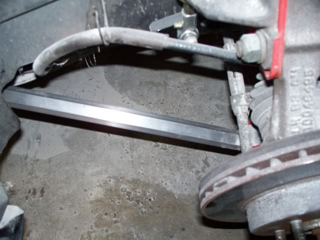

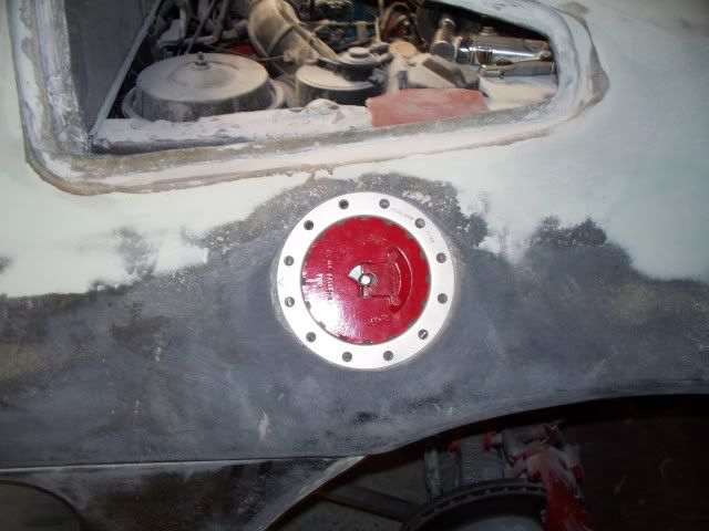

last night I worked on the car I was able to install the link bars and I cut the hole and fitted the F16 fuel cap to the wide body as well.
the fuel cap will need some more work to get it installed the rest of the way. I will have to make a reducer to fit the fill pipe but it should not be that big of a deal.
I was also able to order the first group of parts from Archie for the LS3 / F40 swap so I can get my other cradle built and sent off for powdercoating.
here are the pic's from last night.
D.
exoticse
Posts: 8656
From: Orlando, Fl
Total ratings: 106
Report this Post06-12-2009 09:37 PM Click Here to See the Profile for exoticseSend a Private Message to exoticseEdit/Delete MessageReply w/QuoteDirect Link to This Post
Dean,
I am loving that fuel door !!
Sweeeet !
I have been looking at some Audi TT ones !
ferrobi
Posts: 650
Report this Post06-12-2009 09:48 PM Click Here to See the Profile for ferrobiSend a Private Message to ferrobiEdit/Delete MessageReply w/QuoteDirect Link to This Post
Looking good - I will install 2 on my F40 one for looks and one functioning. Good thing I bought some extra's.

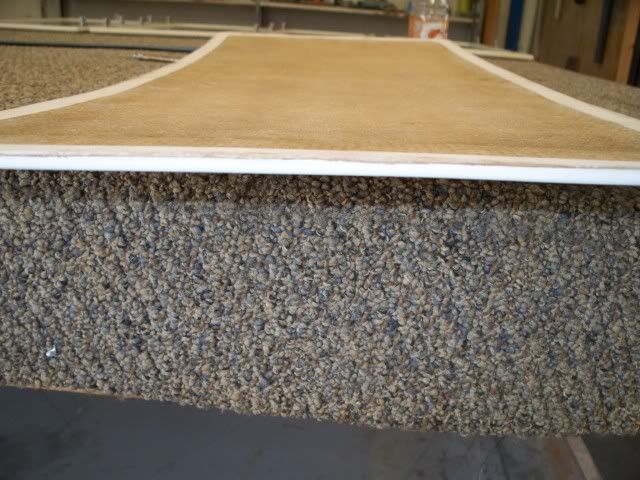

Report this Post06-15-2009 09:00 AM Click Here to See the Profile for whodeanieClick Here to visit whodeanie's HomePageSend a Private Message to whodeanieEdit/Delete MessageReply w/QuoteDirect Link to This Post

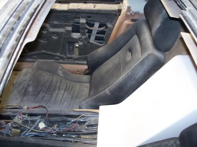

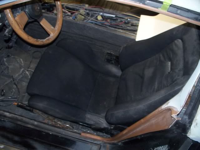

I got a little chance to work on my car last night so i played with the seats to get them installed.
After working on the 355 installing the seats in it I had a better idea of what I needed to do on mine. even though my seats are also Recaro's
they will be mounted way differant because of the choptop I want them as low as I can get them.
I was able to mount the slide tracks to the seat and fitted the seat in the car. After a few quality minutes with the air hammer I was able to get them installed.
I have some head room now with my butt on the floor
here are some pic's
lots of parts on order for the car to get it farther along.
ie.. Ameda's center console, part 1 of Archies LS3/ F40 swap, glass windows, Riceburners AC unit amoung a few other things
D.

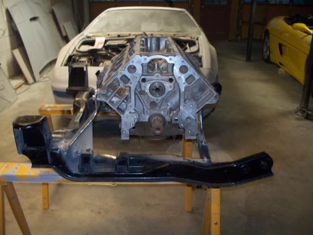

Report this Post06-20-2009 11:49 PM Click Here to See the Profile for whodeanieClick Here to visit whodeanie's HomePageSend a Private Message to whodeanieEdit/Delete MessageReply w/QuoteDirect Link to This Post

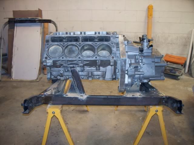

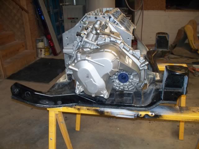

I am working on my cradle for the LS3/F40 swap this weekend. I got the first part of the kit from Archie this week.
so cutting and welding I go I got the parts at my shop and brought them home and forgot the instructions so tomarow I will go get them.
I was able to find enough pic's of the cradle here to get it started today. I will get some pic's this weekend and post them on monday. the plan is to get the cradle done so I can send it out for powdercoating but first I will install the V8 mounts and weld up all of the holes that are not needed as well as finish all the factory welds.
then off to be soda blasted and one last look over to make sure I did not miss anything.
D.

Report this Post06-22-2009 08:14 AM Click Here to See the Profile for whodeanieClick Here to visit whodeanie's HomePageSend a Private Message to whodeanieEdit/Delete MessageReply w/QuoteDirect Link to This Post
Here are the pic's from this weekend.
I got the cradle done and reinstalled the motor and trans to make sure nothing moved and it all went well.
now I will pull the motor and have the cradle soda blasted after that i will look it over and take care of anything it needs then off to powdercoating.
Thanks, Archie
D.

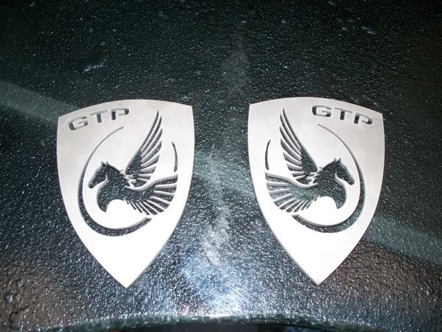

Oh Deanine, I got goodies for you!
I shipped your badges today. I cut them out of .030 stainless, thicker just didn't look right but I can cut them agin if you want them thicker. You should have them on Wed. They ended up being 3.965" tall by 3" wide
Lemme know if you want any "tweeking" done on them.

Will, they look great!!!!!!!!!!!!!!!
I think they will work out just fine
just incase anyone wants to know what the GTP is I did that for GT Prototype
D.

You know the more I looked at them the more I thought they might be sweet if I re-cut them from mild steel and you have them plated in "black chrome" Against the green of your car they would really pop!

I hope Dean will forgive me hijacking his thread for a second......When I designed these badges Dean and I decided to go away from the traditional (stuffy) badge and do the "modern version" of what the Fiero logo might look like today. I don't really care for the "contained in a box" look but the logo alone looked kind of bare. Dean then came up with the Ferrari-ish badge idea and I worked them together.
This is the original concept (when I drew it it looked more like a Great Dane than Pegasus)
This is the refined head shape but the feathers needed some evening out
This one added a badge shape, kind of Ferrari minus the pointed top
This is the final logo without the shield. What I had envisioned from the start, great for painted logo, not good for a badge because there in nothing to hold hold the parts together.
This is the final badge with the text repositioned for fill out the badge.
I cut them out on an Omax Water jet out of .030" stainless steel. I think they turned out pretty nice. Modern edge but homage to the heritage of the Fiero. "Proud"

Actually, I already have made just such a badge but I haven't had a chance to cut any of them out yet. I sent the art to Rob (Amida) and he gave me a great idea for both a fender badge and nose emblem:
Nose badge
Fender badge
I will have a few prototypes next week

Dean,
How many times have you changed that back facia??? You know how it is when we are perfectionist
Do you want a nose badge that matches the fender badge you have or like the one above? I will send you one next week

Try switching the feathered wings on the prancing pegasus to the modern graphic wings used on the previous badge.

You thinking like this?

NICE!
i can see a couple 3" or so emblems, one on my grill and one in the middle of my tail light panel now!
if you make these let me know, i have a guy that can chrome them for me.

and as I was typing this another Fed Ex driver showed up with the badges from Will. it is just like my birthday!
Will, I think they are thick enough.

Dean, I will run another set in mild steel if you want to have them chromed in Black Chrome as well.
