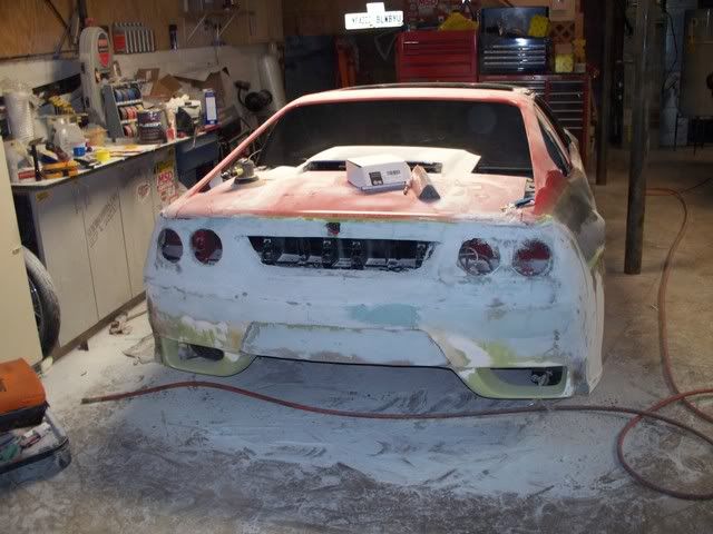

I was able to start some of the bondo work last night.
I am going to need more sanding disc's and bondo HAHA!
it is going to take some work to get it where I want it but it will look good when it is done.
I will keep you all posted.

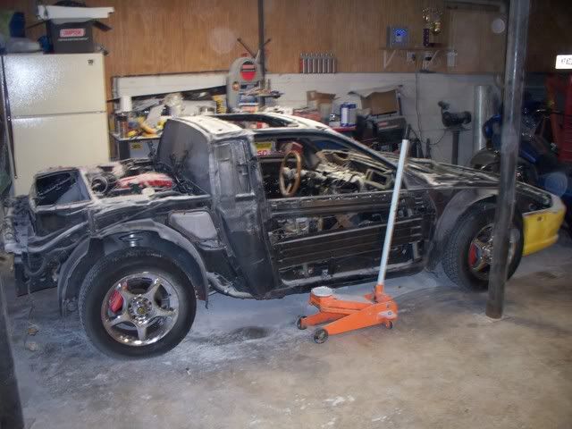

I had to work on saturday and sunday I had so many other things to get done I did not get much of a chance to work on the car till around 5pm on sunday
but I did get carnut the wheels off my car and thadriver came over and got some matt from me to make me a new hood vent and a set of fiberglass doors.

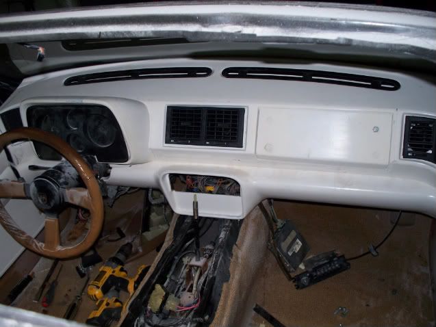

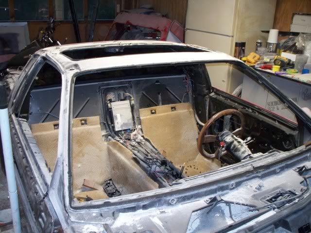

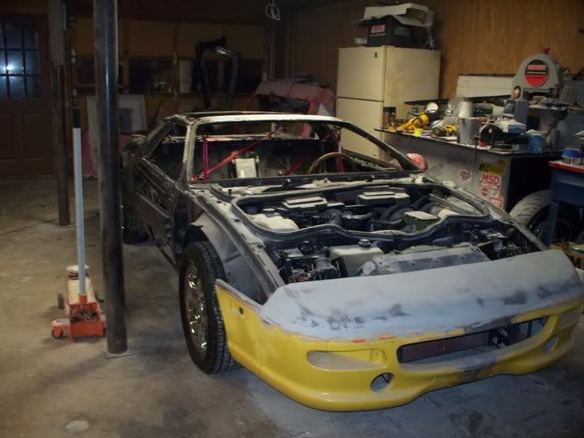

I was able to work on the car a little I cleaned out the inside and set the dash in place for test fitting I also got the vents and cut them in. my dash sits on the center hump
and talking to Ameada his console needs clearence so instead of modifing the console I am going to move the stereo pod up higher on the dash to give the console the clearance it needs but I will not be doing this for a while because I want to have the console before I do in to make sure I have enough room for it.
here are some pic's from sunday.

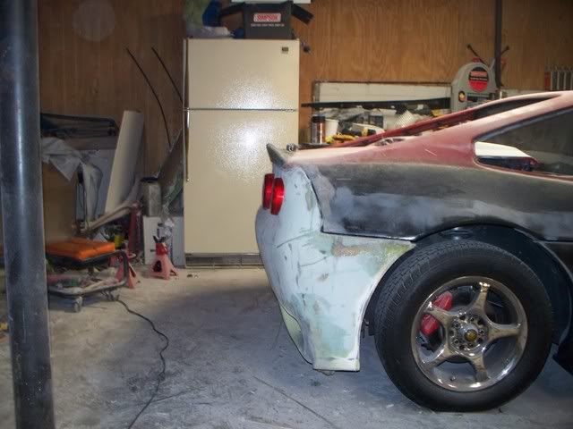

Report this Post09-12-2008 09:32 AM Click Here to See the Profile for whodeanieClick Here to visit whodeanie's HomePageSend a Private Message to whodeanieEdit/Delete MessageReply w/QuoteDirect Link to This Post

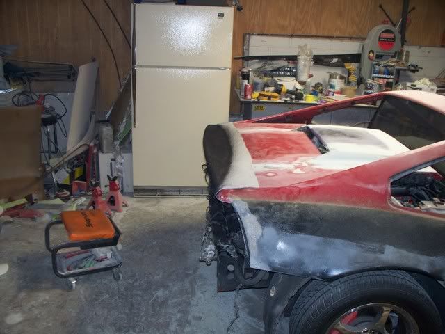

Just a little update.
last night was the first time I was able to do some work on the car in about a week. I did not have a lot of time but I was able to work on the rear facia a little.
more bodywork and sanding. I hope to have the rear finished by this weekend so I can get the car in primer soon. it is hard to see what needs work when the car looks like a patchwork quilt.
here is a picture of the rear as it is now it still has a very long way to go but it is starting to take shape.
I should be able to post more pic's on monday with I hope way more done.
[This message has been edited by whodeanie (edited 09-12-2008).]
madcurl
Posts: 21401
Total ratings: 314
Report this Post09-12-2008 12:51 PM Click Here to See the Profile for madcurlSend a Private Message to madcurlEdit/Delete MessageReply w/QuoteDirect Link to This Post
It's coming along nicely. I like the fact that you left an opening between the tail lamps. However, I wish you would resize your pics.

Ok here is the latest. I was able to work on it this weekend. I worked on the rear getting all the mounting points glassed in and worked on the tail lights to get them fitted.
I also was able to start my rear spoiler.
A friend and I took a little trip up to John Watsons place on sunday to get a rear bumper for his 355 and I got the inside piece for mounting the tail lights from him.
it saved me a lot of time on my car so when I got home I was able to work on that a little.
here are some pic's from this weekend

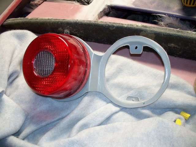

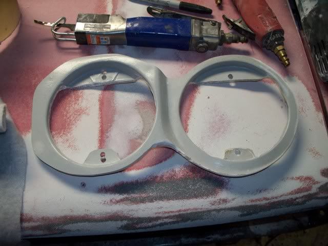

here is just a little update I went to the parts store yesterday to get the conectors for all of the lights to get them wired up.
also I have had some people Pm and ask here how I made the spoiler. Ok this is how I did it first I took a piece of plywood 1/4" so I could bend it then I made an arch with a string line then cut it out then I casned all the edges and rounded the top edge. then I placed it on the car to get it where I wanted it then screwed it to the decklid.
then spray the decklid and the wood with spray adhesive and cover it with matterial to hold the shape you want then you will need to spray paint the cover so the resign does not soak threw then just glass over it. when it is dry you can just pull it off the car so you remove the wood and then do the fitting and finish. it is not that hard to do and this is done like they do to make stereo boxes. I hope this helps!
anyway I have a few pictures to post these are of the tail light sub mounts and the windows Archie sent me.
I dont think the windows are tinted I think it is just the protective film on them but I am not sure I have not looked at them close yet.

the choptop will be starting soon last night I striped the car to get it ready. I just need to pull the back glass and the carpet so I can get started.
here are some pic's from last night. I will need to take lots of measurements first.
for those who wanted me to take lots of pictures of the chop in progress. I will post pic's but not detailed ones.

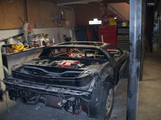

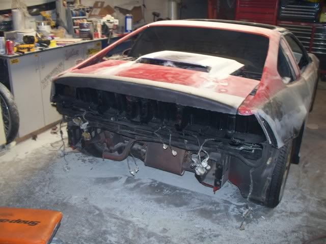

let's play a game! does anyone notice anything different?
last night I finished striping the car and got to choping.
it was easyer than I thought it would be. it took about 3 hrs. to get it choped I still need to do all the welding but for now it is just tacked in place.
all the measurements came out exact from the ones I was given and the windows will work great.
Thank you Archie!
