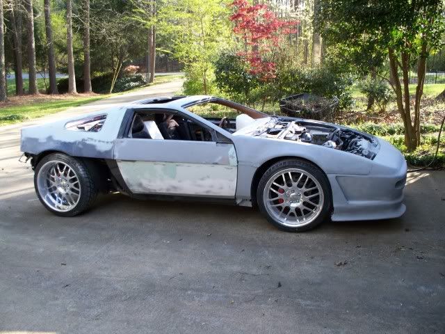

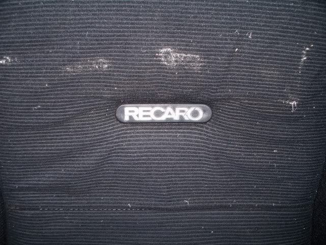

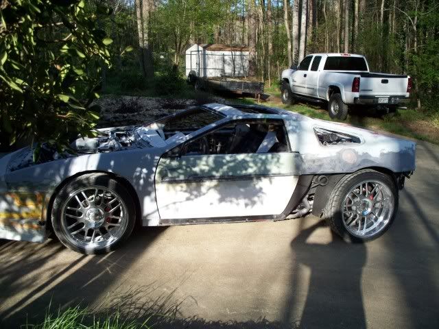

I did a bit more body work to the right side of the car. I want to get that side done then I will turn the car around so I can work on the other side.

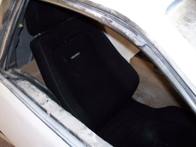

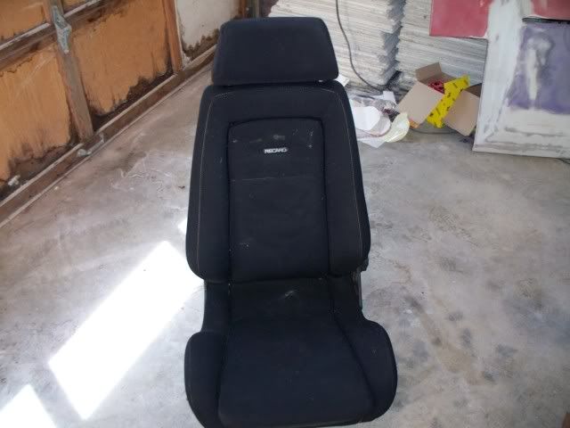

here are some pic's from yesterday. body work and my new seats and head liner.

A great improvement over the stock Fiero seats. Any clearance issues using these seats in a choptop (near the roof line?) I know with my Corvette seats, I can't fold the seat due to interference.
[This message has been edited by madcurl (edited 03-31-2009).]
whodeanie
Posts: 3819
From: woodstock,Ga.,USA
Registered: Jan 2008
Feedback score:    (14)
Total ratings: 120
Report this Post03-31-2009 10:25 AM Click Here to See the Profile for whodeanieClick Here to visit whodeanie's HomePageSend a Private Message to whodeanieEdit/Delete MessageReply w/QuoteDirect Link to This Post
No, I test fit the passanger side and it clears just fine it is the same size as the stock Fiero seats but it sits a little lower
in the car. I will have to make custom mounts for them because if I use the stock Fiero slides I would have to shim the seat up
to make the slides work. I am going to get a set of slides from Summit and tweak them to fit so I can keep the seat as low as I can.

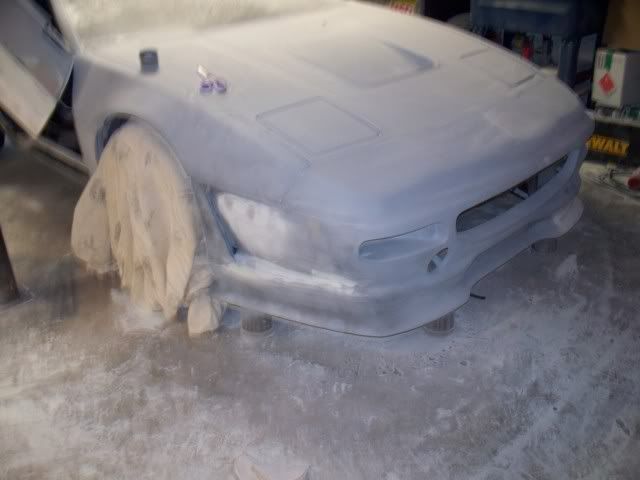

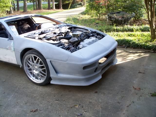

Dean the chin spoiler came out really well.
Good job.

Report this Post04-01-2009 11:12 AM Click Here to See the Profile for whodeanieClick Here to visit whodeanie's HomePageSend a Private Message to whodeanieEdit/Delete MessageReply w/QuoteDirect Link to This Post
Good job.
thanks, but you are only seeing one side, it still has a long way to go but it will get there.
at this moment I am just trying to get the right side done so I can turn the car around to get to the drivers side better.
I got the back glass back from temper and I am going to install it this weekend. when I do I will pull off the top of the car and paint the chassis
as well as finish the underside of the body so that when it all goes back together it will be for the last time.
my plan is to jamb out the car and paint the under side of the body so I can do the outside of the car without taking it appart again.

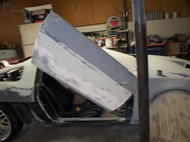

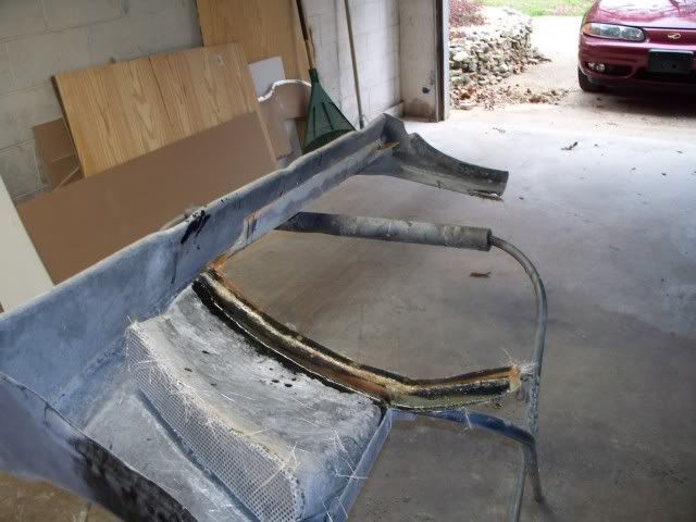

I just noticed in this pic. Are you modifing the rocker panel frt part of the rear section. Looks like fresh fiberglass work. The chin spoiler you made looks awesome.
yea I reworked it and the sill a little to get it to fit a little tighter.

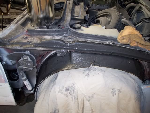

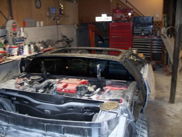

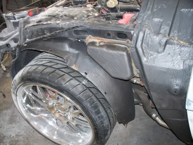

last night I worked on the car for a while. I took the body off so I could install the back glass and while I have it off I also did some sound dead paint on the outside chassis
as well as the wheel wells to cut down road noise.
since the body is off I am going to finish the underside of each part before I put them back on the car.

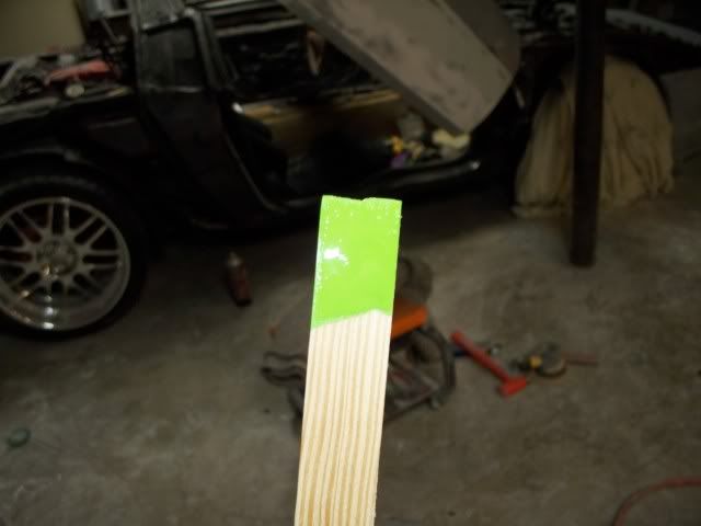

yesterday the painter gave me a sample of the lambo paint I am using for the car and I tried to get a pic of it but it is a little hard to do on a paint stick.
one steep back to take 3 forward? I hope!

Yesterday the painter gave me a sample of the lambo paint. I am using for the car and I tried to get a pic of it but it is a little hard to do on a paint stick.
Hmm.. does it look like this, hehe.
Last night I worked on the car for a while. I took the body off so I could install the back glass and while I have it off I also did some sound dead paint on the outside chassis
Question; how did you remove the rear clip? Did you remove the rear clip by yourself or did you have help/hoist device? I need to remove #015 rear clip and I'd like to do my work w/o aid for the neighbors (too noisy).

Report this Post04-02-2009 08:56 PM Click Here to See the Profile for whodeanieClick Here to visit whodeanie's HomePageSend a Private Message to whodeanieEdit/Delete MessageReply w/QuoteDirect Link to This Post
Curly, the back is a little awkward by myself but not heavy at all.
I have never had any help with my car yet.
it is more of a balance from one side to get it tilted back to where you can grab it from the back.
YOU CAN DOOO IT!

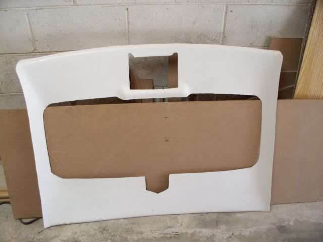

Tonight I worked on the car for a little while I was able to get the fastback section finished and painted on the underside.
I just did it in black to seal it.
I also worked on my new fiberglass headliner because of the choptop I had to section a little out of it and glass it back together. I know I can't leave anything
stock
I also worked on the underside of the hood to start soothing it out.

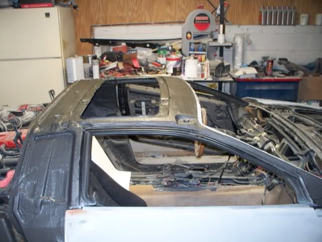

I had to work saturday so sunday after I finished some yard work I was able to get back to work on the car.
I am trying to not get burned out on body work so I do a little of that and I spent most of the time yesterday working on fitting the interior
panels making brackets for the dash and fitting the headliner. because of the chop top I have to modify the trim and it is a lot of work just to do that.
I have to finish the B piller piece for the drivers side as well as fit the door panel. with that I will still have a few things to do inside but it is going well

Last night I cleaned up the garage, it was getting bad I could not find anything and just walking threw it was an adventure.
I found all my tools and moved the car to the other side so I could work on the drivers side of the car now.
here are some pic's of the car outside
the seats are just sitting in the car so I could move it
someone wanted pics of the front of the car so here you go.
it still has a long way to go yet.
D.

War Hammer
Posts: 377
From: Myrtle Beach, SC USA
Report this Post04-09-2009 04:06 PM Click Here to See the Profile for War HammerSend a Private Message to War HammerEdit/Delete MessageReply w/QuoteDirect Link to This Post
Kind of reminds me of a DeLorean meets Lotus Esprit from the side.
Paul
Paul
I agree a little more Lotus than DeLorean only because if it was a DeLorean I would not have hade to clean up all the white powder on my floor yesterday
it would have done it for me

What kind of car and year did those Recaro seats come out from because they are sweet?
Dave

Report this Post04-09-2009 11:53 PM Click Here to See the Profile for Black PegasusSend a Private Message to Black PegasusEdit/Delete MessageReply w/QuoteDirect Link to This Post
Thanks whodeanie for the pictures! Your front bumper looks awsome! It certainly gives me some ideas for my front bumper! :P
Keep on the great work!
Fred

madcurl
Posts: 21401
Total ratings: 314
Report this Post04-10-2009 03:38 AM Click Here to See the Profile for madcurlSend a Private Message to madcurlEdit/Delete MessageReply w/QuoteDirect Link to This Post
D.
If I may speak from a "critique" point of view; IMHO I think the original bulging lower body line (the line right below the fog lamps going east to west) needs to be removed. IMO it's competing with the newer body line (in other words you now have two chins). The bulging bump was intended to highlight and a point to where the F355 nose ended (granted I could be wrong and you might want to review a few pics of a Ferarri race car using some type of add-on to the fascia).
Either way, if you cut and remove the lower add-on spoiler and move the part upward and closer to the bulging line it might blend-in better and thus allowing for a continued flow to the side rocker and rear bumper. Thus by doing this, the extra (centered) lower vent opening in voided, but you could add the intended curve in this area (similar to Car-Lo's).
That said, what the heck I know. It's freaking 3am!
[This message has been edited by madcurl (edited 04-10-2009).]
whodeanie
Posts: 3819
Total ratings: 120
Report this Post04-11-2009 11:15 AM Click Here to See the Profile for whodeanieClick Here to visit whodeanie's HomePageSend a Private Message to whodeanieEdit/Delete MessageReply w/QuoteDirect Link to This Post
Curly, I know what you are talking about on the front but I am not done yet. I want to keep the spoiler where it is but with a few more tweaks.
the spoiler is going to be a bolt on part not part of the nose it just looks like it is at this point because I needed to get the shaping done before I can take it off and finish it. also I am going to paint it Black instead of green for 2 reasons one to breakup the front bulk and for the other it sits low enough that I know it will get chips and things so I want to be able to repair it without having to match the green everytime. with the contrast I think it will look fine and not look like 2 chins.
it still is a work in progress and you never know I might change my mind later but for now that is the plan. thanks for the feedback as always
I am going to work on the car this weekend so I will post some new pic's monday of what I did to it.
Daredevil, I bought the seats in Daytona at the swapmeet so I am not sure what car they came out of but if I had to guess I would say a Mustang by the other parts he was selling.
all Ford Mustang parts from the late 80's
D.
