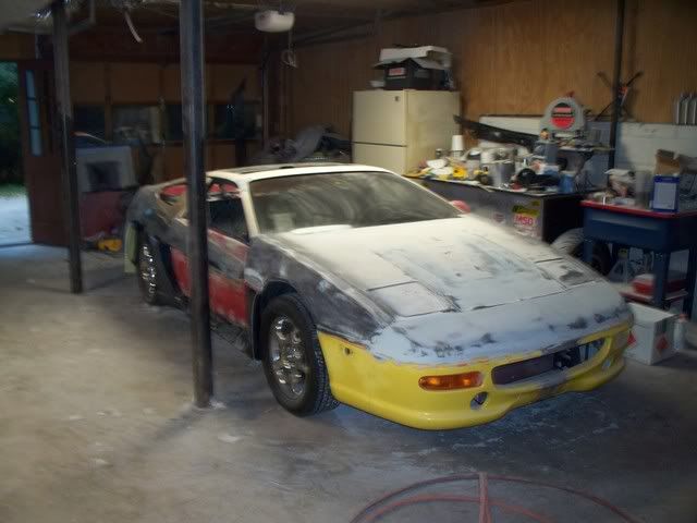

let's play a game! does anyone notice anything different?
Maybe it's those great looking new wheels????

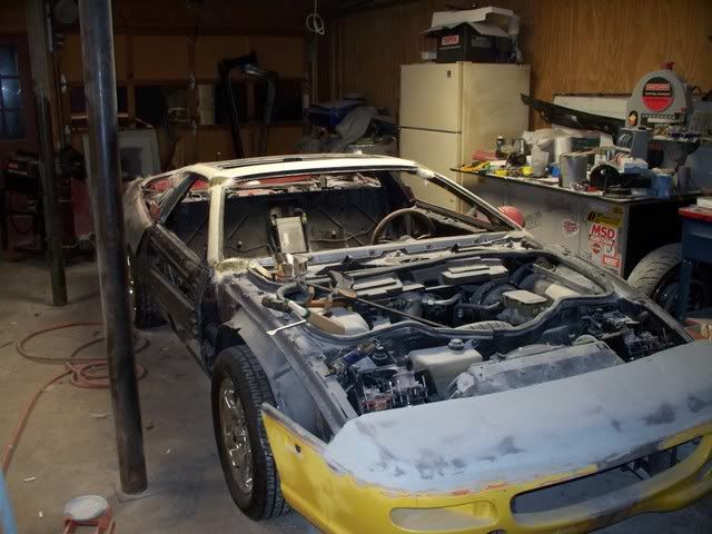

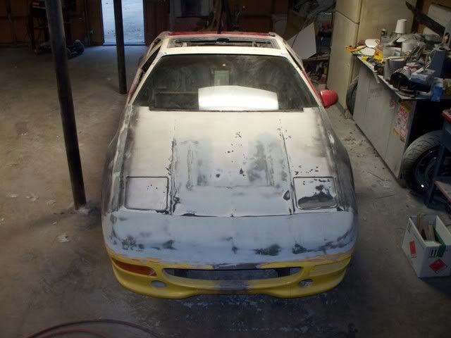

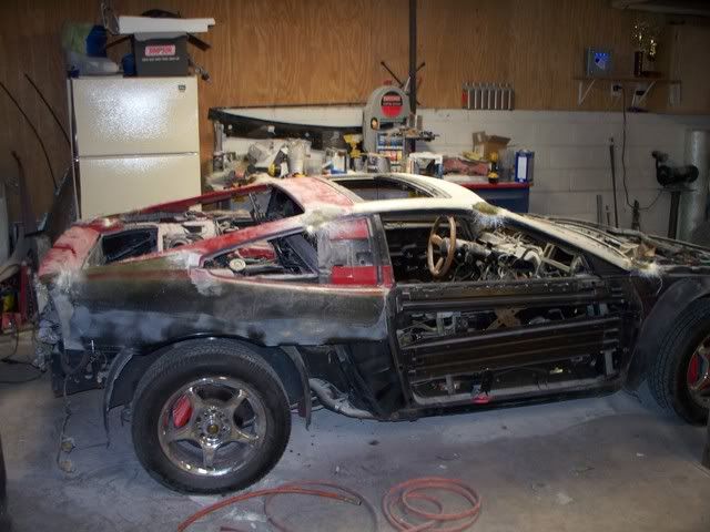

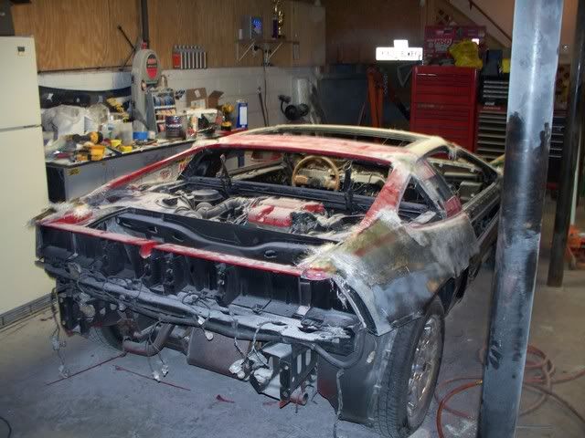

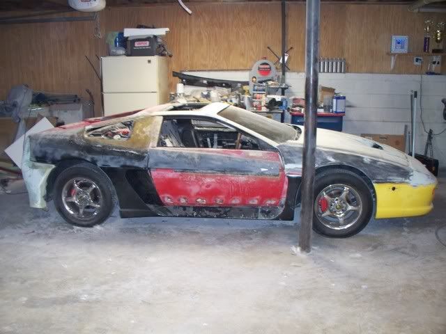

ok last night I was able to get all the welding done and started back on the body to get it fit to the new chop.
here are some pic's from last night.

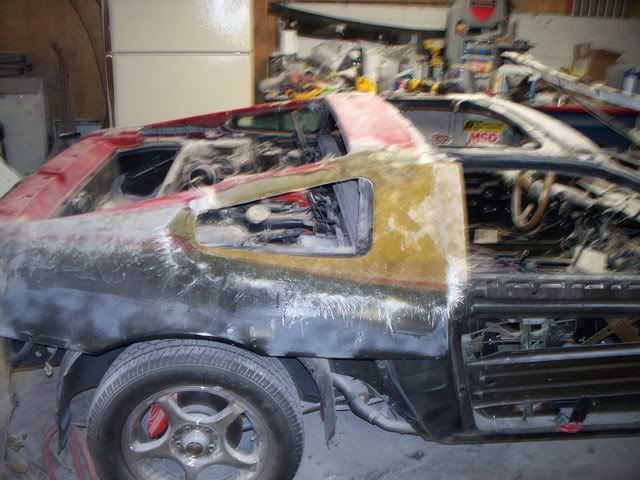

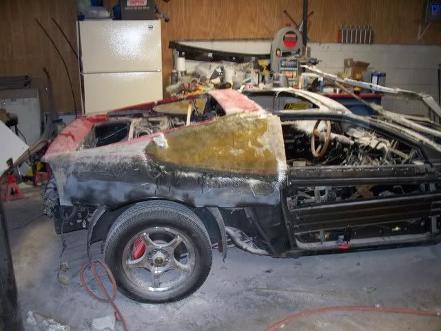

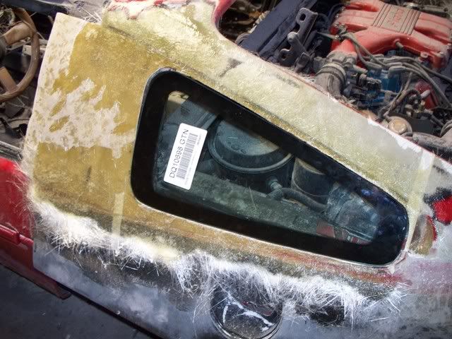

I was able to work on the car a little friday night. I got the top body pannels cut and glassed back together for the new lower roof.
I also made some fiberglass quarter windows to get rid of the plexi.
I will paint them to match the rest of the body and I am going to do something a bit differant for the quarter windows.
I looked at a lot of differant windows and found that the new Mustang windows fit almost perfict for the choptop.
because of the angle on them I will have to use them backwards from the Mustang but I think they will work great and look good.
here are some pic's from this weekend.

I only worked on the car for about 10min.last night. I was tired from the weekend with the fam.
so anyway all I did was cut the holes for the windows but I did get some pic's.
I will be working on the car this week and post more pic's later but for now here you go.
these Mustang windows are not cheep for this small piece of glass has a list price of $1000.
I own a glass shop so I was able to get them for $200 each but still not something that most people will be willing to do.
just a heads up for others thinking about doing this it will not be cheep but it will be cool!

Just a little sneek peek!
last night I wanted to see how the car looked with it's new chop so I just set the body back on to get some pic's.
today I am going to get my new hood vent and door skins so I can get the body complete.

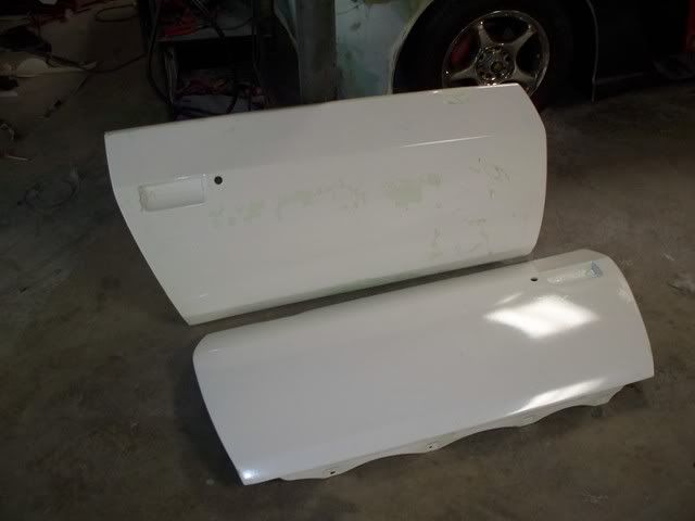

yesterday I took a trip to Paul's AKA Tha Driver and got the fiberglass doors and hood scoop he made for me.
they turned out great. so when I got home I started working on them. I got the hood scoop glassed in and started working on the doors.
I have to glass in the nut's so the door skin will bolt up to the door.
here are some pic's

Report this Post10-06-2008 08:34 AM Click Here to See the Profile for whodeanieClick Here to visit whodeanie's HomePageSend a Private Message to whodeanieEdit/Delete MessageReply w/QuoteDirect Link to This Post
I made a lot of progress this weekend but not much to take pictures of.
just a lot of fiberglass work the underside of the rear section, the hood vent, the fornt facia,doors and the widebody parts.
a lot of the stuf you never see but needs to be done.
I have the car striped at this time to get all the details worked out with all the body parts.
I will finish the glass work one piece at a time and re fit it back on the car one last time before it gets primer.
I will bolt the body all up to fit it all together and do final tweeks.
I am waiting for the wheels to make sure they fit to the body also.
so if I need to change some things I can before it is to late.
I will post more pic's this week.

Report this Post10-07-2008 09:57 AM Click Here to See the Profile for whodeanieClick Here to visit whodeanie's HomePageSend a Private Message to whodeanieEdit/Delete MessageReply w/QuoteDirect Link to This Post
whodeanie
3819 posts
Member since Jan 2008
here is some of what I have been up to.
I have taken the body off the car to finish all the glass work that needed to be done and it is a slow go with that.
also I have just talked to Archie and I am getting a set of his VDC hindges for the car.
I am hoping to start fitting the body parts back on the car to do the fit and finish so I can get it in primer soon.
their is a lot of fiberglass that you will never see that needs to be done to get it right.
I am going to make mounts for the fog lights I have and get all the lights wired while everything is off the car and easy to get to.
I am also using seam sealer to seal all the weld areas from the chop top to waterproof it incase of any pin holes.
I will not be doing the finish bodywork on the car I will get it close and then a friend of mine that does that for a living is going to get the body in shape for paint.
on another note BonSpeed said my wheels will be shipping out friday or monday. I can't wait to get them.
I will try to get some pictures soon I just did not want to post boring bodywork you will never see.
