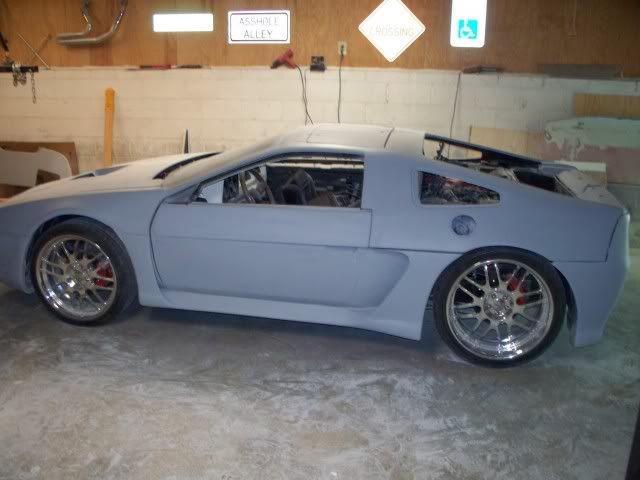

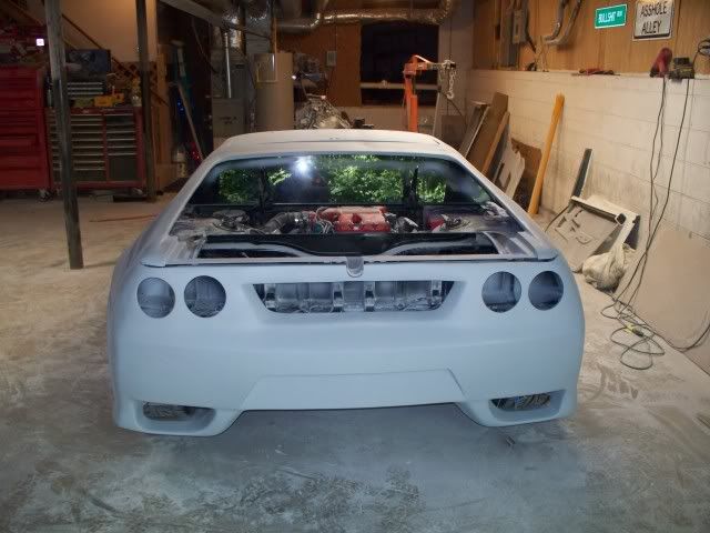

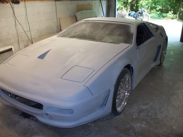

So how did the 3 days of fun go ??
It did not work out like I wanted it to. I hurt my back early in the week so it was bugging me friday then I spent the rest of the weekend sick.
not a good time.
but as I said I was able to do a little I got the car all back in primer but that was about all.
here are some pic's
exoticse
Posts: 8655
From: Orlando, Fl
Total ratings: 108
Report this Post06-29-2009 09:50 AM Click Here to See the Profile for exoticseSend a Private Message to exoticseEdit/Delete MessageReply w/QuoteDirect Link to This Post
The car looks amazing !
Putting it in full primer really gives us a better chance to see what the final product will look like, and it really is amazing !
Wow.

it looks better in green than grey I hate grey primer but it was what I had LOL!
thanks Will now if it were that easy to paint it. I am sick of body work!
right now I am just trying to hit the big spots and do the fitting and glass work then save some money and off to the bodyshop to be their problem.
D.

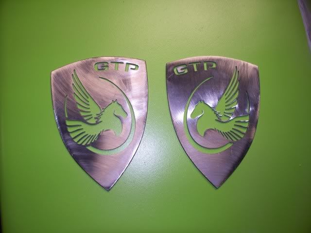

Cool man, I need to make some $$$ so that I can pay to replace the windshield I managed to crack yesterday
I should have your prototype nose badge this week as well. I am cutting on in soft brass as well to do some Dremel work on and chrome plate.
W
W
Nice! Will .... Thanks

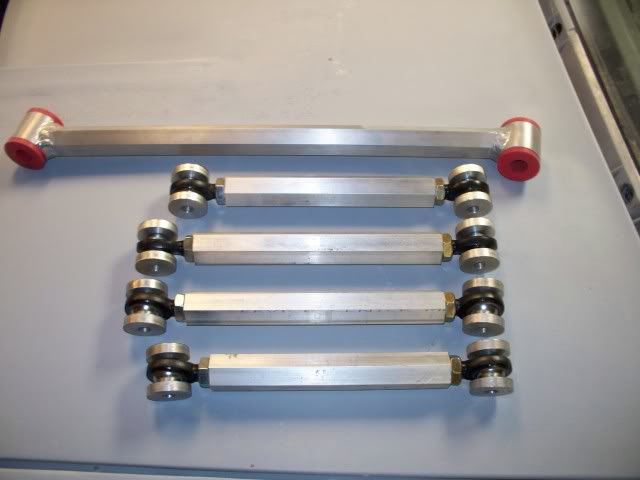

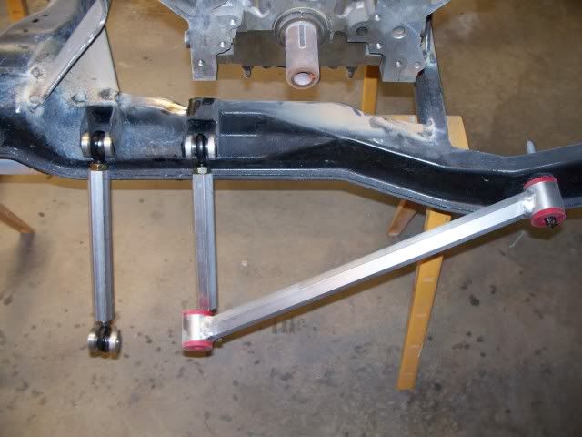

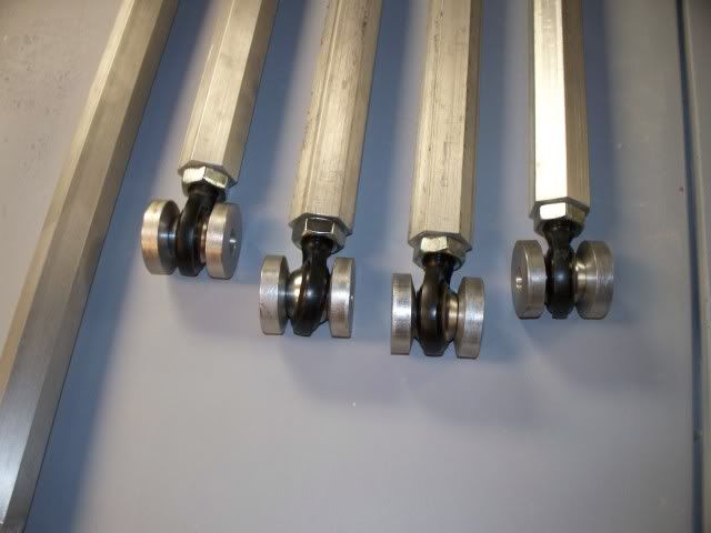

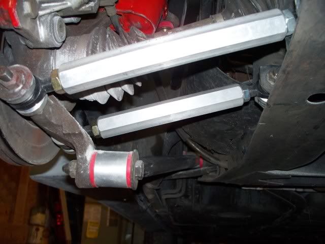

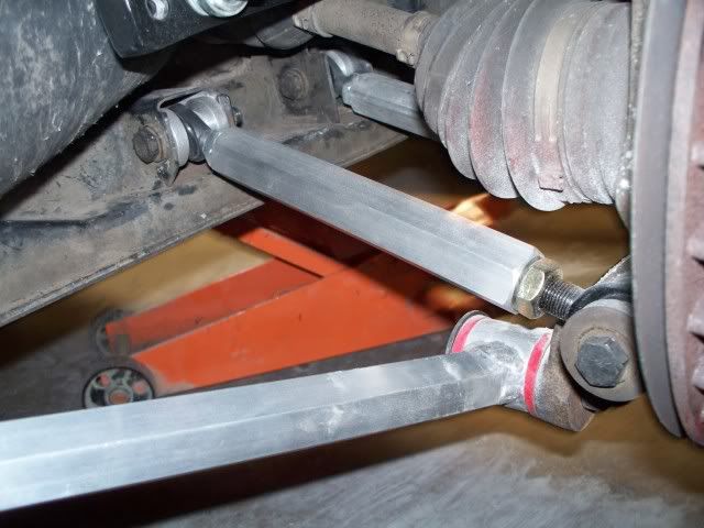

As I said before last night I worked on the link bars for the rear of the car.
here are the details I used the same 1-1/8" alu. hex bar that I made the trailing arm from.
I have talked to Erik from HT several times and the heim joints he got for me are twice as strong as the ones that Lee was using on their kits.
these joints will most likely be the norm for HT's kit for now on.
my link bars are a bit overkill but I wanted them strong.
here are some pic's from last night
D.
this last pic I just set them in place with the cradle I just did the V8 mounts on. just for show

Dean are those rear links made for a wider track width?
whodeanie
Posts: 3819
From: woodstock,Ga.,USA
Registered: Jan 2008
Feedback score:    (14)
Total ratings: 120
Report this Post07-03-2009 10:12 PM Click Here to See the Profile for whodeanieClick Here to visit whodeanie's HomePageSend a Private Message to whodeanieEdit/Delete MessageReply w/QuoteDirect Link to This Post
No, I built them the stock width because I am using the wide wheels so I had no need to move them out farther.

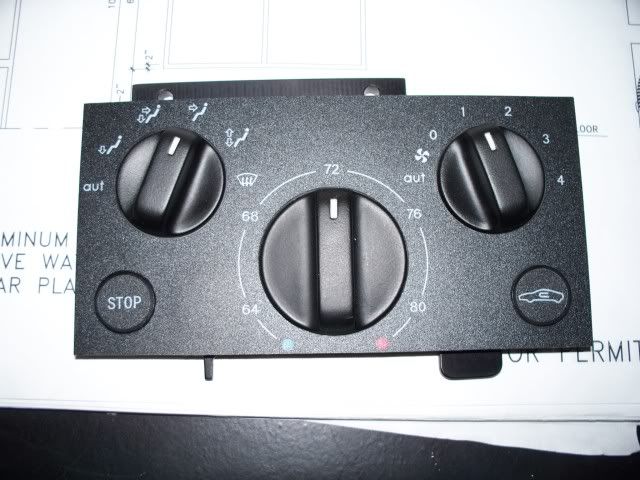

I got a new toy today from Bob AKA RiceBurner
a new AC controller. this thing took a while to get but it was worth the wait.
Nice job Bob!
D.
I ordered the center console from Amida as well it should be done around the end of August.
still a long way to go but one step closer

I was not feeling well this weekend but I did manage to work on the car friday night. I pulled of the stock rear arms and got the new ones installed.

Hey Dean: Whycome you didn't use heims on the forward link?
~ Paul
aka "Tha Driver"
Easy on the Giggle Cream!
whodeanie
Posts: 3819
Total ratings: 120
Report this Post07-15-2009 08:27 AM Click Here to See the Profile for whodeanieClick Here to visit whodeanie's HomePageSend a Private Message to whodeanieEdit/Delete MessageReply w/QuoteDirect Link to This Post
~ Paul
aka "Tha Driver"
I did not use the Heim joints on the trailing arms because they have been known to fail under load with the old Heim joints Held was using.
and with me using an LS I wanted to make sure I would not have a problem.
I went a bit over kill on the links, a friend of mine that builds race cars only uses 7/8 bar for those cars and I went with 1-1/8 bar.
also with dealing with Erik at HT we came up with a new Heim to use that is 2x stronger than the old ones for the bottom links.
but I had already built the trailing arms. I think the new joints would hold up just fine though.
Erik at HT is also sending me a front coilover setup for the car with upper and lower arms and QA1 shocks.
D.

Trailing arms et al all look good. Glad you were feeling better by Monday(come to think of it, you had plenty of energy on that hammer; the fish were quite scared ). I finished up the siding today and only have to finish the inside trim.

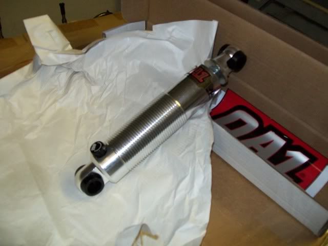

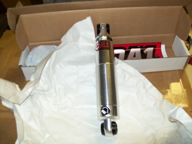

Erik at HT sent me some pic's of part of my new front suspension so I could
my new QA1 shocks to go with the new tube A-arms and coilovers.
D.
