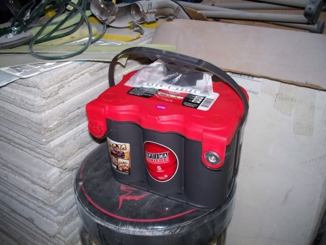

I also picked up a new battery yesterday
/fiero144.jpg[/IMG]
Hmmm! Looks like a disguise for a 6-pack of beer to me.

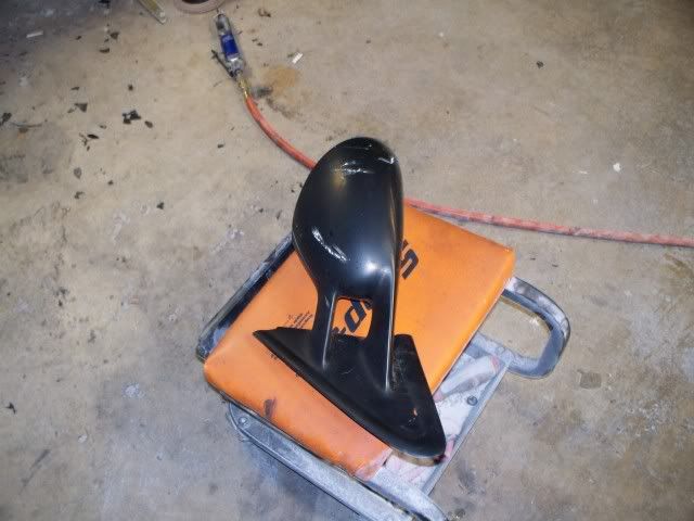

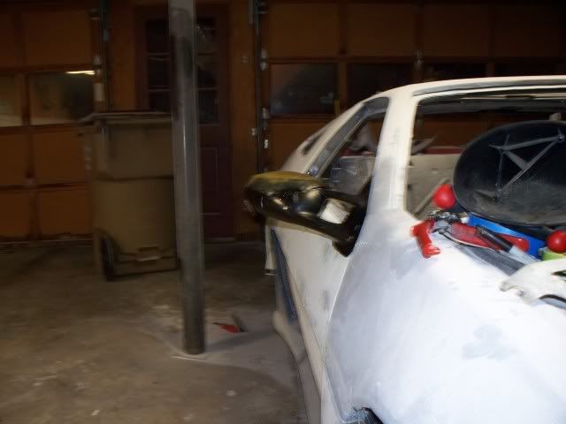

Ok so yesterday I was able to get out of work a little early so I went to a friends junk yard to look around for mirrors and other things.
I found a set that showed a little promise. a Chrysler cirrus. I bought both power mirrors for 10 bucks. they are big and bulky but I can work with them.
I got home and started cutting, trimming and fitting. I spent about an hour on the mirror getting it where I wanted it. I had to cut the top off of it so I glassed over the top to
rework it back together. the mirrors are plastic so what I am doing is getting them where I want them and then I will take them to a friend's shop and have him pull molds to make me a new set in fiberglass. when I got done with it I was very happy with the outcome. I could not find mirrors I liked so I raised the bar and made them!
they are still not done but close. they stick out 8" and there will be plenty of mirror to see. I love the sweep back look to them and with them being chopped like the car they just seam to fit.
here are son pic's from yesterday.
from this,
to this!
and just something else I found at the junk yard.

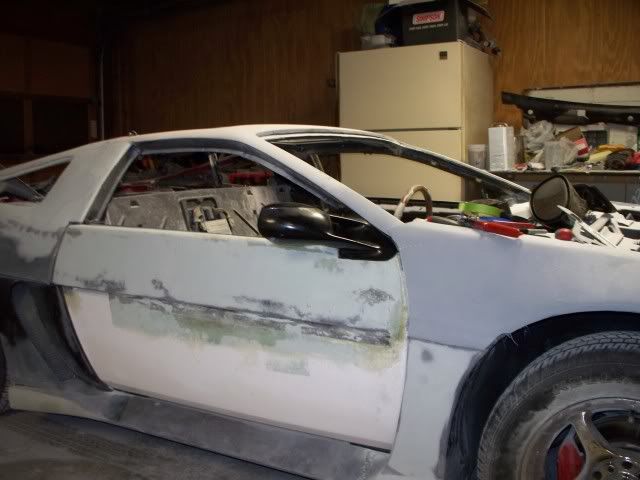

Looks sharp! Sounds like alot of work to modify those mirrors. How many hours did take to complete them?
it is a lot of work but not that bad I spent an hour on the pass side and the drivers side will go faster now that I know what to do.
sometimes it is a pain in the butt to make something cool!

No doubt you'll get around to it, but I just wanted to mention to not over-look the area beneath or base of the mirror. Make sure (if possible) to clean-up this area so that it will flow with the chopper. On #020 this area was re-tweaked to death and now I'm liking it.
Glad to hear it didn't take 54hr (inside joke )
IMO these may be the best looking mirrors on the choptop w/ wide body kit.

Report this Post11-18-2008 02:30 PM Click Here to See the Profile for whodeanieClick Here to visit whodeanie's HomePageSend a Private Message to whodeanieEdit/Delete MessageReply w/QuoteDirect Link to This Post
Curly
I do need to clean up the underside still but I want to wait till I get the mirrors re made in Fiberglass so I don't have to do it twice.
I still have a lot of tweaking to do to them this was just an hour of playing with them to see if it could be done and if it would look good.

Report this Post11-18-2008 06:58 PM Click Here to See the Profile for madcurlSend a Private Message to madcurlEdit/Delete MessageReply w/QuoteDirect Link to This Post
How far do they stick out from the body?
FierociousGT
Posts: 2307
Registered: Jan 2007
Total ratings: 131
Report this Post11-18-2008 08:41 PM Click Here to See the Profile for FierociousGTSend a Private Message to FierociousGTEdit/Delete MessageReply w/QuoteDirect Link to This Post
Curly thats same sizes as yours... lol

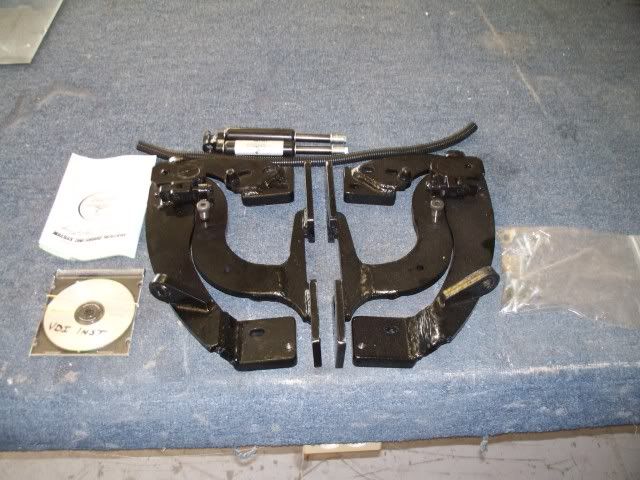

Look what just got here today!
Archie and crew, very nice job I can't wait to get them on the car.
I have to work this weekend so I will keep you posted when I get them on.
a BIG thank you for all the work.

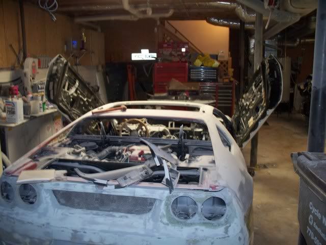

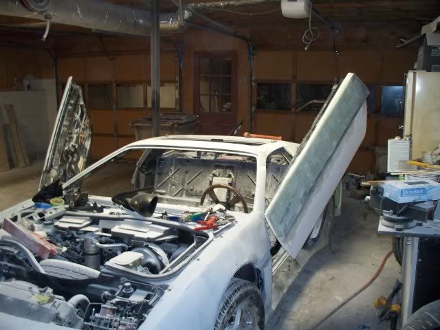

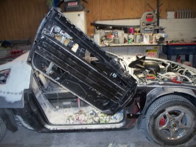

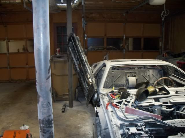

Report this Post11-24-2008 09:18 AM Click Here to See the Profile for whodeanieClick Here to visit whodeanie's HomePageSend a Private Message to whodeanieEdit/Delete MessageReply w/QuoteDirect Link to This Post

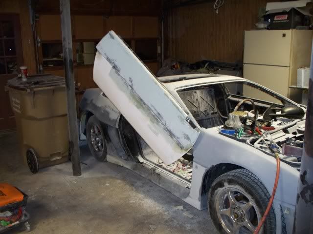

I had to work this weekend but Friday night I went home to atleast start on them but 2hrs later they were done.
my car was most of the way appart already so it went fast. I just want to say Nice job Archie and crew the fit was exact.
a very easy bolt on mod.
here are some pic's of my car with it's new wings!
