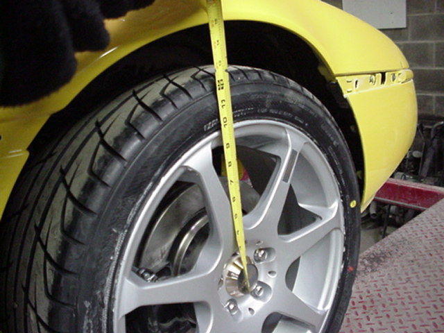

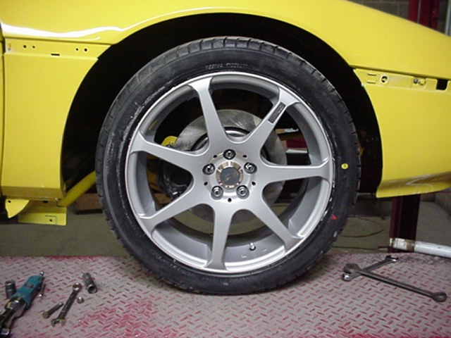

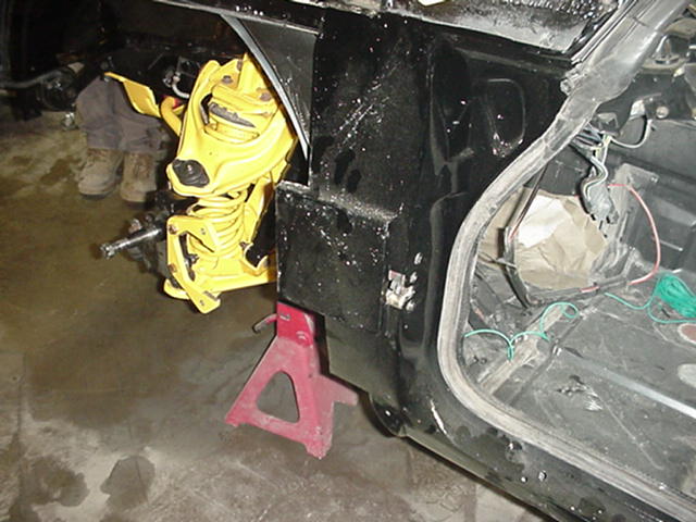

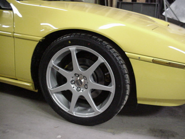

I was asked earlier about how we got the ride height lower & told you that I would write it up for you. I had cut a coil on the rear springs and had installed a set of lowered spindles on the front. You'll remember that when we sat this car on the floor it was way too high & after bouncing up and down on the car it was still too high. Here is a picture of the front a couple of days after putting it on the floor.
Here is another picture taken at the same time, I measured from the center of the wheel to the lip at the top of the wheels well at this time and got 14.5".
Here is a picture of what it looked like when we took it to the show. Guess what? 13.25".

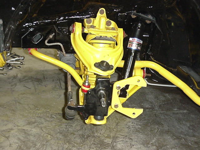

How did we get 13.25"?... We didn't change the springs or remove anything. The car had already been jounced more than we had ever jounced any car.
As I said in my earlier post, I learned something from one of my customers when he made some suggestions on ride height that (after he had seen the pics. in this thread) I had never considered or heard of before. And that was the key to the stance cure.
This customer of mine joined this group a few weeks ago screen name "Fino" & I'm hoping that he is following this thread so that he can also answer your questions.
When he saw the earlier pics. he called me and asked how I assembled the "A" arms to the chassis. Let me try to explain. When someone assembles the suspension on a car, he usually puts the suspension together and tightens it up with the car in the air. Like this...
"Fino" mentioned the following to me... When the suspension "A" rams are bolted to the chassis tightly in the full rebound position the Bushings in the "A" arms become stressed as the car is put on the floor and the "A" arms begin to support the cars weight. Imagine this on a car with rubber bushings. The Bushings are vulcanized right to the outer housing and the inner sleeve. When installed into the "A" arm the outer housing is solid to the "A" arm. Then a bolt passes thru the inner sleeve and attaches it solid to the frame, via the serrated ends on the inner sleeve. When the car is then lowered into the floor the rubber bushing is required to twist & stress just to set on the floor static. Well I slapped myself in the forehead & said "after working on cars since I was 14, how come I never thought of that?". I went on to explain that I didn't use rubber bushings, I instead used the Poly bushings. We discussed it further and decided that I should try a little experiment just to see if the poly bushings bolted tight into the chassis could suffer this malady even if to a lesser degree.
Anyway, so this is what I did.... without lifting the car off of the suspension, I went and loosened all the "A" arm bolts a couple of turns and jounced the car and let it set for a day, then went back and tightened them up.
It could be that the car would have settled in if given enough time. However, given it's to high appearance in those 1st couple of days, I immediately ordered a set of lowering springs and was fully prepared to put them on when I tried this suggestion. If I would have had a set of lowering springs in stock, I would have put them on right away and the car would have ended up WAY TO LOW.
Anyway, I hope this helps someone.

Archie, I thought the stance was strange because I have the same spindles with stock springs on mine. Wasn't sure what springs you have so I just assumed they were taller or stiffer etc. Didn't think about how you were torquing everything down
If you've got access to a lift you can do the torque down easy. If you're in your driveway it's practically impossible to get under the car with it on the ground and the wheels bolted on. You could do it with ramps under the wheels but it's still is tough to get access or leverage under there with a wrench. What I did was with the wheel off, jack up the lower arm approximately to the right ride height. Main thing is removing the major amounts of stress in the bushings, eventually the bushings will settle in. Make sure you don't lift the car off the jackstands by lifting the arm, block everything so there is no chance that the car will fall and torque everything down.

Hey Archie, The method your customer suggested is actually the correct way to put suspension bushings on. You should never tighten the suspension bushing while it is hanging. It causes premature bushing failure. The correct way is to put a jack under the suspension and lift the corner and then tighten the bushings.
Great job with the car. I can't wait to see it.

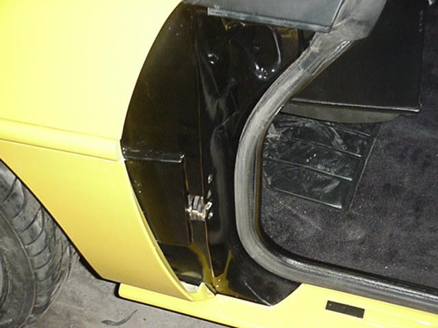

Originally posted by Galen:
Now that we've had a little rest, how would you like to see a few of the inprocess pics that I didn't show you?
I thought I'd show you a few of the construction pictures.
You'll remember the picture above and the speculation that surrounded it.
I knew that thing showed in the pic when I posted it but never thought anyone would notice.
What was it? That was the forward door jam, a couple more pics of it are below.

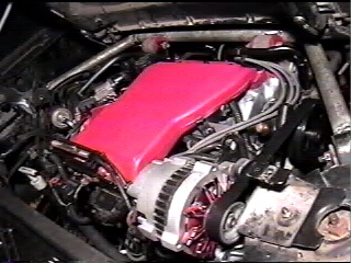

Archie, when did you think of turning the LT1 intake around?
Remember this thread:
https://www.fiero.nl/forum/Archives/Archive-000001/HTML/20020208-2-010973.html
In the 13th post down on the first page I suggested turning the LT1 intake around.
In the 35th post on the 2nd page you posted a picture of an LT1 with intake removed pointing out the differences in the seal rails front and rear. You'd obviously been thinking aobut it as you had gotten far enough along to know this. Or maybe you just know SBC's well enough to know about it.
Anyway, did you get the reversed intake idea from me or did we think of it independently?
Just curious.
Good job with the car and with your best in class win!
Jefrysuko
Posts: 3491
From: Oreana IL
Registered: Apr 2000
Feedback score:    (17)
Total ratings: 108
Report this Post02-17-2002 07:42 PM Click Here to See the Profile for JefrysukoSend a Private Message to JefrysukoDirect Link to This Post
I want to know what was up with this?
Archie
Posts: 9436
From: Las Vegas, NV
Registered: Dec 1999
Total ratings: 547
Report this Post02-17-2002 08:16 PM Click Here to See the Profile for ArchieClick Here to visit Archie's HomePageSend a Private Message to ArchieDirect Link to This Post
Just curious.
Thanks.
Actually, I read that old thread differently than you do. You stated that "LT1 intake manifold can bolt on backwards" Giving the impression that it was just turn it around and bolt on type thing. I just stated that your claim was wrong.
The only way the manifold will bolt on backward is with some heavy modifications. We did the modifications to make it work.
At the time I had posted to that thread we had already turned around an LS1 intake and already knew the mods it would take to do the LT1.
BTW..... one more thing, You also stated "keep the intake in the same place as the stock Fiero V6, simplifying plumbing a little bit". You cannot pull air thru the old side intake to feed this engine. We tried using the stock intake on a normal SBC engine years ago and it just couldn't pull enough air thru the Fiero system to feed the V-8. We ran the test car thru the 1/4 mile and it would just fall flat on it's face before it even got to the Traps.... When we tried it with out the Fiero system, it pulled strong thru the lights. We tested this and I'm positive that plumbing a SBC V-8 thru the old air cleaner system will hurt performance.
Thanks for reminding me of that old thread, I had forgotten all about it.
Would you believe that someone was walking past the car with the door panel and accidently caught it in the pic. and after looking at the pic, decided to leave it in there?
