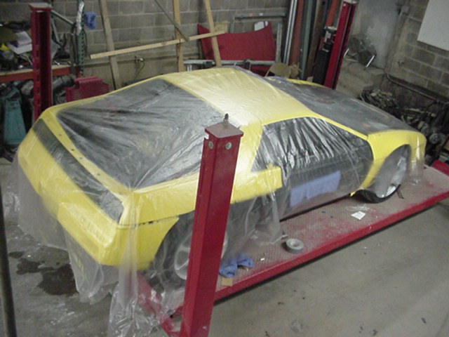

Plastic Car
Reality
Posts: 1026
From: Marietta,OH,USA
Total ratings: 64
Report this Post01-28-2002 09:41 PM Click Here to See the Profile for RealityClick Here to visit Reality's HomePageSend a Private Message to RealityDirect Link to This Post
I know Triad brought it up, but Archie are you going to leave the molding yellow or paint it black?
Sage
Posts: 2971
Feedback score:    (14)
Total ratings: 69
Report this Post01-28-2002 09:48 PM Click Here to See the Profile for SageSend a Private Message to SageDirect Link to This Post
LMAO! Archie, you're a riot! That plastic draped over the back like that almost suggests a "hatchback" look. I know you said the back glass was going to be a 3 piece, but that's just what the pic made me think of.
That car is a masterpiece! Can hardly wait to see the finished product. You are truly a "car artist", hats off to you. It's guys like you that keep the youngsters inspired to make their ride special, better, unique, keep up the great work!
Yep...I've been stung.
Have a good one!

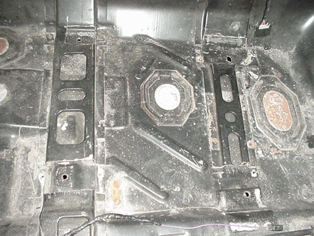

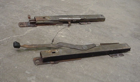

Sorry it took so long to answer this but I wanted to get a couple pics to show with the answer.
You remember Archie has a bit of a flat head, so there should be no clearance problem.
I am 6'1" and a bit wide, and I fit in this chop top pretty well. I seem to have a lot more room than in my Blue car. On the blue car, I had lowered the drivers seat a little and the bottom cushion had 1/2" of foam removed when it was recovered also that car was a sunroof car. On this car we took the ribs out of the floorpan and flattened out the seat rails but did not remove foam from the seat bottom cushion.
Upon trial fitting, with these mods, I can set in the car without "slouching" and my head doesn't touch. I'll show you more pics of the seating as soon as we get done installing the interior.

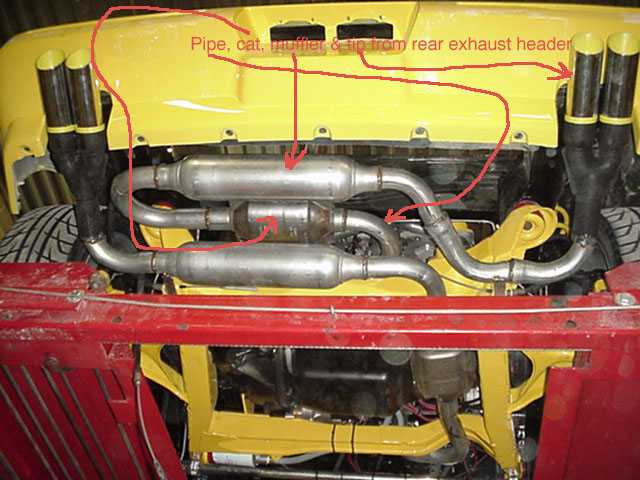

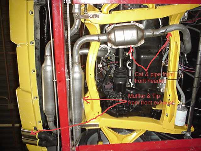

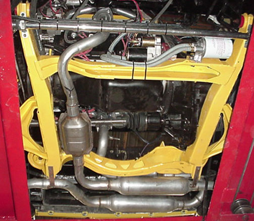

I thought I'd show you the exhaust system on this car.
You can put an exhaust system on your V-8 Fiero without violating the trunk area but on this car I wanted to make it real real real quiet. So we are using dual 2" exhaust with some special mufflers we just found and dual cats and dual resonator tips. If you take about 8" out of the bottom of the trunk area you can get this type of exhaust system in the car just fine. I took the following pics of the finished exhaust before we painted it so you could see it better.
Don't tell me about exhaust restriction, this car will make plenty of power even with a little restriction.
Archie
fix
Posts: 193
From: Houghton, Michigan
Report this Post01-28-2002 11:51 PM Click Here to See the Profile for fixClick Here to visit fix's HomePageSend a Private Message to fixDirect Link to This Post
damn, i was hoping to see a Powerdyne supercharger squeezed in where the AC compressor normally is, but i'm not seeing it. Hopefully there is a supercharger or turbo hidden somewhere in there. But anyway, the car is looking great Archie. Keep it up
Formula88
Posts: 53788
From: Raleigh NC
Total ratings: 554
Report this Post01-28-2002 11:58 PM Click Here to See the Profile for Formula88Send a Private Message to Formula88Direct Link to This Post
Archie, what kind of mufflers are those? They look very similar to regular cherry bombs.

Archie... you just made my day, maybe week maybe month
I'm 6' 2", so there's a chance I could fit in a ChopTop!!!
I've never sat in one, always simply discounted it because I have ~1" of clearance in the T-top car now.
BUT! With the seat mods... and the x-frame allowing an even lower indented 'floorpan' level, I've been renewed!

Ok, yeah that was worth the wait.
So anyone want to guess with me what this is?
I am thinking that it is a coolant tube. Any other ideas?

Looks like a chromed anti-sway bar from the location.

The cables and pulleys are part of the 4-post lift that the car is up on.
I was thinking that too, but the brackets sure don't look stout enough to support a sway bar. I'm thinking coolant or heater line. But then, again, there's something zip-tied to it.
