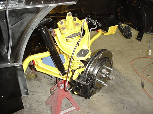

Here I was thinking Archie was going to install antilock brakes on it, but the calipers don't look like they're ABS-capable.
Although, he has yet to show the calipers that are actually going to go on the car... hmmm...

Well, by looking at the master cylinder, looks like there is no ABS, I don't see any ABS unit. One idea down the tubes. Any others out there have an idea on what his three SECRET mods are? Hmmmmmmmmmm

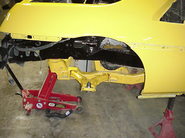

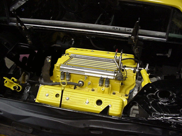

We got a LOT done on the car today. Got the engine in it for the last time, got the roof and rear clip on for the last time. Windshield installed and rear window installed & the front brakes are all installed, plus a bunch of other stuff.
It looks like we'll fire this sucker up Friday...... then install the rest of the body work.
BTW, I'll be using the stock mirrors in the stock locations on this car.
I've got a bunch of pics to post up tonite but have a bunch of running around to do right now, so I'll post them a little later.
Here is what the front brakes look like.

A few more pics from today.....of course there are still some pcs. yet to be installed, but we are working on it.

Archie,
Please install the oil filler cap and plug the ventilation hole in the valve cover before you drop something into the motor. I'd hate to hear about some senseless delays...

Archie , You putting a small block in that Jag I see in the background?
From what I have heard stock for stock the ealry suspensions react better to a V8 then the 88's do.
JM
MinnGreenGT
Posts: 11545
From: Lakeville, MN 55044
Total ratings: 274
Report this Post01-17-2002 11:06 AM Click Here to See the Profile for MinnGreenGTClick Here to visit MinnGreenGT's HomePageSend a Private Message to MinnGreenGTDirect Link to This Post
I was wondering the same thing

Archie,
In noticed you turned the intake manifold around backwards. Pretty cool idea.
What brand wire harness and computer program/chip are you going to use?
I have been wiring LT1s in a variety of different cars of late. I ran into a bad problem with some defective Street and Performance harnesses that had the left and right O2 sensor wire switched. This will cause a world of problems on the newer LTI computers.
Painless does a great job, but for a long time they did not do the newer style LT1 with the reprogramable computer.
Building one from scratch is okay, but takes an awefull amount of time. I have a complete stock 95 harness in the attic right now that I decided in favor of an aftermarket harness.
How do you hook up the vacuum ports on the Opti spark that evacuate the moisture from the unit?
Looking good. Very yellow.
jelly2m8
Posts: 6316
From: Nova Scotia, Canada
Total ratings: 242
Report this Post01-17-2002 01:01 PM Click Here to See the Profile for jelly2m8Send a Private Message to jelly2m8Direct Link to This Post
Originally posted by Chris McDonald:
Archie,
ahhh, look at that!, Chris is on the BALL!
I was looking at the fuel lines, and knew the fuel rail was on the other way, funny how I never even noticed the plenum!

Archie,
I for one would like to know how exactly is that intake working backwards in terms of the throttle cable and such. I assume you'll have it breathing fresh air thru the factory air scoop right? I've been thinking of doing this to mine for quite some time now. I see you beat me to it!
Also, the goose neck on the water pump seems to be pointing the wrong way. Is that part of the new mods too?
