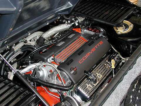

Hmmm... Where have I seen that red Corvette LT1 before?
Oh Wait! It's right here. In my car!
sjp777: I may have access to an LT1 for you. Interested?
TRIAD: I'd definitively go with an LT1. You'd never even consider anything else once you ride in one.I also have docs that show the LT1 reaching max torque before the LS1 does.
It is as sweet as it gets on a Fiero. Definitively worth every penny. I met about 5 people at the Dells show that are already working on theirs. Go ahead and Join the club!
