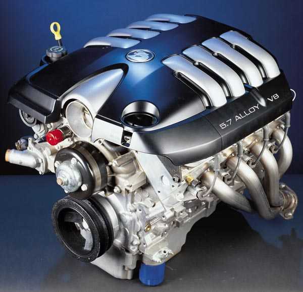

see you havent read the lingafelter 427 cid ls1 artical in last months popular hotrodding and all aluminum and the ls1 is an aussi engine not american
and this pic is right from holden motor sports in australia
[This message has been edited by bubbajoexx (edited 06-07-2001).]
The LS1 is a product of GM powertrain and available to all divisions of GM, including Holden.
I wish they sold a Holden commodore or equivalent here.

the engine was created and fist develope in australia not gm of america yes the holdens still have rear wheel drive in almost all of there cars the lsi was first used in the 98 modle year
