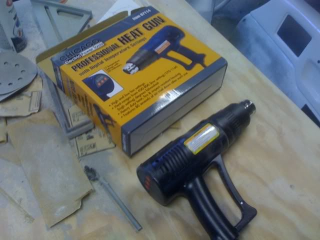

Minor Updates:
Picked up a new heat on sale for 10 bucks!
Used this baby to remove the carpet from the door panel

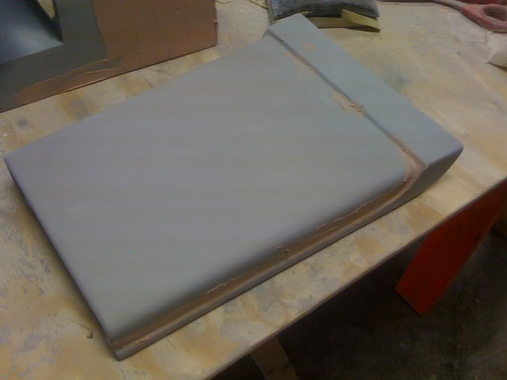

I worked on both the armrest and the radio console
Like I said... not much movement this weekend. I had too much to do.

What a difference between the heat gun and removing the carpet with a friggin X-Acto knife - one thread at a time.

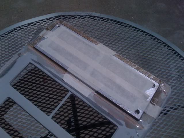

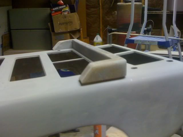

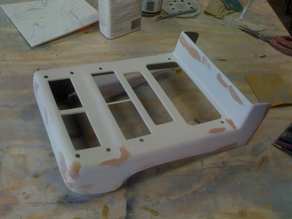

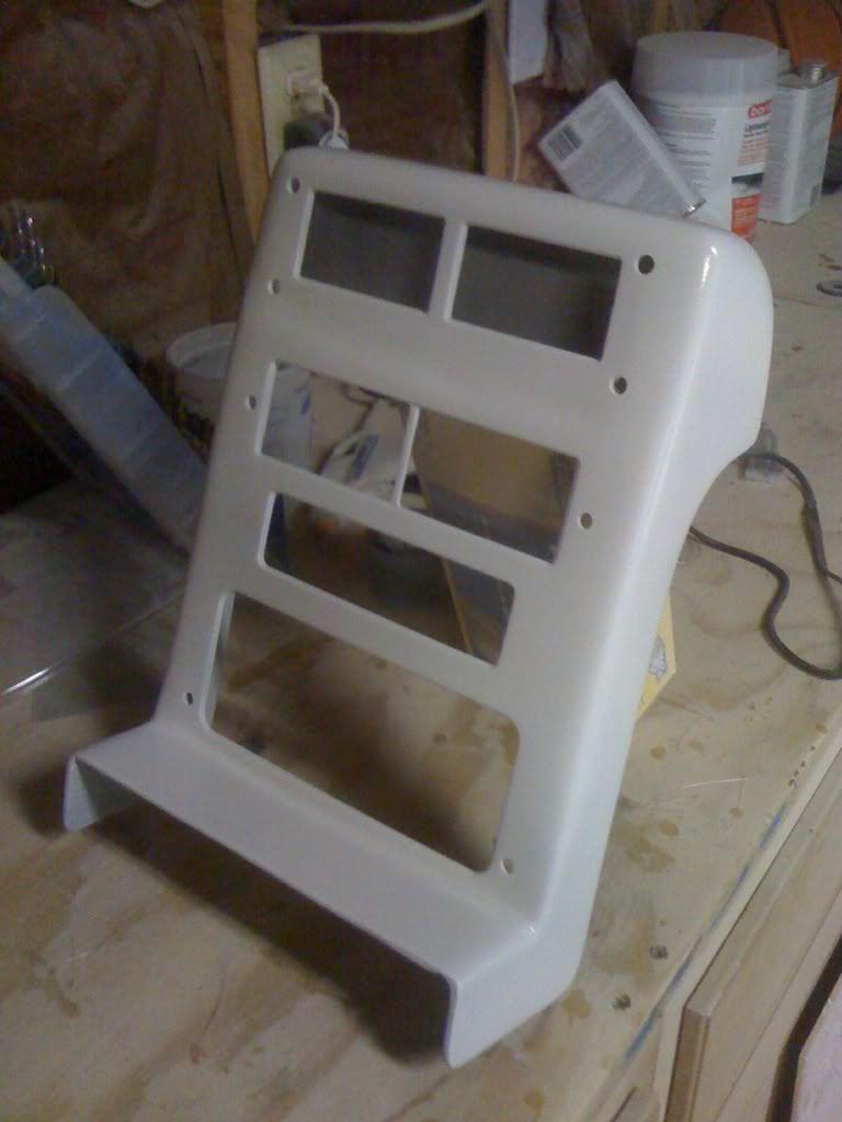

UPDATES

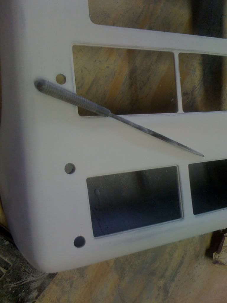

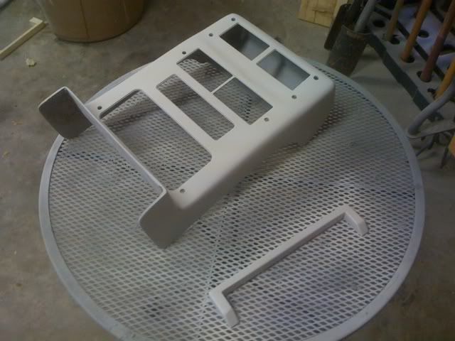

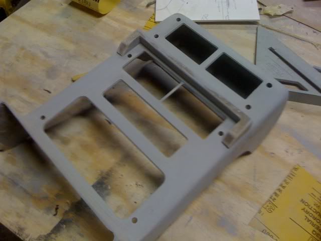

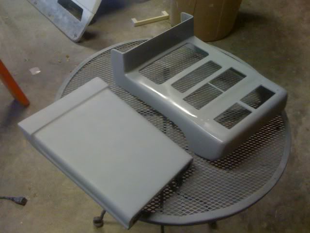

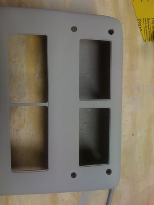

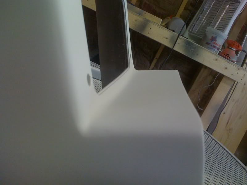

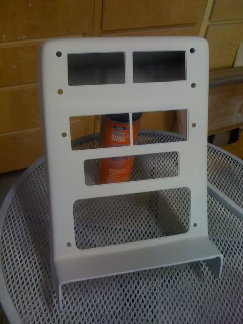

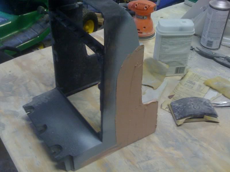

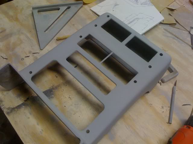

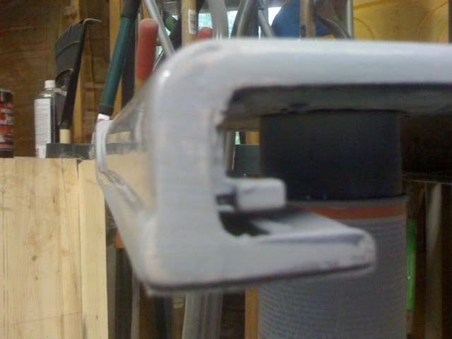

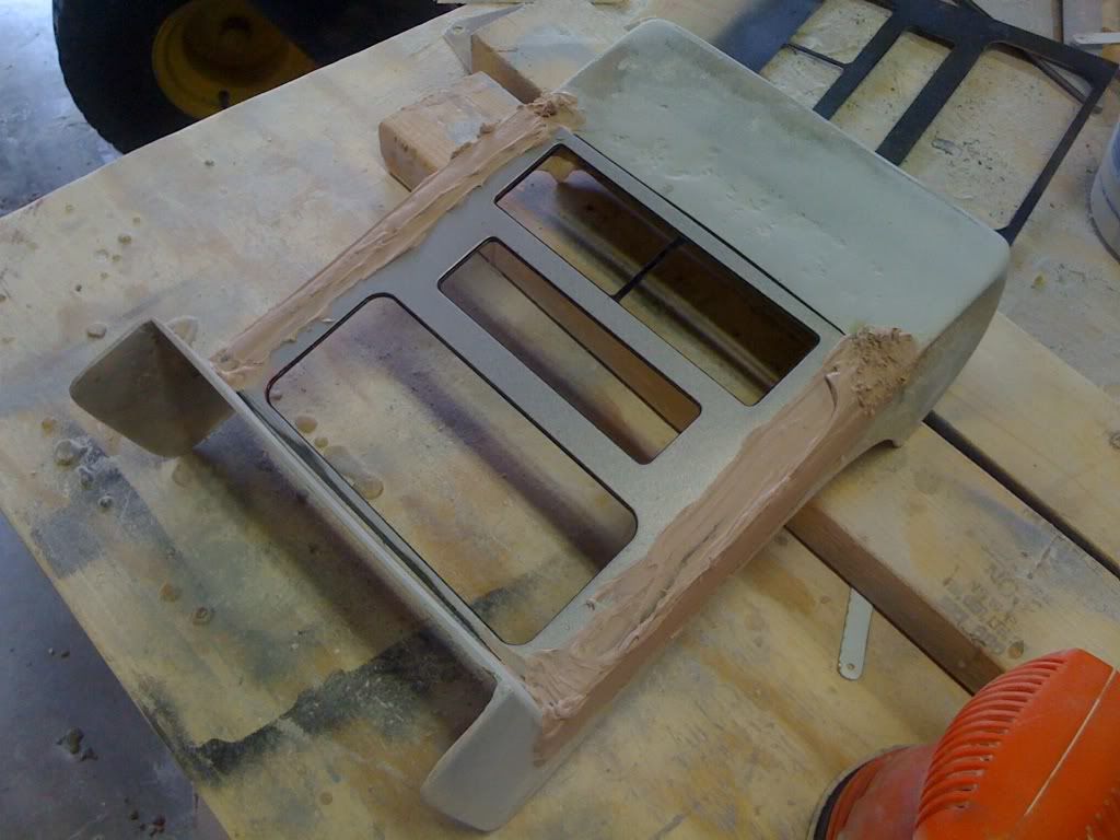

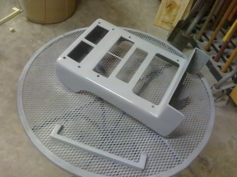

I worked on the radio cover this morning and was able to get a lot done. I just a few more little divots to fill and then she's good to go.
I cut holes for the hex nuts. I'm going to cut the heads off and resin them into place - the nuts are for show only
I also cut a 45 degree angle on the edges of the lip I created. I've decided (95%) to go ahead and adhere this about the vents
Together (not permanently)
Primed
Overview of the holes cut
White primer
NICE & SMOOTH
Beauty Shot

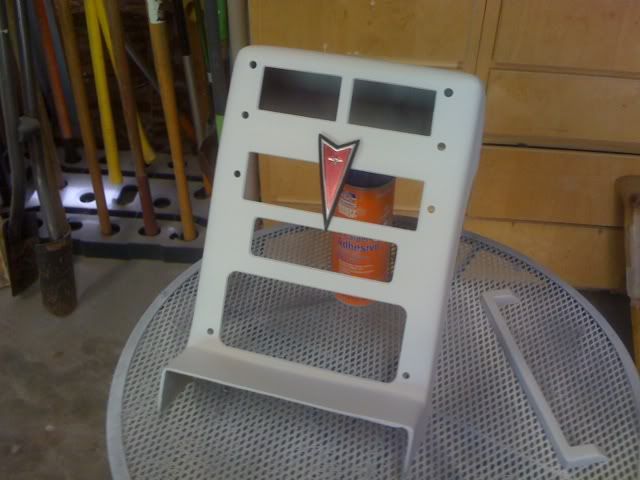

OK... what do you think of this? If I did this I wouldn't be able to move the vents up and down. It's an interesting look but I'm not sold on it... yet...
That's it for now. Got to get back out there

Ahh, I think the emblem just looks out of place right there.
Sofa King
Posts: 929
Registered: Aug 2008
Report this Post04-24-2010 05:12 PM Click Here to See the Profile for Sofa KingSend a Private Message to Sofa KingEdit/Delete MessageReply w/QuoteDirect Link to This Post
Yeah... I tend to agree. It was just a thought.

Both trim plates had 4 bolt holes. I had to move the holes on the lower trim plate for asthetic reasons and to account for the lip over the vents. Speaking of which, I've decided to put the lip over the vents - which means I can't place the Pontiac logo. But I'll fiddle with the design a little more before I go final

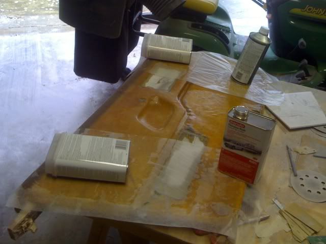

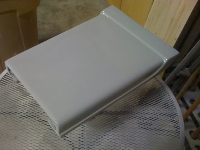

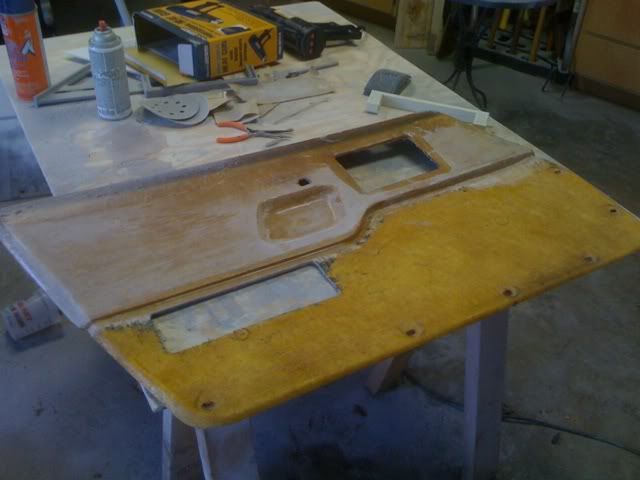

A few more updates:

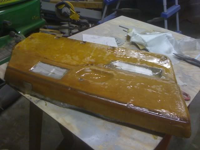

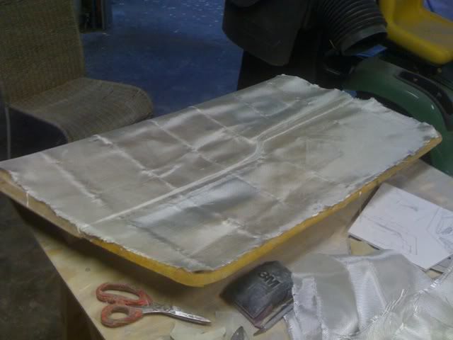

I worked on both the door panel and the armrest. Since I'm going to do something different with the armrest I had to create more of lip around the edges. I also began to lay more glass on the door panel.
I used my trusty Dremel to cut into the edges to get a more defined look
Another
Trimming glass to prep for resin
Resin added - I'll add 2 more layers of glass to the panel and then basically do the same thing I did on the panel. It'll be nice to have them both finished and installed! I am considering putting the Pontiac Logo someplace but I don't want to overdo the whole "Logo" thing... I dunno, still thinking...
I had to add some weight because the panel was really warped
That's for today

The original trim plates have already been integrated into the new radio cover. To carry over from the original console design I went ahead and drilled the holes for the hex screws. They will not actually mount into anything. I'm going to cut the heads off, create backer plates that will be mounted behind the holes and then carefully resin the screw heads into place. Which means that whenever I have someone work on the car I have to remove the radio cover so they don't break the screw heads.
As you can see by these images the trim plates are resined and adhered to the radio cover I created
Does that make sense?

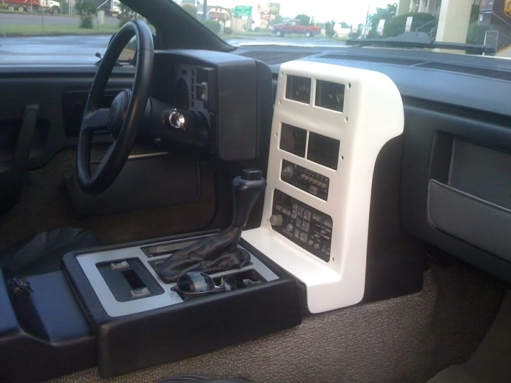

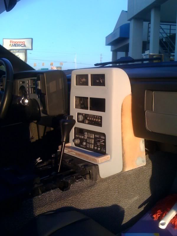

OK GUYS...
This is bad... really bad...
I temporarily installed the radio cover back into the car to get a feel for fit and finish... And I'm not feeling it... I don't like it. Not sure what happened and I really don't know what to do at this point. Granted I still have to fix the gaps between the radio, a/c, and the cover, paint the actual console itself and then adhere the lip over the vent... but I'm just not excited about this piece anymore. Not sure what to do or what direction to go... I really like the look of the 89 console and I think that's where I got in trouble... My focus shifted.

Report this Post05-03-2010 07:47 AM Click Here to See the Profile for Sofa KingSend a Private Message to Sofa KingEdit/Delete MessageReply w/QuoteDirect Link to This Post
Some Updates!
It rained ALL weekend but in between the down pours I was able to squeak out some forward movement. The humidity made the drying times a bit longer. I still have a few touch ups but it's coming along.
Added more filler to the radio cover
Then took a file and rounded out all the hex nut holes
The armrest proved to be a HUGE pain! She refuses to go down without a FIGHT! It's been a frustrating task.
Added more filler to the console and then sanded
Added the first layer of gloss paint
In the car. I'm still not sure what to do about the shift console. I need to design something that compliments both the armrest and the radio cover. I'm still working different designs. If you guys have ANY ideas - please shoot them my way! One thing definite, I am going to create a little tray that sits right in front of the radio - per my original design. I think this will be permanently attached to the center console but I'm not sure yet. The tray will be fairly deep and the design will carry from radio cover to the shifter console - good stuff! Still not sure what to do with vent lip. Add it? Leave it off?
I still have a more filler to add and then the daunting task of sanding the paint, spraying the high gloss clear, sanding, clear, sanding, clear... etc etc etc. OH yeah... I like that part.
I think I'm back on track and the creative juices are flowing!
[This message has been edited by Sofa King (edited 05-03-2010).]

Report this Post05-03-2010 05:42 PM Click Here to See the Profile for SharkmanSend a Private Message to SharkmanEdit/Delete MessageReply w/QuoteDirect Link to This Post
Nice work, I will se if I can draw something for your to get more ideas
