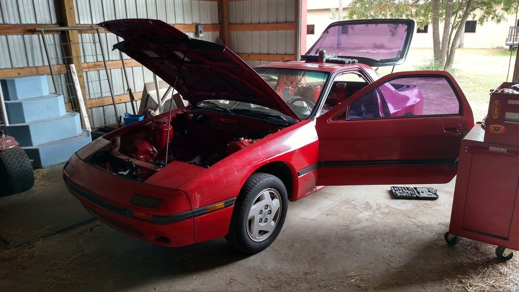

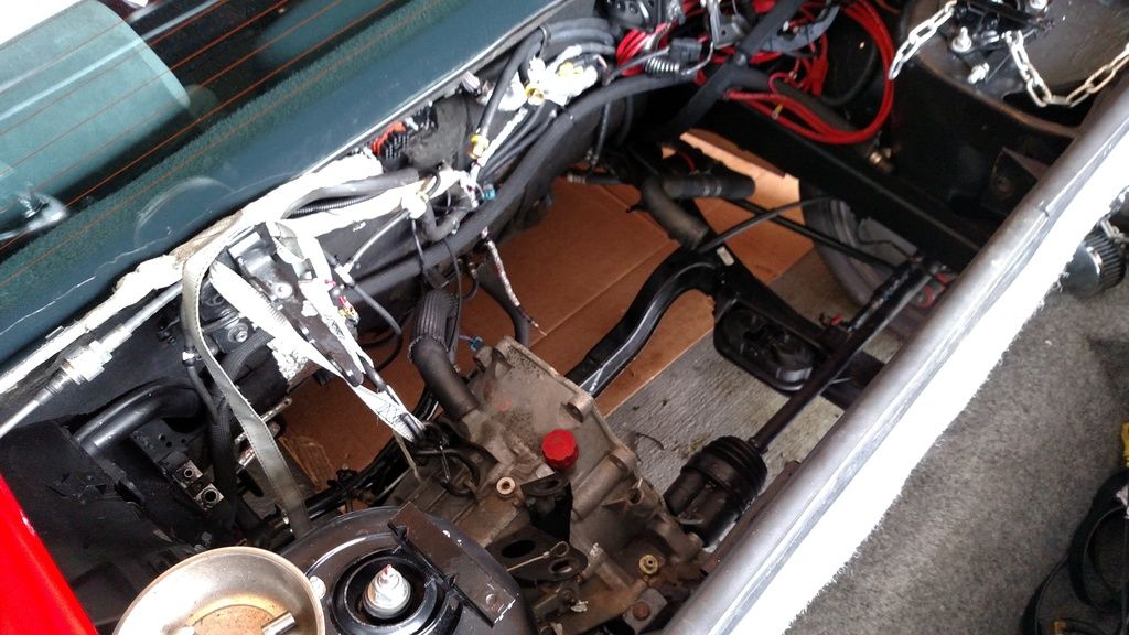

I finally got around to swapping out the flywheel bolts. Its all back together now. The new SPEC flywheel doesnt seem happy with my starter. I get a bit of that classic chevy starter needs shimmed sound upon startup. Other than it took forever for it to relearn idle, its driveable for now.
Impression. ZOMG wow is it fast. Like properly fast! I never liked the gearing of the F23 before. Now, its fine. Each gear pulls like its 1 lower. Even on 265/35 Potenza RE760's the car will boil the tires in 2nd. High boost tune you ask? LOL not anytime soon. I'm good for now.
Now on to paint, and interior.

Well the flywheel bolt fix has been completely sucessful. I spent hours working on a solution. 10mm x 1.00 is what the crank needs to be drilled for. I used flywheel bols for a Nissan 240z from ARP. 70ftlbs of TQ, they arent backing out anymore. RESULT!
Did I mention I am tearing the car apart? I watched too many vids from turbo tom on youtube and got super excited about the car. The car is going to be completely rebuilt from the ground up. Not sure what I am going to do drivetrain wise, but the turbo stuff from my car is for sale in the mall. Once my new shop is finished (40x60 with a lift) BVMotorsports will be back up and officially running.

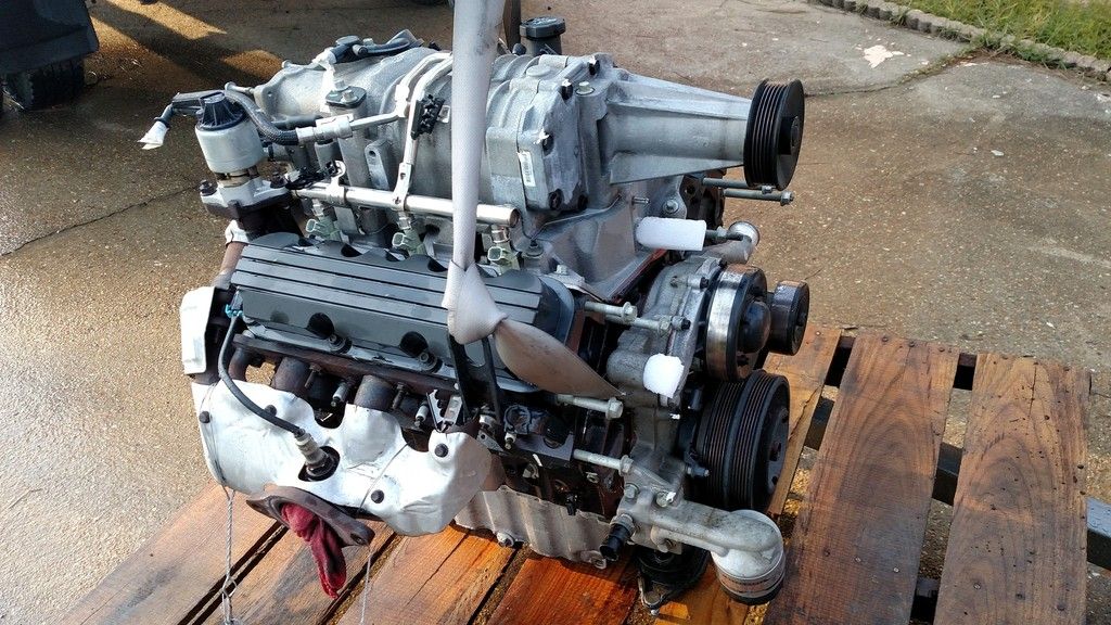

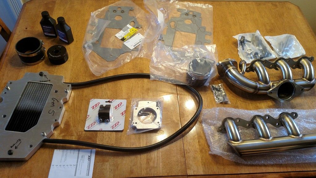

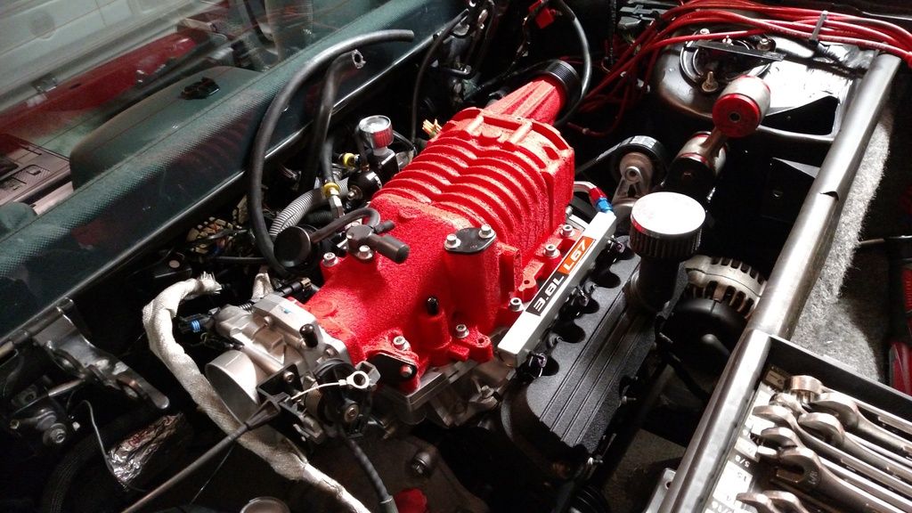

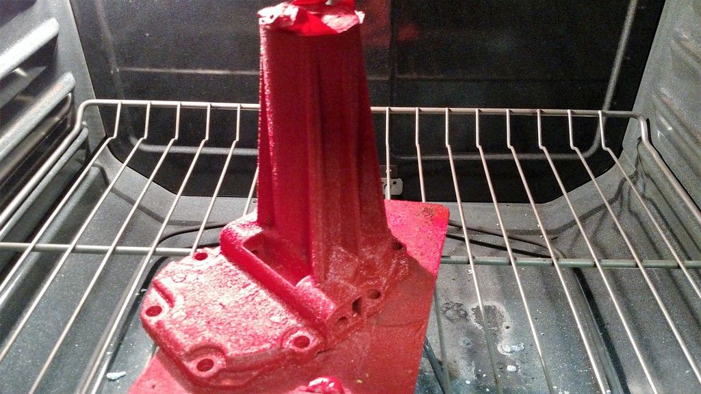

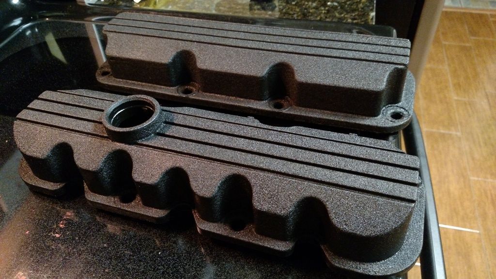

I picked up a 70k mile 2007 Pontiac Grand Prix GT L32. I am switching it to run on s2 wiring and electronics.
Presents!!!

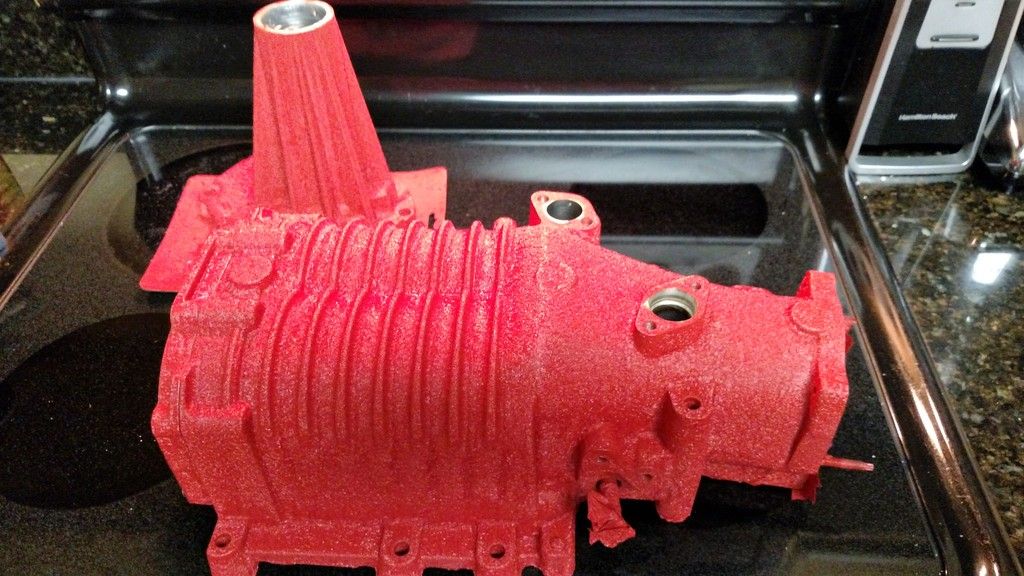

A little spit and polish
I may have a slight wrinkle finish fetish
Women love finding car parts in the oven. No not really.....

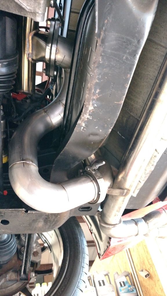

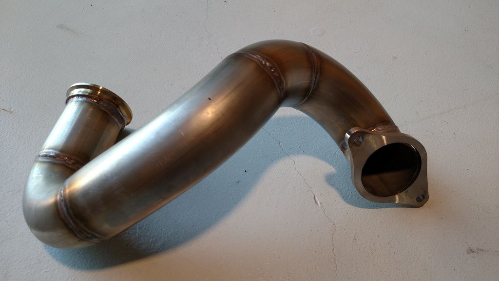

It runs! Once I figured out I forgot to plug in the new LQ4 MAF sensor, it ran pretty well. Now I am waiting on my 4" aluminum pipe and various silicone hoses so I can make a proper CAI. I ordered one of those 3" mandrel bent doughnut thingys and a 3" U/J bend combo. Hopefully I can tie it into the beautiful Borla exhaust Fierobsessed made for me. Thats one part I dont want to part with.
Exhaust
