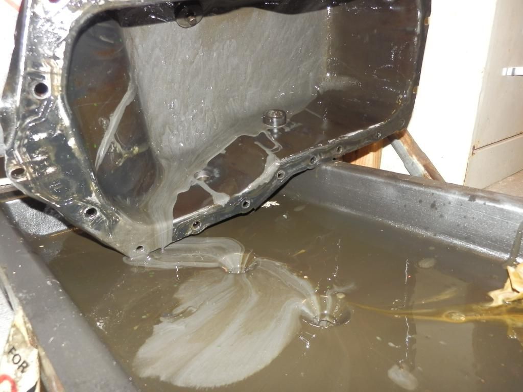

This came out of my Whodumbass engine.
I do need to get some correct flywheel bolts. I couldn't believe I found hardware store bolts. As for the clutch, I cant say that I trust it. It didn't feel like it slipped when I drove it, but I never got to launch it either.

Originally posted by BV MotorSports:
Uh oh... catastrophic failure. Either the balance shaft broke or the trans did.

Originally posted by Justinbart:
What the wat?
My buddy Rob and I swapped out the yellow LS6 springs and retainers. I installed blue LS6 springs and ZZP titanium retainers. We also installed the short ZZP valve seals. After that, the valvetrain noise was reduced but still there. It sounds just like a sticky lifter. So I figured a quick drive around the block would 1) burn off all the oil & water from the swap and 2) free up the lifter. Well, the smoke kinda comes and goes. Not sure about that one. The car pulls well, but the lifter tick didnt go away. I went to make a U-turn at the church and head back to the house. I have to say, it felt FANTASTIC to be driving the ol' girl. As I slowed down and downshifted to 2nd I heard a grinding/scraping kind of noise. It sounded like the parking brake cable was dragging. So I headed to the house. Under power it seemed OK but the gear changes werent as smooth. Then BAMMMMMMMM all hell broke loose. There is a nasty metal on metal clanking sound. Its NOT rod knock. I made a vid, I'll post it in a bit. I drained the oil through a coffee filter, it looked perfect. Here is the funny thing, if you just bring it off idle the noise pretty much goes away. it sounds like a bag of hammers in a drier @ idle. Rob thinks something let loose in the trans or clutch. Remember, the engine runs perfectly. If you have ever broke an axle, that is pretty much the sound its making. So out comes the F23 this weekend. If its broken (or the clutch) I am seriously considering putting the 4T65HD I have setting in the shed in it.
Like mentioned above, I just have no luck with this car. It IS cursed. I asked Jeff if he would buy me a set of lifters but he pretty much washed his hands of the engine. Whatever, its only $90 for a set of LS7 lifters from ZZP. So I got to pull the intake again. Remember its siliconed together so it has to come off as one piece. You know, because gaskets are so overrated. That mother*%^&^& might as well be welded, I aint getting the UIM away from the LIM.
LOL it wont be on ebay, it owes me way too much money to ever sell it. I even thought about throwing the LQ1 from Garths car in it but, now is not the time to make any drastic decisions. I just need to cool off and think about it.
One last thing. I got to say thanks to Scott aka DH for all the support with this car. You are A OK in my book. Not the jackass troll I assumed you were all these years. In all seriousness, if you want help with all things L67, Scott is your man.
[This message has been edited by BV MotorSports (edited 09-04-2013).]

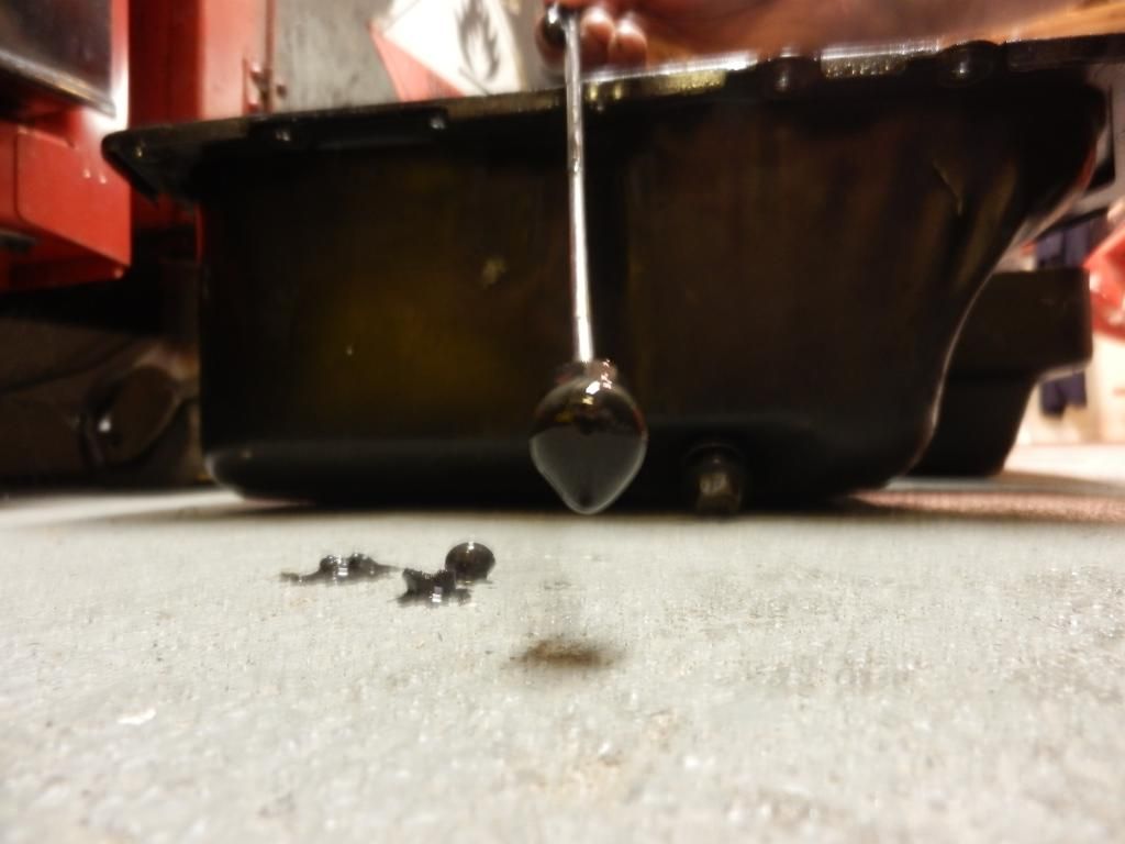

Dude, that sucks. I bet something in the trans let loose. Every manual transmission I have grenaded has sounded like that.

The "LS7" lifters are the same part number as 3800 replacement lifters. We've never had any problems running stock stuff up here.
Does the noise change when you push the clutch in?
I wonder if you broke your timing chain tensioner.
Noise is constant. In gear, out of gear, clutch in/out. However, bring it up off idle and it goes from sounding like the thing is about to explode to normal. Riddle me that!
