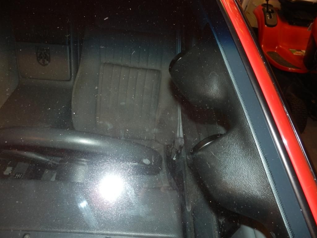

I still need to decide what I am going to do about the additional gauges. I hate the A pillar pod. I cant see the gauges in the day time because they get washed out by sunlight.

I used1.5" 90degree PVC street elbows to mount some gauges similar to GM's pace cars. I can email a picture if you want. It's hard to post them from my iPad.
Please do.

Stole this from another thread. This is in one of the PPG Fiero pace car:

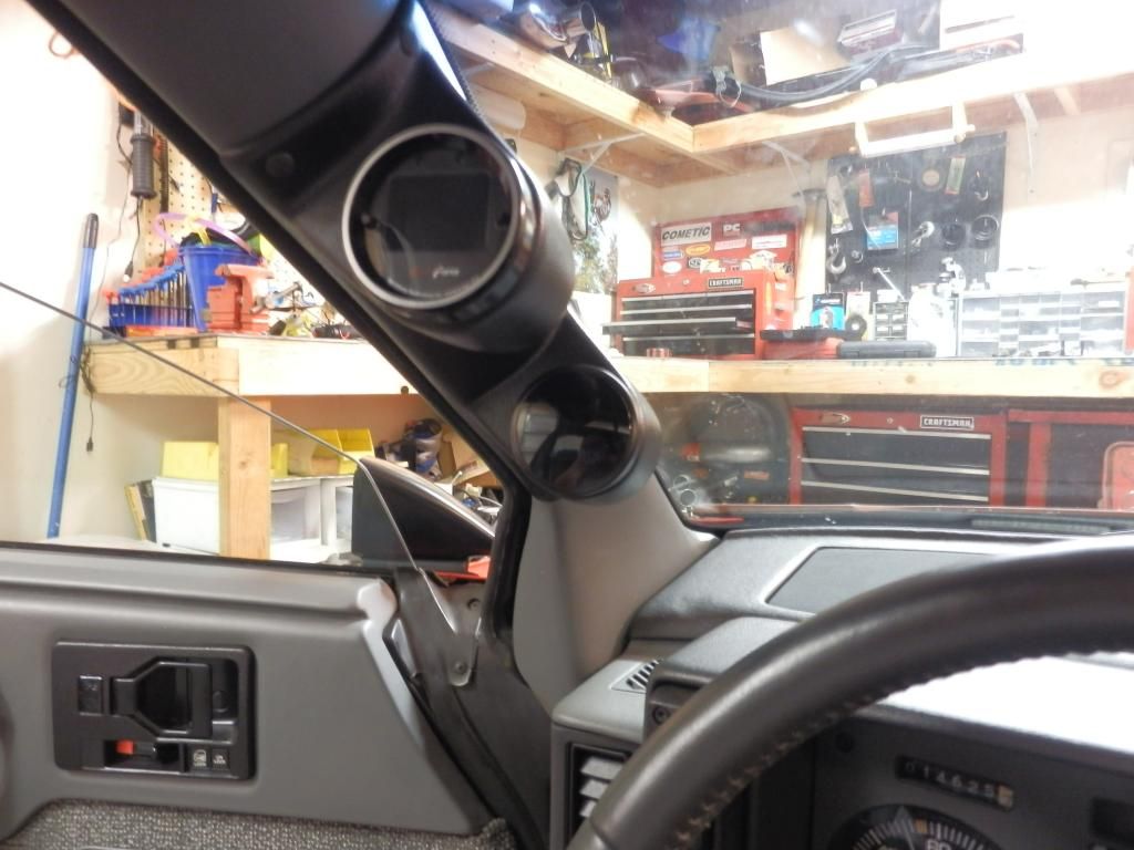

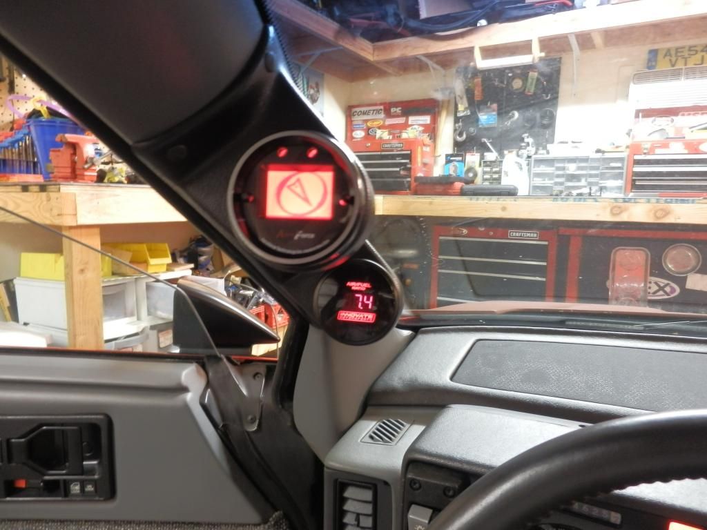

BV MotorSports
4821 posts
Member since May 2001
FS pillar pod mounted. Trust me, this fits way better than that crap Neon pod!

I like how the gauges look
