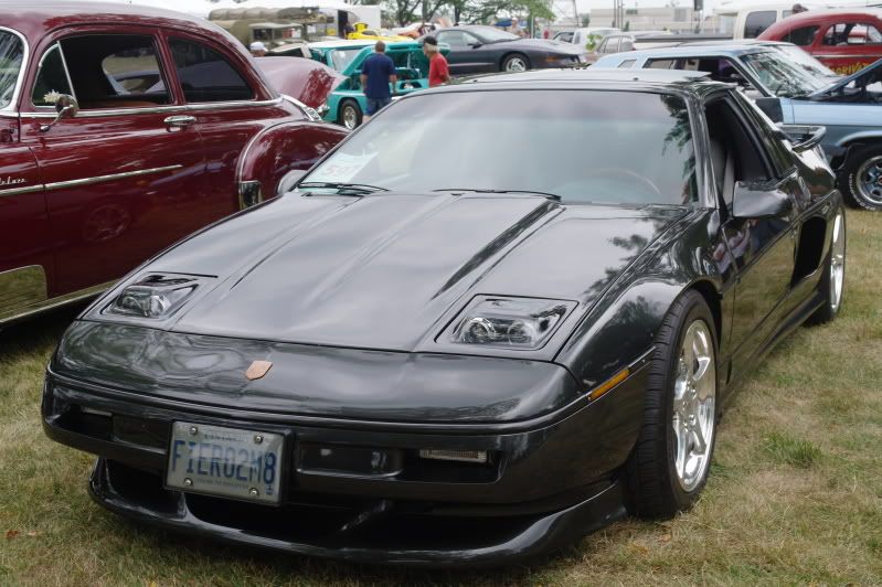

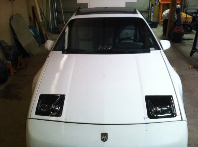

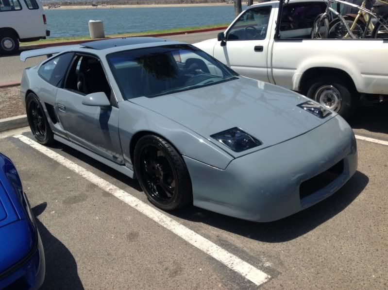

ive been following this thread since the beginning, and I applaud your work. I really do, when I get an honest chance, i'd like to buy two sets. but there are two things that irk me.
1.) painting the lenses... im just cursed with perfectionism, id literally die if I messed up the painting (either too much/little or not straight and symetreical to the other lens.
2.) the lenses sitting flush at the back. my artistic eyes observe the lenses sit a little low in the hood and therefor I see a BOLD straight edge at the back of the rounded lenses, i feel if they say a bit higher up in the back to fit flush, it would stop attracting my eyes.

Thanks,
Painting the lenses isn't as hard as you'd think. You just need to get creative with how you make them the same on both sides. I put the lenses side by side, used some green painters tape and took some measurements. I also used some paper to trace the curves I made, so I could flip them over and replicate the same curve on the otherside. Not as difficult as you'd think.
Once you mask the lens, you're also painting from the inside. You really can't paint too much/too little. Just go heavy with the paint and get as many layers on as you can. This way, any light from projectors cannot penetrate through the paint.
The whole unit is adjustible up and down so the line you're seeing at the back can be made to be flush with the body work. I aimed the lights properly but still haven't adjusted the buckets to sit higher at the back. I should probably do that soon lol.

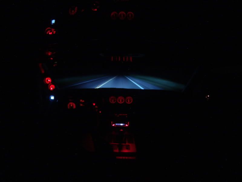

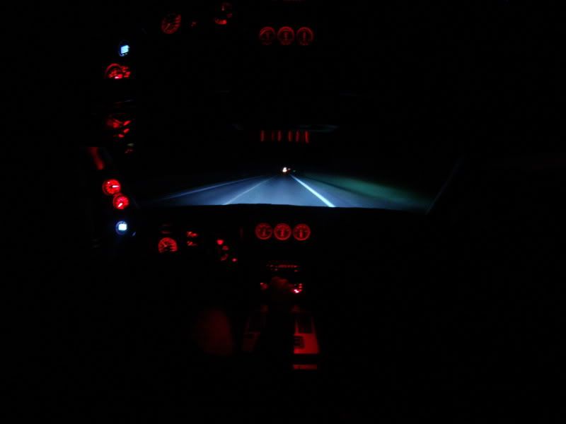

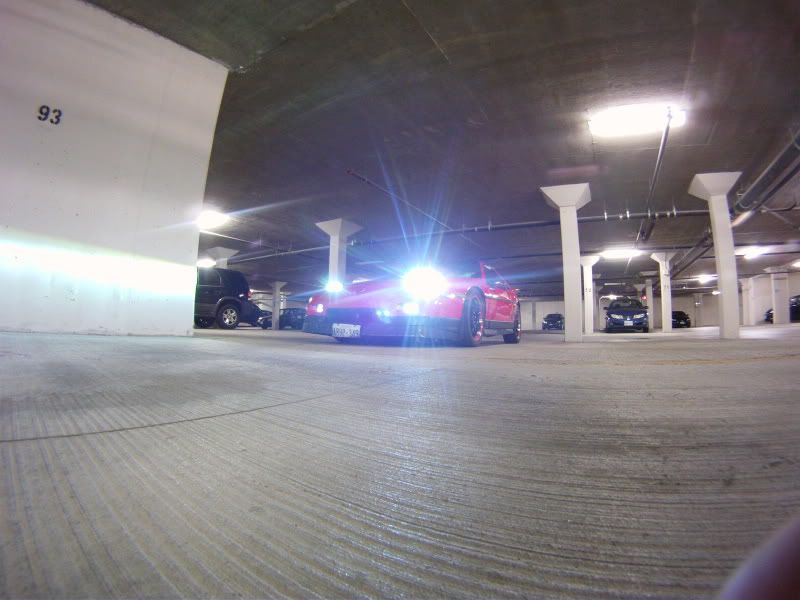

Some night pictures:
Just to reiterate, this is with only a single pair of projectors on, 35W bulbs, and 8000K temp bulbs (6000K are the brightest). These were all shot with low beam only!

can you explain: "single pair of projectors on, 35W bulbs, and 8000K temp bulbs (6000K are the brightest)"
I would think that 8000k sould be brighter than 6000k ?
These look great, what a difference for flush mounts !!!!!!!!!!
[This message has been edited by nightonfire (edited 06-22-2012).]
doublec4
Posts: 8289
Feedback score:    (20)
Total ratings: 150
Report this Post06-22-2012 04:32 PM Click Here to See the Profile for doublec4Send a Private Message to doublec4Edit/Delete MessageReply w/QuoteDirect Link to This Post
Thank you
What I mean by a single pair of projectors is that I'm only using one light in each housing right now. The kit comes with 2 projector units in each housing. So technically those pictures are with half of the possible light output.
Also, the HID kit I was using there are 35W ballasts/bulbs. 55W kits are available and are supposed to be even brighter.
Lastly, 8000K is the "temperature" of the bulb which determines the colour of light output. 8000K is more of an ice blue colour where as 6000K more closely simulates regular daylight. As you move away from the regular day light bulb temperature, the light isn't quite as bright or ideal for your vision. You can get HID kits in colours like purple/green etc. Their temperatures are upwards of 14000K. While they look cool, they don't do much for seeing at night and are likely to get you a ticket because of their colour.
Thanks for the question!

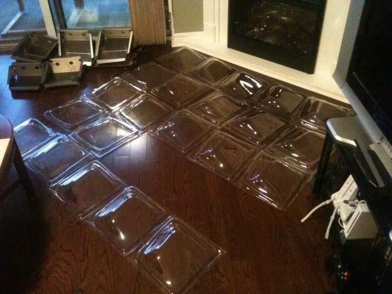

Lots of lenses are getting done! More buckets on the way + projectors should be here soon!

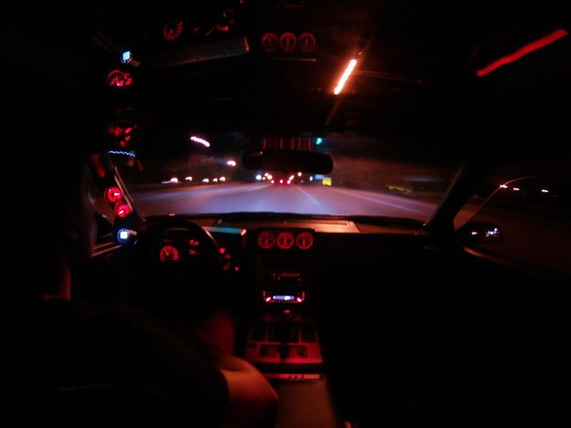

Got my harnesses in from ebay. Hooked them up and its really easy to get all 4 headlights on at the same time:
Its hard to see the separate lights in the pictures, but in person you can easily identify that 4 lights are on. You can also see that the cut off is sharp against the wall.
Tonight I'll see if I can snap more pictures while driving. I can't wait to see how 4 lights function! Should be super bright!
I don't think they'll ever be a need for high beams with this set up, but the lights do have the high beam function for those who want to go from BRIGHT to the power of a thousand suns, lol...

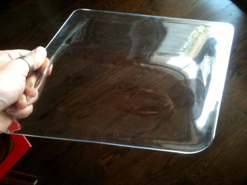

I'll post some pictures tonight of the laser cut sample lenses I had done. Turned out great and everyone's lights will be done this way

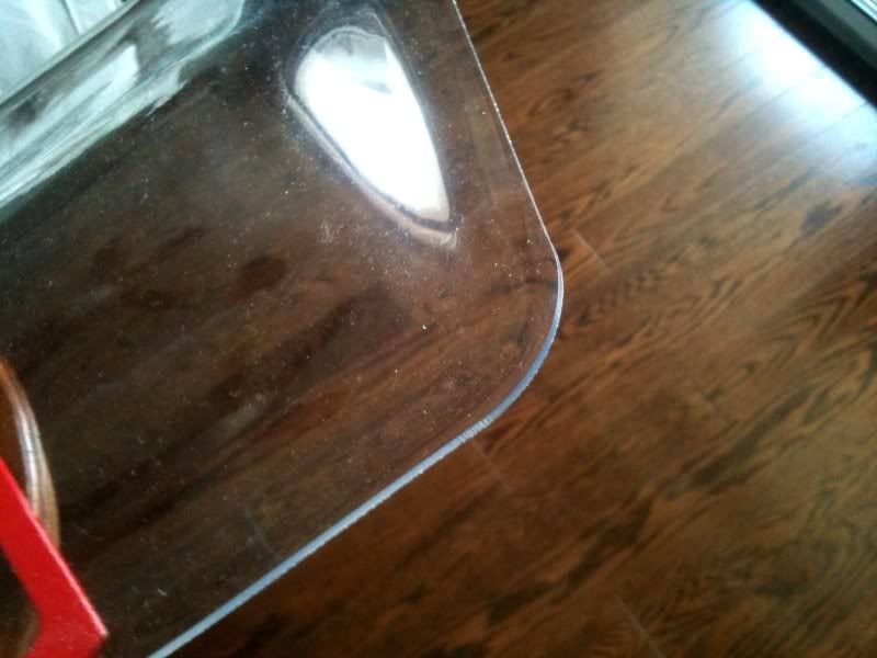

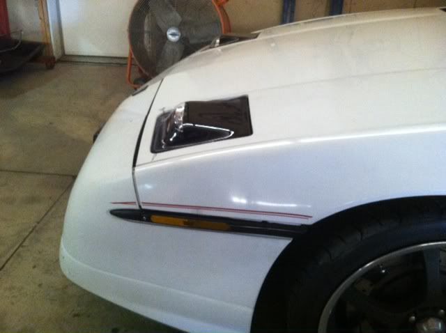

By the way,
the laser cutting is great:
Precision fitment + a nice edge. Just excuse the dust and the rough shape of the hood cut out I use.
