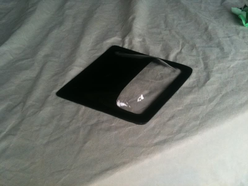

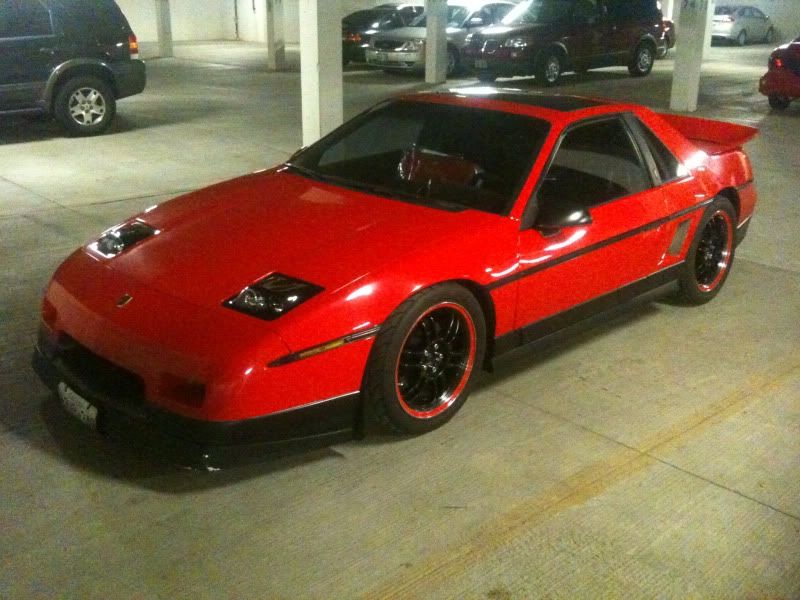

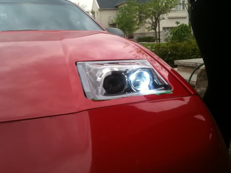

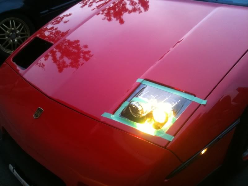

New vs. Old:

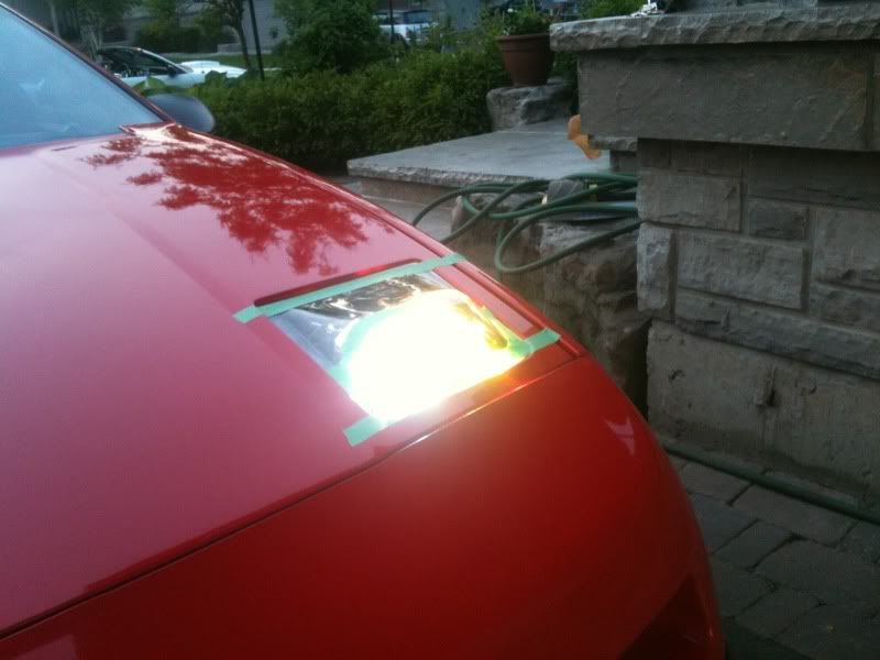

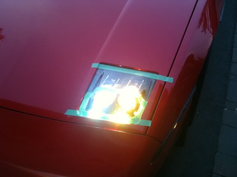

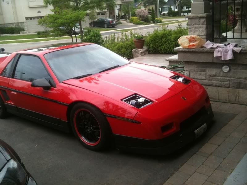

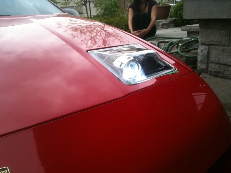

A few more quick shots of the lenses sitting a little more flush:

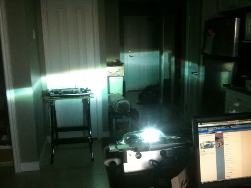

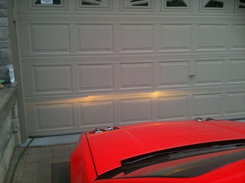

Also, the profile of the lights isn't all that high. They really don't bubble up like frog eyes. Hopefully people who thought they were going to have the frog eye look change their minds
Lastly, the cut off is sharp. The lens doesn't distort it as much as it did when I was testing it in my kitchen.
This is just a single light on and it was still pretty bright outside. I didn't install the other side yet. Enjoy!

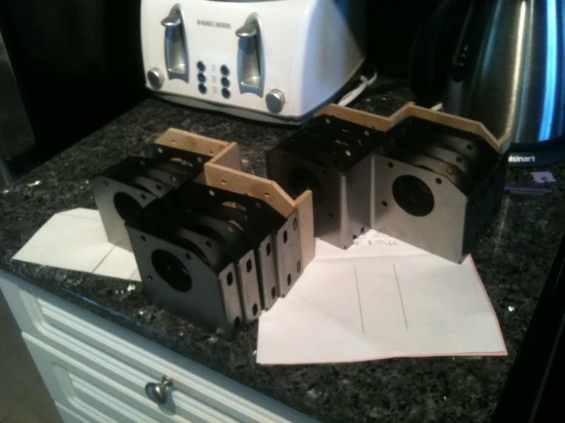

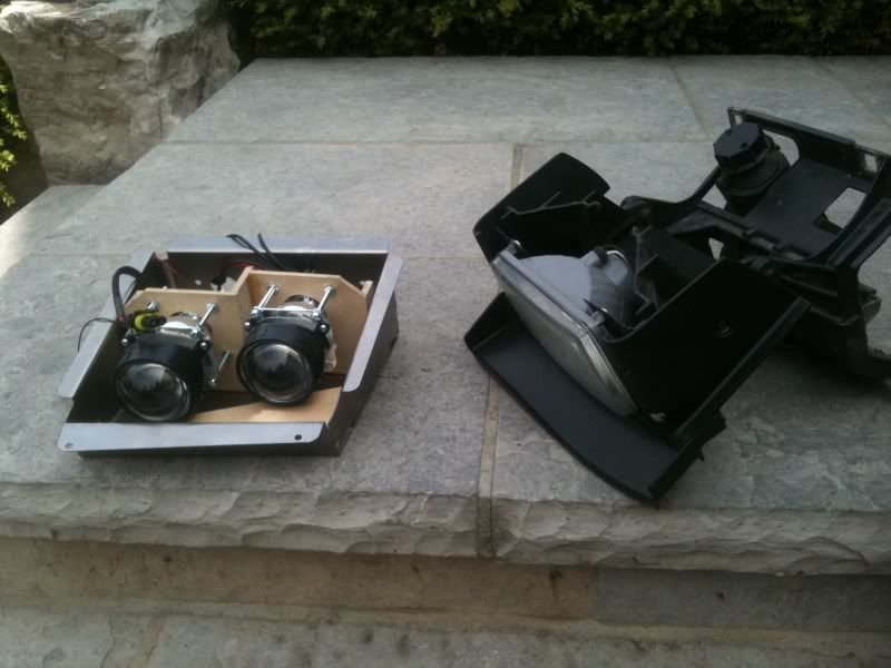

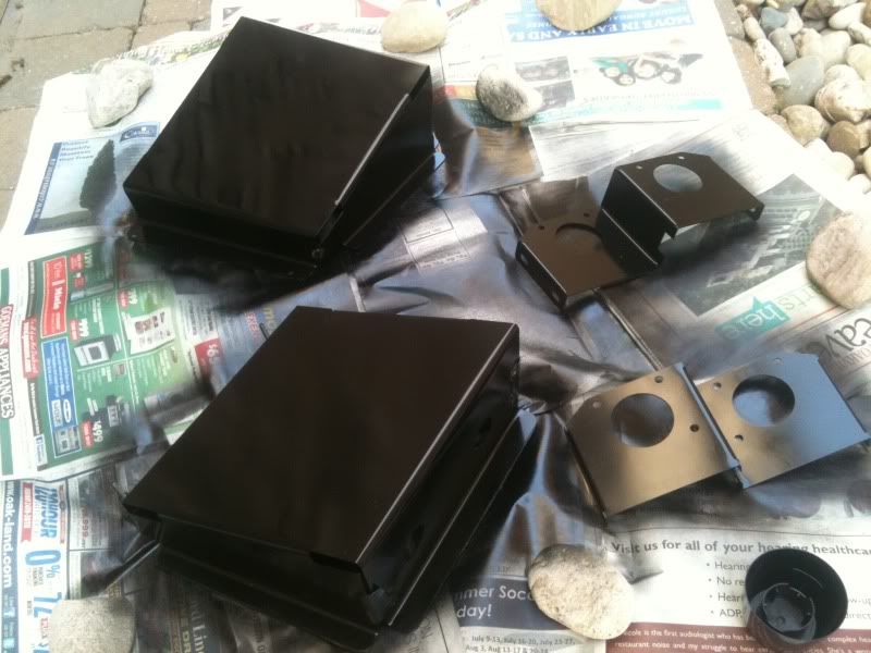

Good news. The bracket and bucket designs are "done" (quotations because I've measured a million times, but you never know)
I'm having 5 sets of headlights worth of them cut tomorrow. This weekend I'm going to try and have 5 sets of headlights ready. I obviously still have to order the projector lights for all of these, but I will accept deposits for that next week.

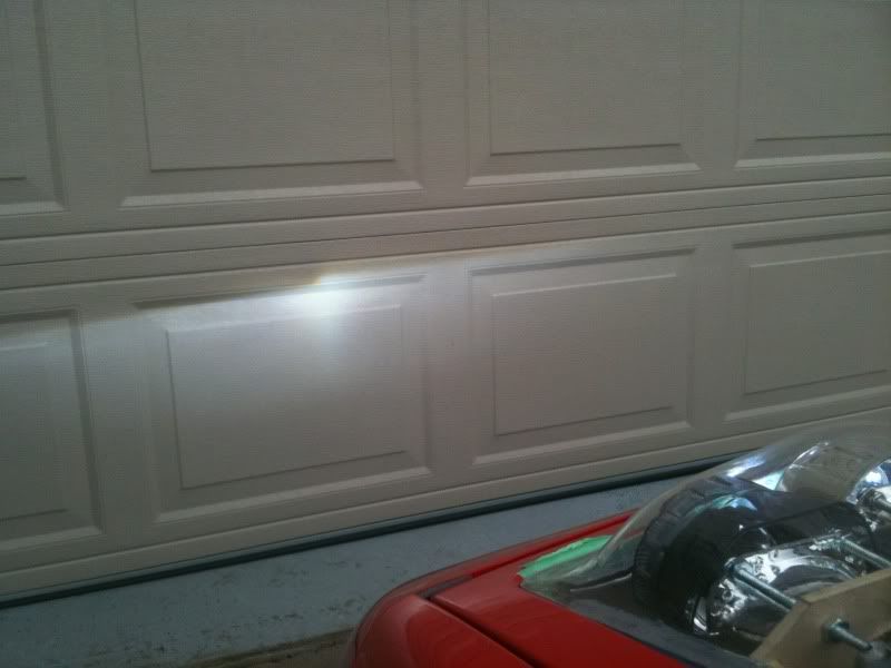

Almost there
The cutoff doesn't get too distorted with the lens on it. Turned out better than expected actually.
Bending up some brackets in bulk now!
So far so good!

From the bucket photos I just noticed a huge advantage to this design.
You can offer a better selection of fixtures than I ever could.
The bucket design allows multiple fixture options. However, I'm still constrained by size to a certain degree. The top of the lens acts a ceiling. If I go with too large of a projector, the majority of it will have to be placed too low to be effective. I'd have to make the lenses bubbled more.

Doing a final install on my car this weekend. Going to make sure everything works as planned!

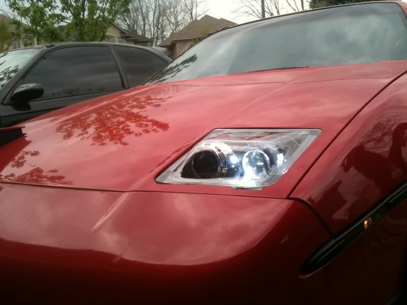

Got a whole bunch done today, but still a few adjustments to make + proper aiming and painting the lenses.
Also have to wire in a relay to run all of the lights at once.
Ignore the masking tape
I also need a better camera to capture the light without making it look like one big blob. Those are 8000K and 3000K bulbs.

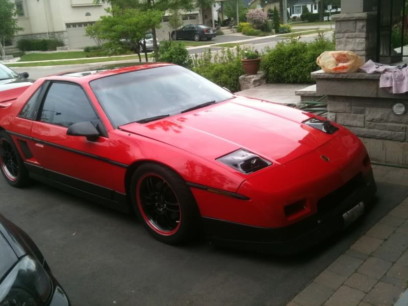

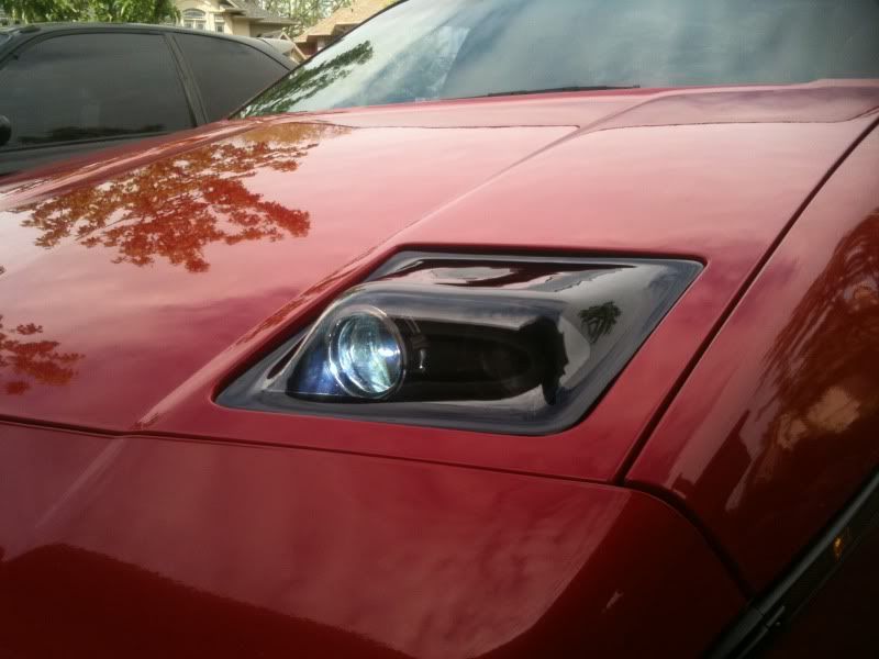

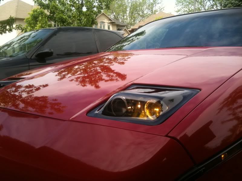

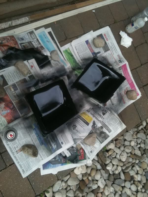

I finished up the install on my car today. Can't wait to test them out at night.
Painted up the lenses:
Installed the other side:
Tested out the lights and aimed them:
I still have to wire them so I can run 4 at a time. Right now I'm limited to 2 lights.
Enjoy!

Report this Post05-27-2012 09:32 PM Click Here to See the Profile for doublec4Send a Private Message to doublec4Edit/Delete MessageReply w/QuoteDirect Link to This Post
Thanks for the compliments again everyone.

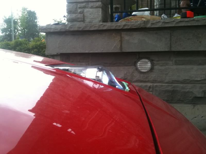

I will be testing them out at night soon and dialing in the aiming a bit better. I noticed in my parking garage that they were a bit off.
As for the concern about them sitting flush with the hood, you can further adjust them. I just put them in quickly today. The mounting holes are slotted.
I'm also happy to announce that the lenses don't fly off at highway speeds.. or faster. I can say that they are at least good until 100mph... experimental testing has not ventured higher than that yet.
One more picture tonight for good measure.
They look even better in person. I'm pretty stoked.
