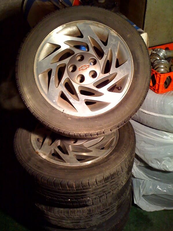

Well I could not take it! I went back out to the garage and cleaned all the crap off the top of the car. I installed the back tires, set her on the gorund and took her for a little spin around the neighborhood. All I can say is HOLY C^%&! She runs pretty good! I hope to get the exhuast done tomorrow!
What do you think of the rear wheels?
Now I got to clean the garage! I wonder what I'm going to put in there for the next project?

Report this Post02-26-2011 12:51 PM Click Here to See the Profile for Carver1Send a Private Message to Carver1Edit/Delete MessageReply w/QuoteDirect Link to This Post
the wheels are NICE!

Pat the wheels look great. I believe the stock tire size on the SE was a 215/60/14. Based on a tire comparator, a 235/45/16 is only 4mm taller than stock, and 9.3 in. wide on a 7 in wheel, vs 8.5 in wide on the stock 14. This would get you very close on the speedo also.

Looking great, Pat. I'm loving those wheels. Just my opinion, but I would keep larger tires in the back when the time comes to replace your tires.
Those rims with the larger tires have a wicked old-school muscle look to them (even without center caps ) particularly on a notchback.

Report this Post02-28-2011 09:23 PM Click Here to See the Profile for 1988holleyformulaSend a Private Message to 1988holleyformulaEdit/Delete MessageReply w/QuoteDirect Link to This Post
I'm actually a fan of the center caps that came with those wheels. They clean up that area nice, while still being able to view the lugs.
Take out the bowtie and put an arrowhead on them and it would look sweet! IMO
Love your bumperpad sleeper!
edit: doh, took too long finding my pictures. beat me! oh, and pretty sure they were only on the Z26 models of the years that you posted
Thanks for the pic - yes you are correct with the Z26 - I was thinking Z24 but was not exactly sure.
