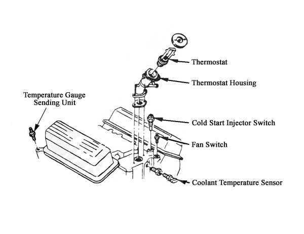

Since you have your meter out check the Coolant Temperature Sensor (CTS) and the MAT (Manifold Air Temperature) sensor conviently located on the air filter housing.
Measure the resistance from pin to pin on the CTS and the MAT and compare it to the following chart. See if it seems to be reading the correct temperatures.
