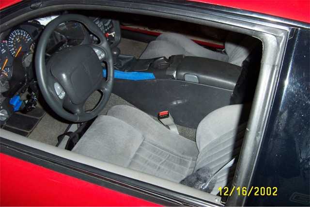

Thanks Roy. Even though I discovered the fuel gauge problem a month ago I haven't had a chance to fix it. Your instructions will help a lot.
In keeping in my tradition, I have bought a gas gauge off of ebay. Ironically it's from a 1980 Trans Am, although as you say, just about any gauge from 1965 on will work, as long as the needle moves the right way. Interestingly the 3rd gen Trans am deflects the wrong way and won't work.
I had a little setback this week as my temperature gauge stopped working. I thought loose wire behind the dash. No problem right...wrong. To make a long story short, I had an open develop somewhere in the wire between the ignition switch and C500.
I stopped my troubleshooting at that point and ran another wire from the gauge to C500. I might have damaged the orignal wire in the process of installing my console. I may never know what happened. In any case my temperature gauge is working again. One of the hazards of cutting and drilling I suppose.
I hope to get everything bolted down in their permanent locations this week. I have just about completed my environmental controls. I can tell you that even though they will work I'm not totally happy. The knobs are kind of sloppy and don't fit the shafts all that well. I will probably start working on a second set to replace these and hopefully it will turn out better.

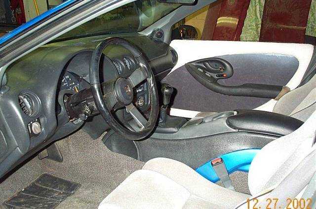

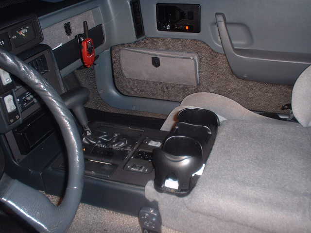

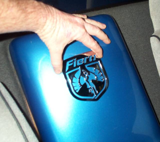

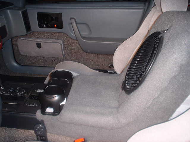

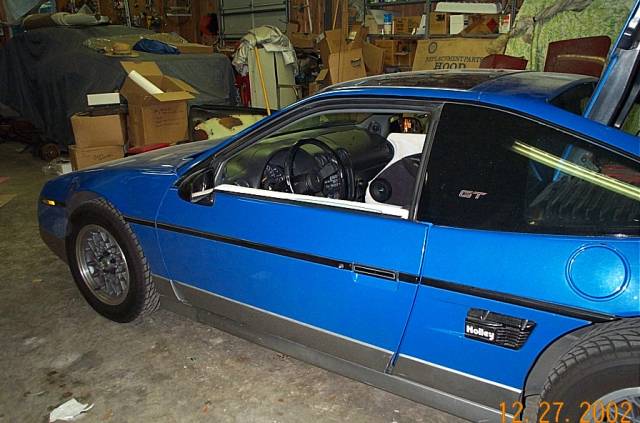

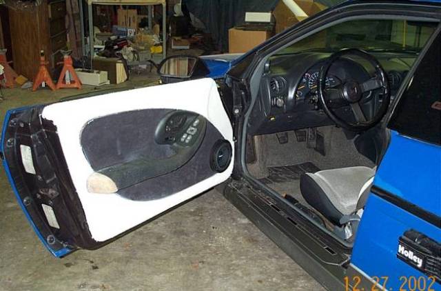

I thought it was time for a little update. The pictures below show the door panels with the sculpted foam (white part). It sticks out about 3/4" and is rounded like the Firebird panels. I'll try and get a better photo later. The black is an insert made of waterproof cardboard and will be covered is a contrasting color. All that's left is the vinyl upholstery and it'll be finished. I think I captured the essence of the Firebird interior. The last photo is a window view of the car. It really changes it's personality, doesn't it?
Roy :D

That interior is AWESOME!!
Your door panels came out great even before the vinyl is applied. Keep it coming.

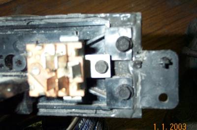

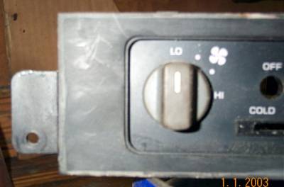

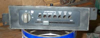

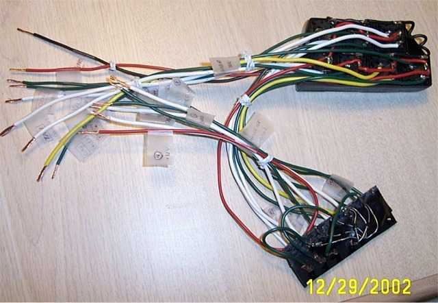

Here is an update on my progress. Not nearly as visually interesting as Roy's update today, but here is what I have been working on...
The environmental controls are another area Roy and I took different approaches. Roy used a 5 level switch, and I am using a single level switch and relays with a logic board to achieve the same effect.
This is mainly because my local electronics parts outlet did not have 5 level switches. Well it's turned out to be a big deal to get it built.
The other difference is that I am using the Fiero temperature control cable and modifying the firebird control knob to work with it. Roy used the Firebird cable and modified the fiero airbox.
The main reason I didn't do that is because I didn't get a firebird cable until after my dash was in and I didn't feel like pulling it out to install the cable, and I don't think it's long enough anyway.
The last difference is that I am using the rear defogger switch as an A/C compressor on/off switch. (Since I don't have a rear defogger the switch would not have been used.) The thing is though is that the firebird defogger is a momentary switch, so I needed something to convert it to an off/on switch. I started to do it electronically, but the circuit started to get very complicated with relays, transistors, capacitors and what not, so I decided to physically replace the switch with a alternate action on/off swtitch. I had just the perfect switch but I screwed it up during the intallation, so I need to get another one on monday and try again.
Last but not least, my single level switch was acting real sloppy because I didn't grind the shaft to the right diameter, so I got another switch today to start over and see if I can get it right.
I really thought this would all be behind me by now and get back to the fun stuff. but that's the breaks sometimes.
- Jonathan (JScott1)

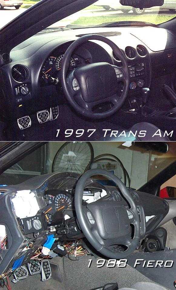

Just to keep this thread interesting, here another view of the dash

Those door panels are sweet. Here are my questions.
1. Can one use the Fiero climate controls if needed (Firebird climate control panels locally are made of unobtainium...)
2. Where does one purchase the foam for sculpting the molds for the computer cover and the door panels?
Thanks for the ideas, my Northstar Fiero will be totally modern now (once I finish it.)
1. Can one use the Fiero climate controls if needed (Firebird climate control panels locally are made of unobtainium...))
Of course it can be used but you'll need to come up with a way to mount it onto the Firebird dash. The Fiero control panels is more narrow. My first attempt was to do just that. My dash came with a stripped control panel (someone had already grabbed the knobs and the panel face) so I cut the out center of the panel and fastened the Fiero control panels to it then cut and fit the Fiero trim plate over the top to fill in the edges. It looked pretty good but once I figure out how to make the Firebird panel work I set it asside. I still have it and if your interested I'll take a couple of pictures to show you what I mean.
For the door panels I bought closed cell foam from a local upholstry supply store. I used mostly 1/4" (three layers) that cost about $8 per linear yard (54" wide).
The computer cover was sculpted out of stryrofoam that I bought from a craft store. I scupted, I covered it with masking tape as a barrior before applying the fiberglass resin. I gave a little more discriptive explanation of it earlier in the thread.
Roy

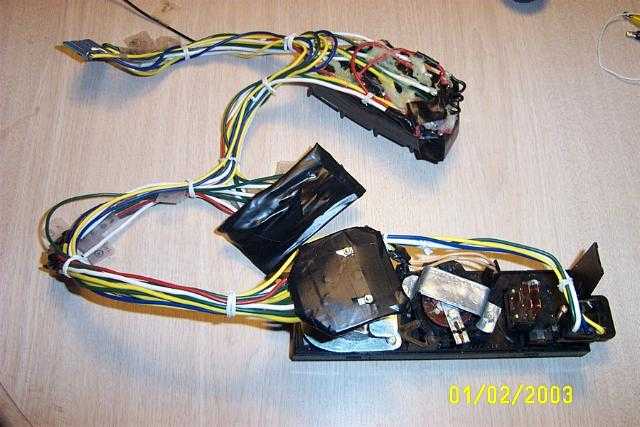

I finally finished my environmental controls. I must have spent 40 hours on this one thing alone. It should not have been that complicated but I had to repeat several things. I don't think I would recommend doing it this way.
First, I had to replace the rotary switch with a new one so that I could get a better fit from the knob to the shaft.
Then, the surplus relays that I used turned out to be normally closed and I thought they were normally open so everything was working backwards. I had to scrap those relays and start over.
Finally, the alternate action on/off switch for the compressor had to be replaced by another switch and it must have taken me 6 hours to get it mounted properly. I almost gave up on it, but now I can get cold A/C air on my feet, (something Pontiac didn't want us to have for some reason.) As a bonus it also doubles as a coolant fan switch.
Everything is getting bolted down now, and soon I should have pictures of the final assembly. Here is a preview of the center console, (which I painted to give it a chrome/aluminum look)

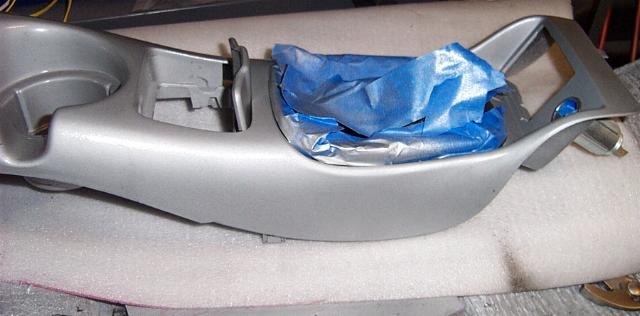

naski18 -- here are a few shoots of the modified Firebird control panel I made to accept the Fiero controls. To fasten Fiero controls to it I used some 3M plastic adheasive to build the corners then drilled it and used screws to make it secure. It could just as easily been glued directly to the panel itself. I removed the section from the middle of the old Fiero face plate and used it to cover the gap.
Sorry but, I don't have a shot of it installed. However, I did try it out and it looked OK. If I were to do it over again, I would mount everything a little farther out. The way it is now there is a gap between the Firebird bezel and the face plate. I built it before I had the Firebird bezel. Anyway, maybe it'll help to give you a few ideas.
To everyone else, thanks for the complements.

I am right in the middle of bolting everything into their final location...stay tuned for updates soon.
To keep this thread interesting, here is a comparison of my Firebird interior to the interior of my 97 Trans Am, (that I no longer own ) (Note the pedals on the Fiero are the exact same pedals from the TA.)

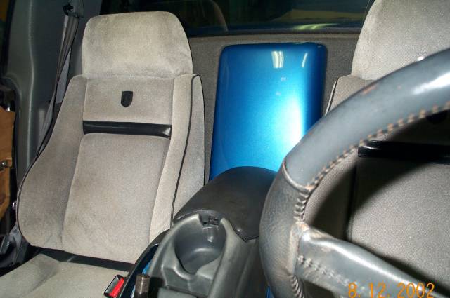

I've also seen that there is a bit of an issue with the center console. Well I'm a bit of an audiophile so I like the look of this center console from the FiberSmith.net and would start with this...
http://www.fibersmith.net/images/SUB1kalsmithdesign.JPG http://www.fibersmith.net/images/subboxinstalled.JPG http://www.fibersmith.net/images/subboxwithcover1.JPG
Now what to do about the shift area? I currently have no idea. Use the Firebird's and try to merge it with the console above somehow? Possibly. Doubt it. But when that is figured out, I found a really nice dual cupholder in AutoZone. You can pretty much drill through the bottom holes in it to mount it to anything. I have it in my car now and I love it!!! Hope I can get PIP to work...
This one is of the console me and a buddy of mine made. Not getting the sound we wanted so instead of redesigning, I'm getting the one I mentioned earlier.

Hey guys,
I just wanted to pass along a picture and a big THANKS to Fred (RAREW66) for the fantastic piece of artwork. And what a pleasure to deal with. Pure polished stainless steel. I'm going to mount on my new computer cover. What do you think? Way Cool, huh?
Here's a picture of the computer cover from a little farther away.

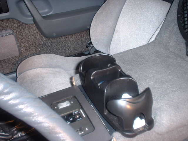

I was in the process of finding a prefect console for my car.Since I have switched to a 4spd tranny my shifter bezel does not look professional at all.Today I purchased a third gen shifter,glovebox console that I will be putting in.How narrow is the 4th gen console? I also have a back up consol from a 90' grand prix put it looks too narrow.
1986 Fiero SE
www.2m6performance.tk
Let me tell you what Melba Toast is packin' right here, alright. We got 411 Positrac outback, 750 double pumper Edelbrock intakes, bored over 30, 11 to 1 pop-up pistons, turbo-jet 390 horsepower. We're talkin' some fu*kin' muscle!

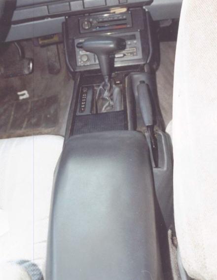

Heres what Im going for,I will be cutting away the stock Camaro radio surround and blend the console in with a mix of camaro/fiero parts.Those little heat vents will also be made functional
I choose the third gen console because the older corvette ones are just too expensive

Heres a shot of the t/a version i'll be going to a yard to pick this one up tommorow,then I can compare which one will work better right now Im thinking the T/A console is a better choice.
