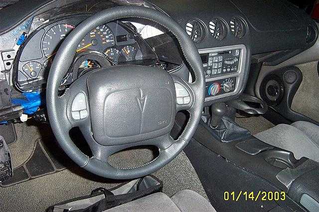

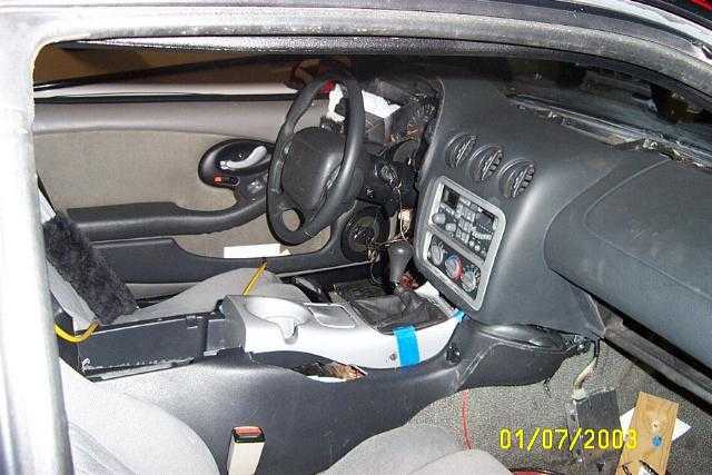

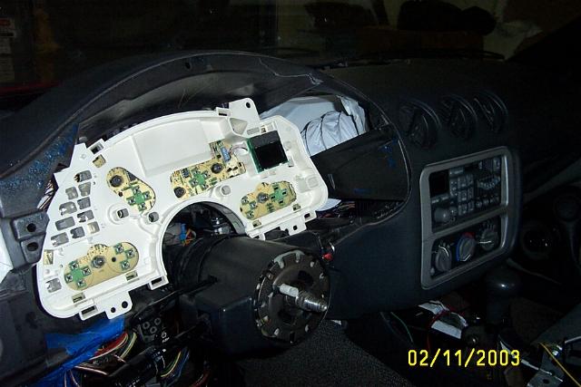

I was wondering if anyone was paying as close attention to my pictures as the Stinger spy photos. If so then they might wonder why this console piece is painted in the picture dated 1/7/2003:
But in the pic dated 1/14/2003 it is not:
What's up with that?

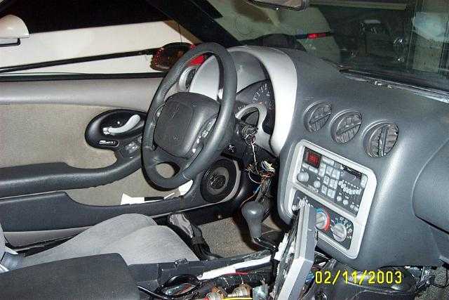

Report this Post01-26-2003 11:22 PM Click Here to See the Profile for jscott1Send a Private Message to jscott1Direct Link to This Post

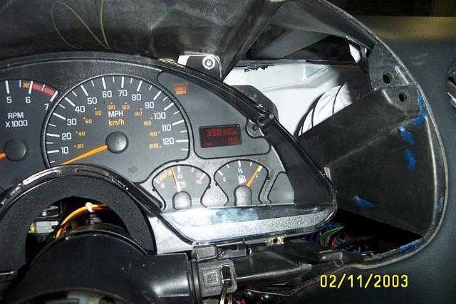

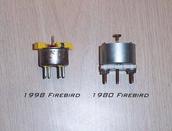

I finally got my gas gauge from a 1980 Firebird to go in my 1998 cluster for my 1988 Fiero. It will require a little bit of surgery to get it installed, but that is the last major task I have before completing all the cosmetic changes.

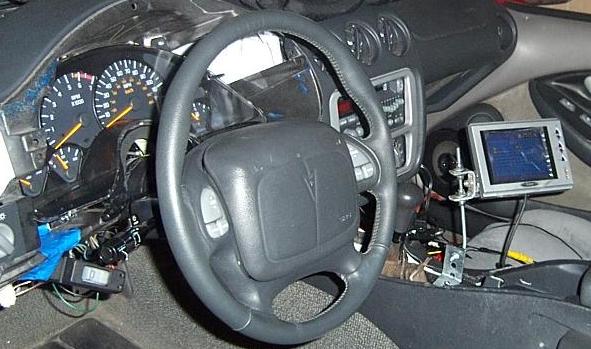

Here is a sneak preview if what's coming next:

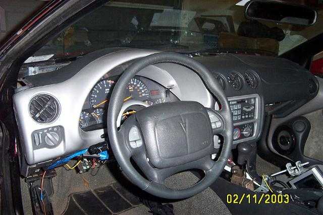

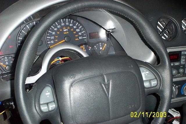

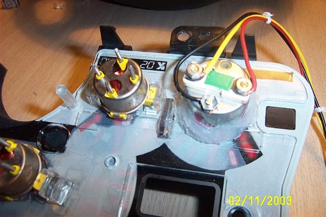

I thought I would never get the fuel gauge installed but it's finally done!
I had to remove the faceplate of the gauges and then I used clear silicone RTV to attach the 1980 Firebird gauge directly to the faceplate. I wired it directly to the sender, completely bypassing the 4th gen f-body circuit.
Today's result:
By the way, I will be bringing Proud-2 to the Florida Fiero Weekend in Daytona next month so I am rushing to get to a convenient stopping point in my conversion.
- Jonathan (JScott1)
If you find my advice useful, then please give me a positive rating, thanks...
[This message has been edited by jscott1 (edited 02-11-2003).]

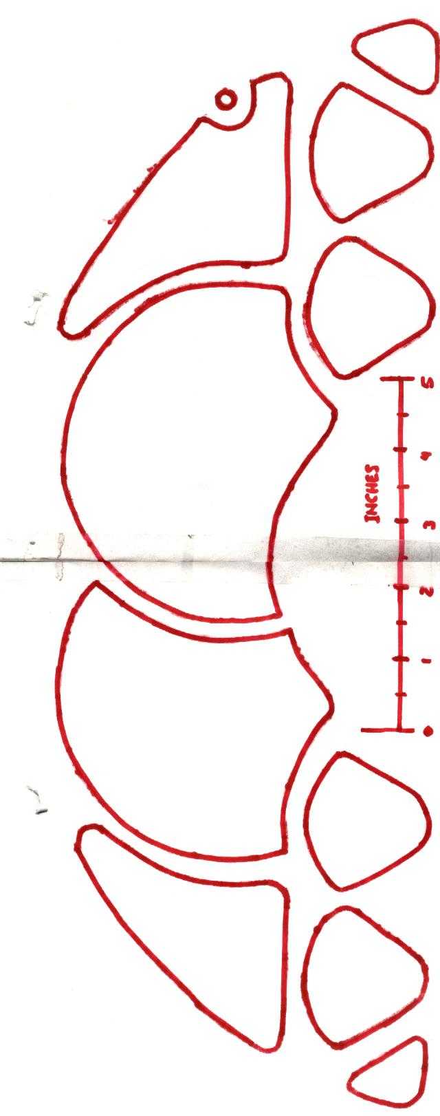

In keping a promise to Mrfixit58 (Roy), I traced the outline of the overlay for the later version Firebird gauge.
Here is the trace for anybody that's interested. (you may have to resize)

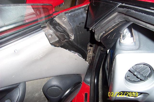

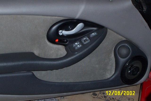

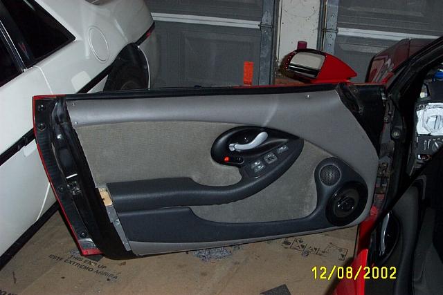

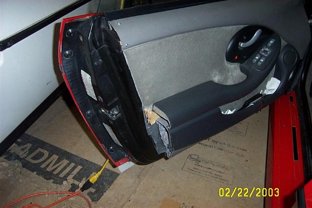

Hey JScott. How hard was it to do your door panels? I know I don't have the skills yet to do the dash. But I would like to at least do the doors. I think it will add a nicer look and feel to the interior with the stock dash.
jscott1
Posts: 21676
From: Houston, TX , USA
Feedback score:    (15)
Total ratings: 415
Report this Post02-22-2003 01:31 PM Click Here to See the Profile for jscott1Send a Private Message to jscott1Direct Link to This Post
Originally posted by jscott1:
The door panels are one of the trickier areas. I chose to use Firebird panels and then trim off the front and rear portions and then adapt them to the Fiero. This also involves new door handles, window and door lock switches, and speakers. It also replaces the inner dew wipes.
What I haven't done yet is to make the ends "pretty" where I cut them off. A lot of people are concerned about that but I am confident I can make it work.
Roy decided to take a different path and use the Fiero door panel and smooth it out and attach the firebird handle and latch. Then cover it with vinyl. That sounded like more work to me, but his results should be about the same or better than mine.
There are pros and cons to each method, you have to decide which is better. You can look at the pictures to judge which looks better to you.
Jonathan (JScott1)
You can see from this flashback that the door panels are about as involved as the dash if not more. Roy (MrFixit58) decided not to mess with the Firebird door panels. Initially I thought his method was more involved yet he is finished and I am still working on mine
Up until now I have always cleverly photographed my door panels such that you didn't see the cut off ends. The reason is that up until now I have had other things with higher priority to finish before I had time to make the ends pretty. But that's what I'm about to start working on right now. I feel pretty confident I can make them look visually pleasing.

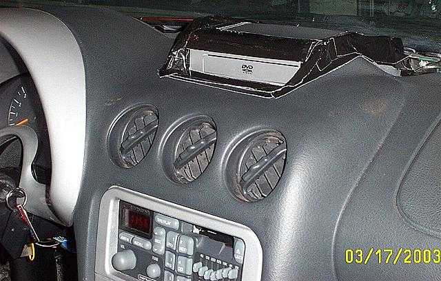

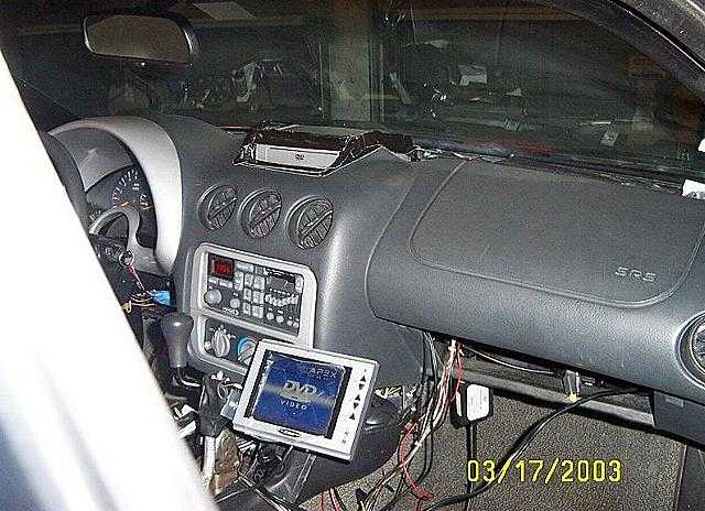

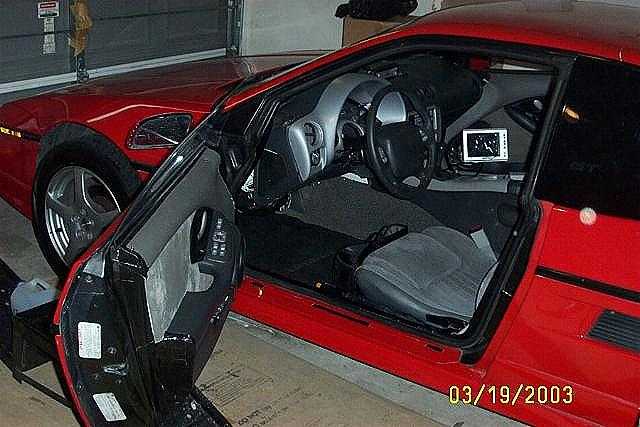

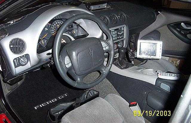

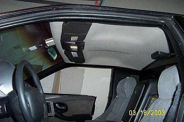

Whew...just "finished" my mad scramble to get ready for Daytona this weekend.
In the last few days I had left I decided I would rather have working DVD so some things fell off the plate. Like the panel between the dash and the windshield. I'm sorry to say that the prototype is installed and not the final piece. The paint is still drying on some of the parts that I installed.
There are quite a few pieces held together with duct tape and I don't think it's going to win any awards this way but that's okay too. But at least I have a headliner for the first time in 6 months
I'm just really glad to be at a stopping point and can enjoy the car for the weekend. See you in Daytona!!
