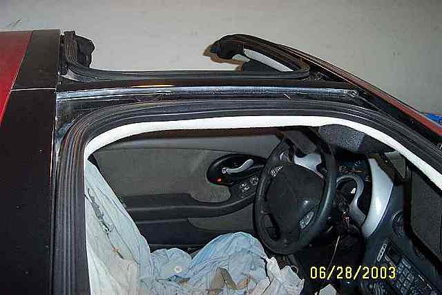

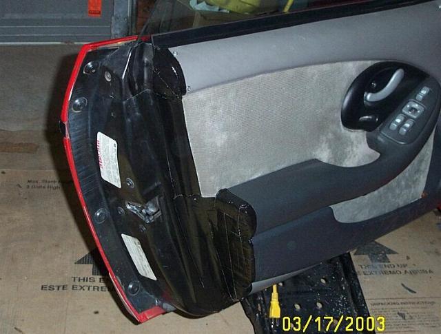

looks like you figured out somn for those dooes.. do you have some closeups of them?? I am more than interested in how you decided to do the doors.
It looks like you fabricated some trim plates and put them on. But then again, this monitor sucks that I am on right now, so its hard to tell if you really did anything to the doors yet.

Hey Soup,
I did form end caps, (of a sort) for the doors...for the trip to Daytona I covered the ends with Black Duct Tape. From about 6 feet away it doesn't look too bad. The real end caps will look a lot like that, I just haven't had time to make them yet.

Mcaanda, Welcome to the forum and to the official Firebird Interior swap thread. If you look at any recent post for Mrfixit58, in his signature he has a link to the tech tech section where he talks in detail about his swap.
My swap is not completed yet, and since I am, (so far as I know) the only person to attempt the Firebird door panels, this thread contains all there is to know about it.
In a nutshell you have to trim about a foot off the rear of the panel a triangular section off the front and relocate the door latch mechanism. The upper and lower dimensions are close enough that you don't have to do anything. I'll be glad to help in any way that I can.

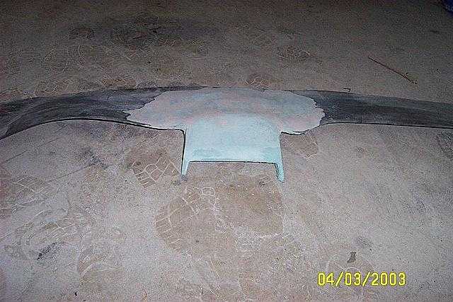

Nothing to report on the door panels, but for those who saw my car at Daytona recall that I was only days into my DVD install on top of the dash...
The temporary cover consisted of cardboard and black duct tape. Well I have just about completed the custom piece to close out the area on the top of the dash.
It should be painted and installed in the next couple of days. The door panels are next.

That looks pretty good for someone who's never done something like that before. You may have a little problem at the edges and may need to feather it some more. Did you rough the plastic up real good before applying the filler so it would hold better? Are you going to paint it yourself of have someone else do it? I recommend using a 2K high build primer and blocking the area with 220 grit to make it smooth and level. Then hit it again with the primer and 400 grit before painting.

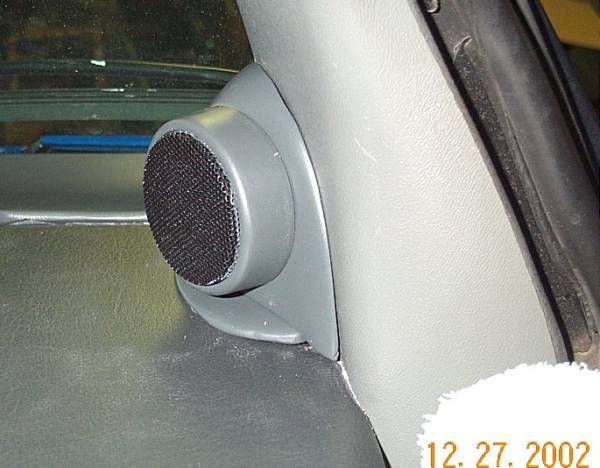

Thanks Roy for the sanding and painting tips. The only way to get the custom shape up top was to go with fiberglass so I had to give it a try. I started with the stock Firebird panel and hand laid the fiberglass over it. I roughted it with 40 grit so it should stick pretty good. Also recall that the stock piece has the vent in this area, so in effect the fiberglass is sandwiched on top and bottom so it is very strong. I will add the stock fiero defroster vent in the stock location from an old fiero dash.
Yeah I know I have a lot more sanding before I can even think about priming. I am still working on the little ears on either end, and I may add tweeters on the a-pillars to hold them down,(even thought I already have dual tweeters up front). I figure if this doesn't work I can always try again on another piece.

... and I may add tweeters on the a-pillars to hold them down,(even thought I already have dual tweeters up front). ...
[This message has been edited by jscott1 (edited 04-04-2003).]
Now, where did you come up with that idea?
Keep up the good job,
Roy

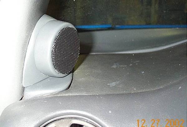

Yeah Roy I forgot to give you credit for the tweeter idea. You and I know it was your idea but for the general reader I don't want to mislead them into thinking I stole your idea.
The other thought I had was to modify the a-pillar trim to incorporate a gauge or switch pod like PBJ is doing. Or I may come up with something original

soup
Posts: 1571
Registered: Nov 2001
Total ratings: 63
Report this Post05-31-2003 08:16 PM Click Here to See the Profile for soupClick Here to visit soup's HomePageClick Here to Email soupSend a Private Message to soupDirect Link to This Post
I have no idea when memorial day weekend is, but I imagine it is past, so... anything to report
I am real interested to see the door panels, and how you capped them.

Anyway, that was last weekend and that was my weekend to install the T-tops. Despite the warnings from MrFixit58 I started a new project before finishing the old one, but they look good.
Now I have a whole new slug of work to get completed before I can turn my attention back to the door panels. I am in the middle of painting the interior trim for the T-Top, then I have to re-do the headliner. Put the quarter windows back on and then I can jump back in where I left off.
The fiberglass filler piece for my dash is nearly complete. After that experience I am planning to make the end caps for the door out of fiberglass as well.

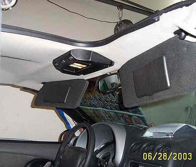

I did not look at any other cars. I actually bought a firebird dash thinking that I was going to use it as the basis for a custom dash. To my surprise it fit almost perfectly so I decided to do the whole firebird interior. Unknown to me at the time was that MrFixit58 was working on the same thing. As far as I know we were the first to try it.
Here's a couple of photos from my recent headliner installation:
