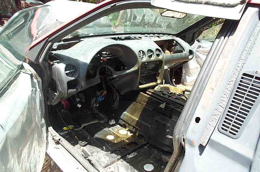

Any Idea who makes this dash?
And another pic...
[This message has been edited by Silver85GT (edited 11-04-2002).]
Gary W
Posts: 1092
From: Cape Coral, FL
Report this Post11-04-2002 10:28 PM Click Here to See the Profile for Gary WSend a Private Message to Gary WDirect Link to This Post
That looks like Pisa's wraparound dash. $1200, last time I checked.

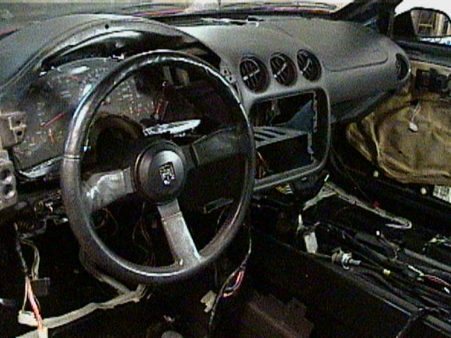

Report this Post11-06-2002 10:05 PM Click Here to See the Profile for jscott1Send a Private Message to jscott1Direct Link to This Post
No need to make a ring, just fabricate some brackets and bolt it up.

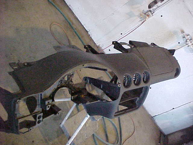

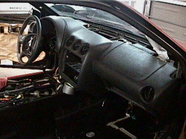

Thanks, I will start a separate thread at some point but Here are some teasers of what it will look like

No Problem, I'll post updates to this thread, but I may need some help keeping it active so it doesn't get buried so deep I can't find it.
Phase one of my project is the dash and the door panels. But also involved is a color change from beechwood to gray and black.
My goal for completion of phase one is by end of the calendar year.
Subject is an Red 88GT, (see sig I can't post pics from where I am now)

Report this Post11-07-2002 01:31 PM Click Here to See the Profile for jscott1Send a Private Message to jscott1Direct Link to This Post

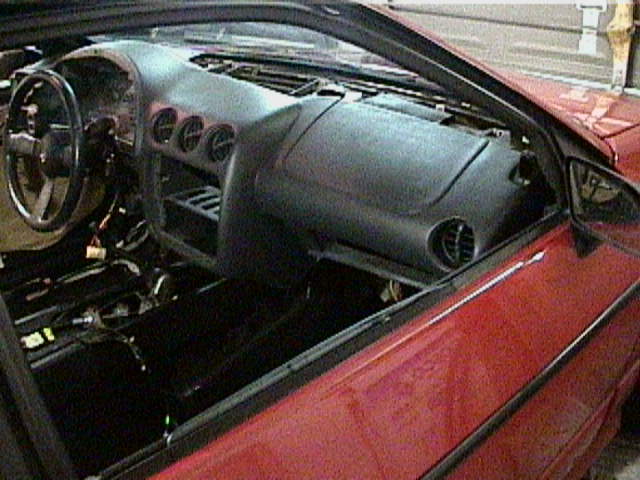

Hey Smooth, thanks for the good words.
Side to side the Firebird dash is about 2 inches wider than the Fiero Dash. But, (and this is a big but) the Firebird dash is designed to go underneath the A pillar trim and the Fiero dash stops before it gets to the A pillar trim.n
Once you factor that in the side to side fit is nearly perfect. The edge of the dash rests comfortably up against the edge of the interior.

The front face of the dash extends maybe 4 to 6 inches farther out into the passenger area than the stock Fiero. But that is typical for most modern cars. With the seat pushed back there should be ample leg room, since it doesn't affect the actual amount that you can outstretch your legs, only knee space.
But it's hard to know for sure because I haven't installed the seats yet. I'll keep you posted.

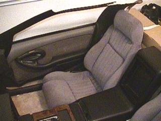

Report this Post11-08-2002 12:51 AM Click Here to See the Profile for jscott1Send a Private Message to jscott1Direct Link to This Post

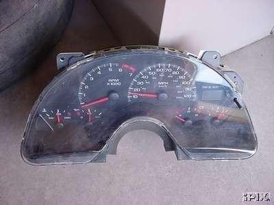

Originally posted by Wipe0ut:
Gah! Jscott1 your interior is the best I've seen yet. I love the gauges you used; what are they? Would you ever be willing to market your interior as a kit?
My gauges are standard F-body gauges
I am building a custom harness to interface the three Fiero Gauge connectors to the single F-body connector. I will share the pin mapping when it's complete.
That's how this whole thing began. I started out to build a custom dash with F-body gauges and somewhere along the way I decided to do the whole F-body interior.
Then I found this
And discovered that it was nearly a perfect fit
So then I got these
And installed them
I'll get more pics of the dash after I complete the wiring for the gauges.

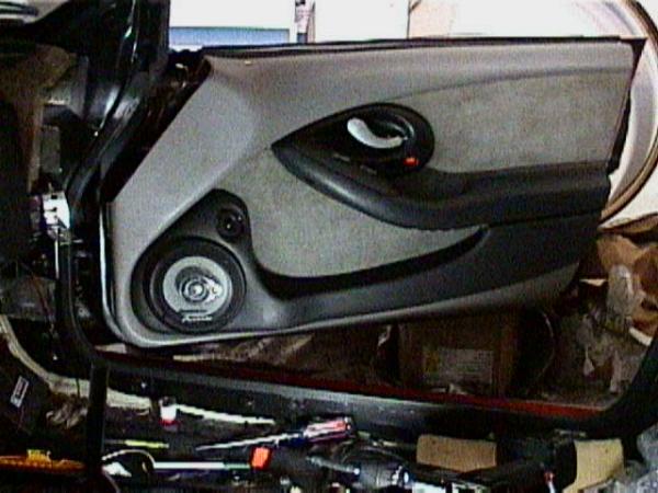

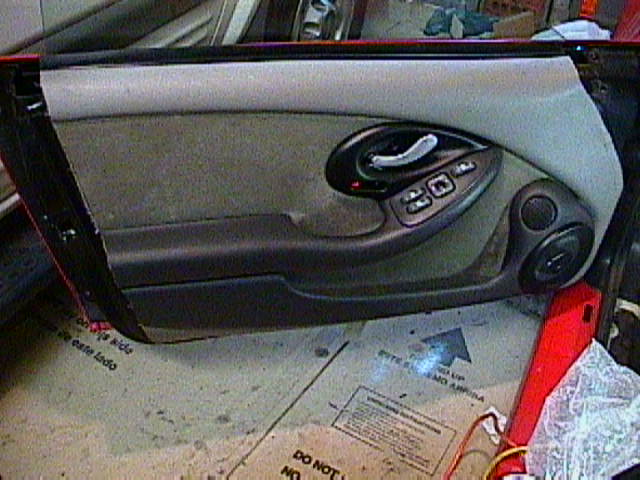

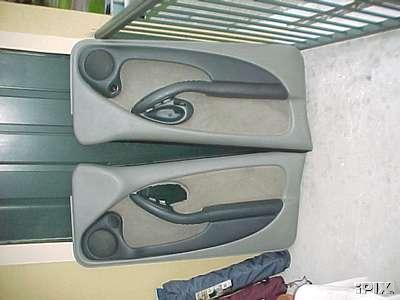

Johnathon,
The door panels look awesome. Looks like you just trimmed off the front upper corner and sliced off the back to size. Is that really all you had to do? Have you actually got the door latches hooked up to the Fiero Hardware in stock location?
I just realised mine being manual windows probably won't work with the panels your using. Dang it...
Give a walkthru of how you went about fitting them and how your dealing with areas you had to cut off... Please :-)

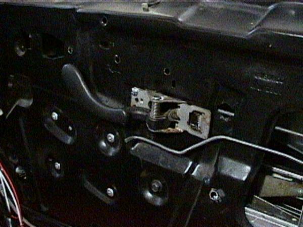

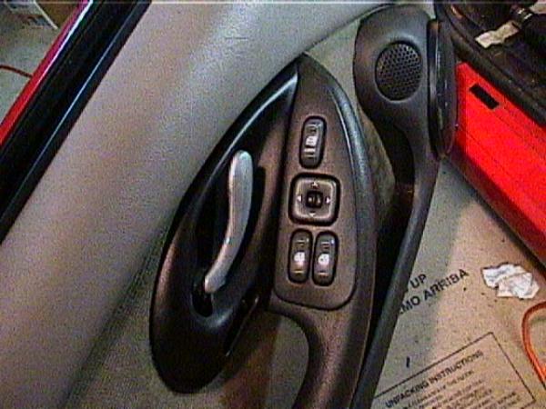

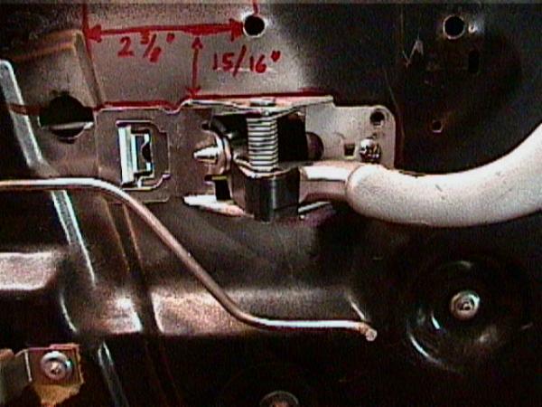

Trimming of the front corner and slicing the rear to size is the gist of it, but it's a tad more involved than that.
The Fiero door mechanism is in the wrong position to fit in the F-body panels. I removed the Fiero hardware and installed the F-body hardware in a new location, and shortened the linkage.
Also the old handle brackets need to be removed and the f-body panel trimed and new attach points drilled.
I did the driver's side first and referenced from that to do the passenger
I also had to get F-body window and door lock switches, and since the Fiero only has one set I had to make a new harness to get power to both the driver's and passenger's side. The stock harness was actually long enough to be relocated from the center to the driver's door.
Sounds harder than it really is. I could do it in a few hours now that I know how to do it. As for how I'm dealing with the ends that were cut off I am surprised how often I am asked that. It simply needs to be closed out in a visually pleasing way. I haven't done that yet.
By the way, if your Fiero has manual windows, this would be a good time to upgrade. I installed power windows in my coupe and it's not that hard. Some people suggest swapping the whole door but in this case you are more than halfway there.

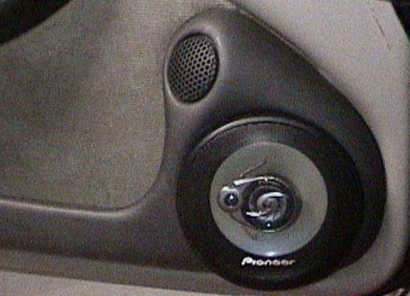

By the way no one has asked yet but my speakers are Pioneer TS-A1667 200 watt speakers mounted external to the panel(to make room for the huge magnet.) The sound quality exceeded my expectations.
Stay tuned for more

Ok, Ok,... I guess it's about time I come out of hiding on this. I'm also installing the Firebird dash. Jonathan (jscott1) and I have been communicating back and forth on this topic for several months now. We've shared a lot of ideas but are taking a little different apporach to the project. He is attempting to install the dash without cutting any sheet metal while I feel free to boldly hack away with a sawsall.
I'm including a couple of pictures of my project-in-progress. I'm doing all the hack-work on a chassis I've dubed "the mule". It was a badly rear-ended car that I stripped and was bound for the scrap yard before this experiment. After I'm satisfied that it'll all work, my blue 87 GT will be converted. My target date for this is over the Thanksgiving holiday. If you like, I'll bring you along for the ride.
I have alot more pictures detailing my progress that I'll be sharing. I've already completed the dash filler and am well on the way with my custom door panels. What I hope to do is build a web site to detail the build-up.

As he said we have been communicating for the last several months, (alomst daily) after we accidently discovered that we were both working on Firebird interior retrofits.
Even though our approadches are different the goal is the same, so it's interesting to see different solutions to the same problems.
We had not planned to go public until further along towards completion but I saw some pointed and direct questions in this thread that I couldn't resist answering and therfore revealed my secret project.
As for cost, I bought all my parts off the internet and had them shipped to me, (at higher cost) I haven't totalled it all up, I my guess is that if you got the dash, switches and door panels locally you could get the entire kit for less than $500. Maybe a lot less if you are lucky at the junkyard, (afterall there are 10 years worth of 4th gen f-body parts out there).
After Roy and I finish documenting the build up, some enterprising person would easily put a kit together for the masses.

For the late comers to the thread and can't see the old posted images...I am retrofitting a firebird interior into my 88GT

JS, could you post the pics of your door panels, I am assuming from what I read that you have them mounted as well?

As I said Roy and I have been communicating almost daily so I know what he's done. He had a bit of a head start on me, but since I'm skipping the "mule" stage I hope to catch up and hopefully have the world's first fully operational Firebird retrofitted Fiero interior. (That's a mouthful)
Due to the USA Image server going down I have re-posted the images on the NL image server. Thanks again to Cliff for letting us post images again, and at 640 x 480 no less!!!
