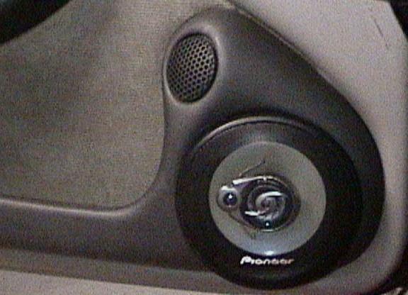

Definitely do door speakers
Mine sound way better than I expected. There are about a billion 6 1/2" round speakers to choose from and they sound great. It would be more work to get them in the Firebird dash since it's not designed for them.
Here's a photo of my latest progress (same as on page 4 but now you don't have to page back there)

Yup, plus by locating the speakers in the
door gives better imaging IMHO

Now I could always keep the door speakers, and also have the dash speakers. What about that as well?
Let people do the speakers themselves. If they are that much af a stereo buff that the door panels, and B pillars arent enough, then I am sure they can simply cut a hole in the fiberglass before getting it upholstered.
If you start asking people about what size and stuff to put it, you will get every different answer you can think of. Make it basic, this install will take a lot of fabrication anyways, so if they can do this install, they can cut holes for speakers.

The filler piece that I made in not wide enough to use even the stock 4x10 speakers. My Firebird dash is fastened to the windshield flange lip and is only about 4-5" wide in the edges. You could cut a hole in that area but you'd need to add additional support to reduce the risk of breaking the filler during installation or removal. Making dash speaker placement even more difficult is my filler piece is not flat. There is a bulge behind the gauge housing tht smooths the transition from the dash to the bottom of the windshield.
I am putting 5 1/4" speakers in the doors because, for now, I'm not using the Firebird speaker housing and the 6 1/2" speakers were too deep to mount flush. I can upgrade later if I can adapt the Firebitd speaker housings but I may wait until I have a plan. Remember, I'm remaking the Fiero door panels to look simular to the Firebird but not exactly.
I have toyed with the idea of placing 3" mid range speakers in the corners of the filler panel. The 5 1/4" speakers are modular so another idea is to place the tweeters up on the filler or, if there is enough room, on the a-piller trim.

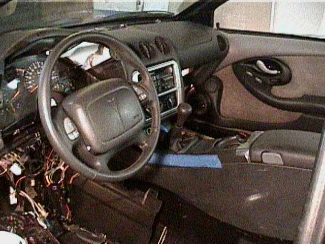

it's tight but it isn't horrible. As long as you don't pinch your fingers when shifting it is ok
edit: I was talking about the pic on page 4 of the shifter
I have been trying to figure out why you would want to keep the dash speakers? If the goal is to modernize the interior then dash speakers are definietly out of style.
Conventional wisdom is that the doors are the best place for imaging reasons. Tweeters can be up high like on the A pillar or as in the Firebird panel still on the door but up firing. Notice that I have dual tweeters, (on the main speakers and in the panel) That may be why my speakers sound better than I expected.
If the reason you want dash speakers is because you don't want to run the wires to the doors, then I say that you will be running wires anyway, what's another pair?
Lastly I have something else in mind for the spot on the driver's side dash, and I can't tell you what it is, but it's initials are H.U.D.

Do you have a grille for those door speakers? I'd be worried about a careless passenger kicking the speakers in. Careless people are always smacking my door panels with their dirty feet!

Swanthog - My speakers do have grills on them. From the angle that they were photographed they appear transparent.

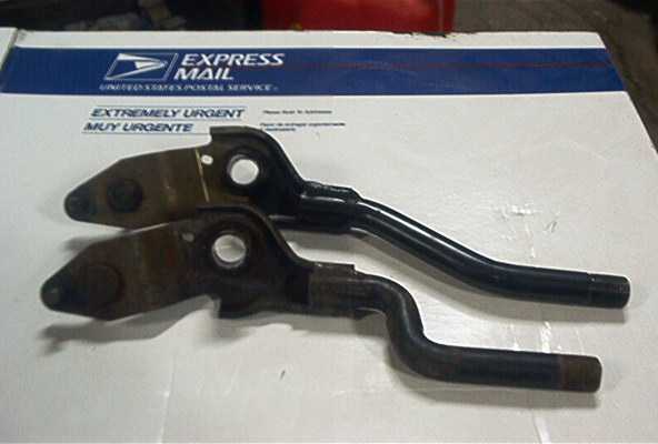

thatguyfubu - If you have any pics of the '84 shifter I would like to see them. Especially if you have a shot that shows the comparison between 84 and later years.

that shifter looks like it has plenty of room, but would the dash fit with an auto trans?

That's a good question. I think the auto shifter goes more forward than the manual.
I have a manual shift console in my coupe (which is an auto) and I had to notch the boot ring by about a half inch to allow the shifter to go into "park".
It may be that autos that get converted to "Trans Fieros" will need the dash mounted more forward than what I have done similar to what Mrfixit58 (Roy) did.
Roy can provide more details of what he did to get the more forward mounting, but basically it involves cuting the supports for the steering column.

Originally posted by jscott1:
A short shifter with an angle on it would be better...does anyone have a picture of the '84 shifter? it might be better
I'll try to remember to take my camera to the shop tomorrow.
PM me your mailing addy, and I'll send one your way if you want to play with one.
Don't want nothing for it, I have a bunch of them taking up space.

Heres the 84 shifter next to a 5 spd shifter.
The 84 shifter is in the foreground

Although the bend in the 84 shifter is much more ratical than the 5-speed, the off-set looks the same. With them laying parallel, look at the distance between the bottom of the shifters and compare it to the distance at the top. It's almost, if not exactly, the same.
Roy

I don't know Roy, from the pic above the '84 appears shorter. Even if it's not, the vertical portion appears longer and it could be cut and rethreaded. I would like to try the 84 shifter just to see if it works better.

Yea, it does look about 3/4" shorter. But the offset looks simular. If your trying to reposition the shifter, have you considered haveing it heated and bent?
Roy

The 84 shifter is definetly shorter by almost an inch. Hard to tell on the angle of my picture.
mrfixit is right, after examining them side by side today, the off set is pretty close. I do believe the 84 has a little more offset, but it is close.
jscott1, I will send you a stock 84 shifter, and also I can make one with what ever offset, and heigth that you want.
It will be treaded on the end. What I do is cut the weld holding the shaft to the pivot assembly, and do the shortning / reworking of shape on that end, then reweld it and paint so that it looks stock.
I'd like to do one for your car, to see if we can figure out something more asthetically (sp) pleasing.
Maybe even angle the upper portion of the shifter ahead, so that it doesn't lay back so far when in 2nd, 4th & R.
