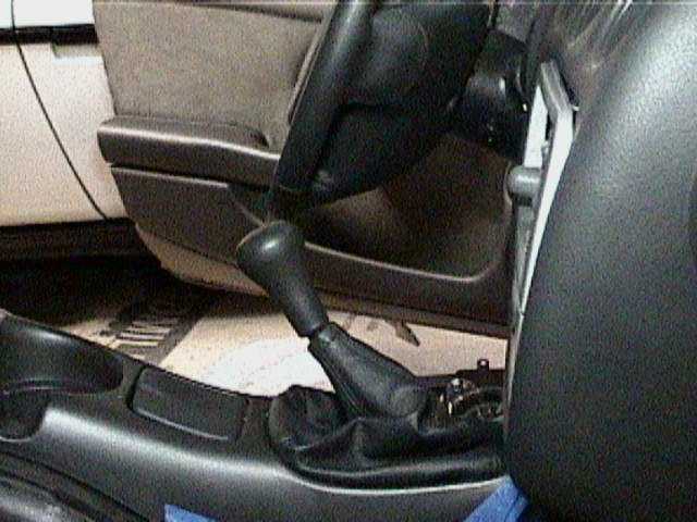

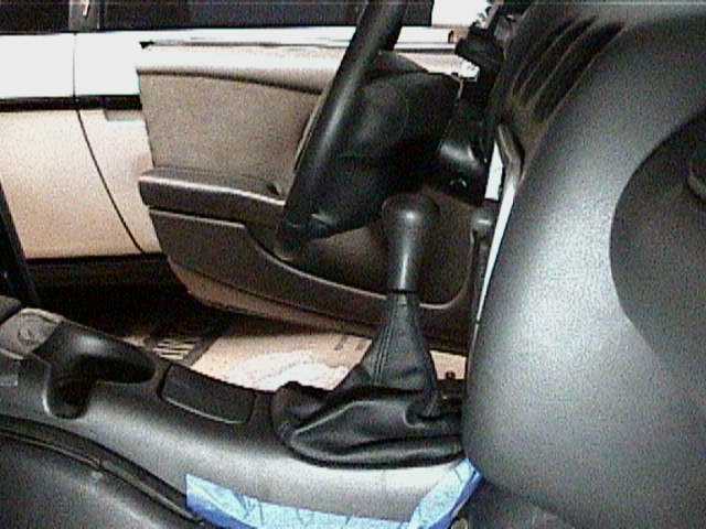

Here's the test mule with the dash, dash filler and the console in place. It looks like it belongs there.

DECENT!!!
man, that looks nice... I have a feeling this will suddenly become a very common swap!

HOly moly, keep this thing up! That looks great!!
Screw the 300Zx, why spend 2000 when you can get a just as nice lookin firebird one for 200 bucks...hope it's not too complicated

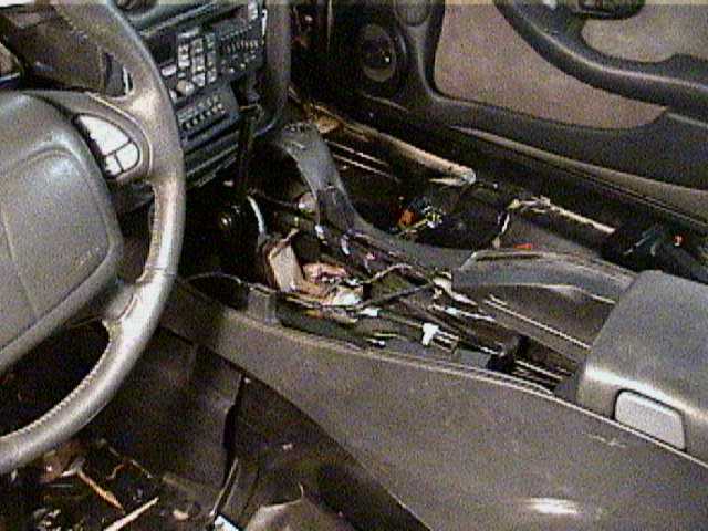

AnzFiero - That's the beauty of this swap, the parts are cheap and the results can be impressive.
stevenrossi - The stock Fiero radio will work. So will any GM din and a half radio. I selected a Firebird cassette because I wanted something cheap that worked with the steering wheel controls. I didn't want a GM CD player because I am custom mounting a DVD player in TBD location.
I have not cut any structure at all. That is the difference between my method and mrfixit58, (Roy) But I am limited on the dash placement, but I think it works better with the firebird door panels.
The steering wheel is stritcly optional. If you look a few pages back I posted a pic with the fiero steering wheel still in-place. It doesn't look bad, but I wanted the complete Firebird look.
The gauges are pretty easy with the exception of the gas gauge with resolution still pending on that.
The environmental controls will be modified Firebird controls. The vacuum switch will be replaced by an electric switch. Both Roy and I are still working on our switches.
8ball - the rounded part of the dash is maybe an inch higher than the stock fiero. The level part is about the same. Unless you are currently driving by looking through the steering wheel, it shouldn't be a problem.
mrfixit58's dash does sit maybe an inch closer to the windshield and makes the center console integration with the shifter easier, but I think I have a design solution that will work as well. Here is a first look at that.
What you are seeing is probably not the final placement of the console. It will probably have to be further forward, but I won't know until I get the trim piece with the shift boot tomorrow.

Originally posted by wpgfiero:
that looks sweet, but I was just wondering what goes on the upright part between the seats? I see the armrest part but what covers the part of the wall between the seats? heres the pic im talking about: https://www.fiero.nl/uploads/imgs2003/Console13.JPG
After posting that picture I realized that the console is not going to work in that location. It needs to be about 3 inches further forward. To confirm the console fitment I spent about 30 minutes sitting in a brand new 2002 Collector's Edition Trans Am at the dealership, (probably the last brand new Trans Am I will ever sit in )
Anyway To get this further forward console placement I am going to have to cut the metal supports on the Fiero over the gas tank. I have come to the conclusion that there is no other way to make the Firebird console work without significantly changing the Firebird console.
All that to say that I can probably put my computer back in the center and still use what's left of the Fiero console as a cover. As a rule I worry about the structural/mechanical, and electrical aspects of the swap first then the cosmetic things last. I consider the piece in the middle to be cosmetic.
I hope to have some pictures of the new fitment of the console before the weekend is over. And also I have put the stock shifter back on in place of Rodney's short shifter. I think it will work better since it has a slight angle to the rear. If only it wasn't so dang tall.

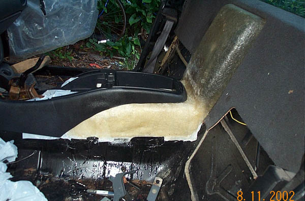

To hide that area, I built a cover out of fiberglass. I combined it with a cover for the portion of the tunnel that the Firebird console won't cover. I made the form out o stryrofoam and covered it with masking tape as a barrier between the foam and the resin. When set, the foam was removed and the tape just peeled off. The fiberglass won't stick to masking tape.
Hope this helps,
Roy

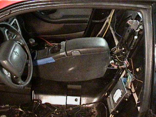

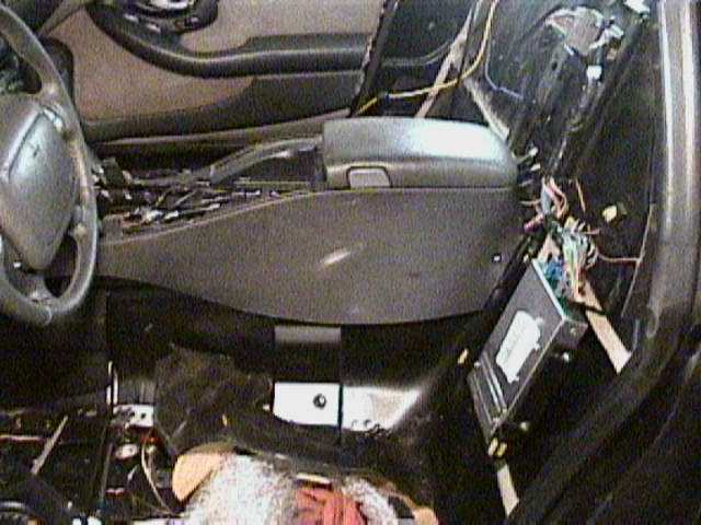

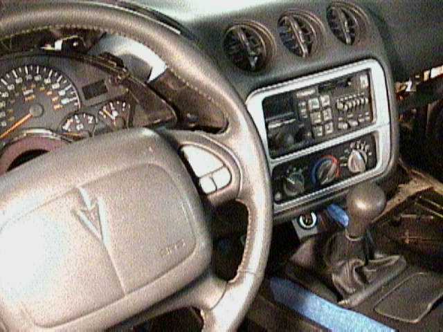

Report this Post11-17-2002 11:45 PM Click Here to See the Profile for jscott1Send a Private Message to jscott1Direct Link to This Post
After a whole weekend of cutting I was able to slap everything back together for another fit check of the console. There is still some final adjustments to make but it looks like it's going to work in this location.
I'm still deciding whether or not to put the computer back in the center. We'll see when I trim the Fiero console to use as a cover.
I still have to make the environmental controls. They are just standing in for the photo opportunity. But I'd say I made some progress for the weekend.
Stay tuned for more.
Jonathan (JScott1)
Formula88
Posts: 53788
From: Raleigh NC
Total ratings: 554
Report this Post11-17-2002 11:50 PM Click Here to See the Profile for Formula88Send a Private Message to Formula88Direct Link to This Post
Man, that shifter looks awfully close to the dashboard.
Not really. Of course the shifter is in the same place it always was, it's the dashboard that's gotten closer. The shifter is basically in the same relative position to the dash as in the Firebird. Maybe an inch closer in mine versus Roy's but since I changed back to stock shifter there is plenty of room.

Jonathan, could you do me a huge favor? Next time you take pictures, can you put the shifter in first gear and show the distance you still have between the console and the shifter?
Not a big deal, just curious of the actual play still there.

Report this Post11-19-2002 12:56 AM Click Here to See the Profile for jscott1Send a Private Message to jscott1Direct Link to This Post
Here's what it looks like in first gear
Still plenty of room in my opinion.
Here is second gear.
A short shifter with an angle on it would be better...does anyone have a picture of the '84 shifter? it might be better
