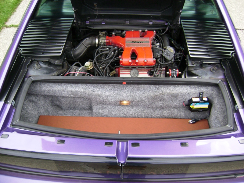

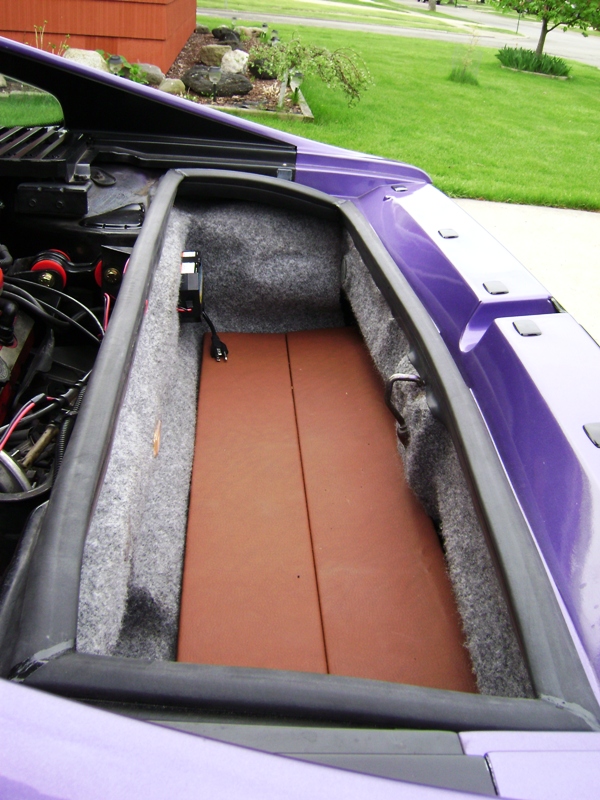

Ok, let me be the first to post pictures of Will's GT seal. It fits perfectly. At first I was wondering about the fit but then realized I had to press it into place. My old seal was so sloppy it just slide on with no effort. (and thus not a great seal either.) This is a winner guys.
This is my ratty patched up seal.
The new seal in place.
View from the passenger side.
View from the driver side and showing the fit around the latch.
If you need a new GT seal it's time to step up and and order it from Will.

Question on above pictures with new seal installed: Are you sure you installed the seal correctly, by stretching lengths so they aren't in compression ? Reason for question is that it doesn't appear that the corners are going there correct position, meaning they are being pulled inboard. From your photo's, either the individual lengths are too short, or installation needs to be readdressed.
Not a flame, just an observation.

The seal is installed correctly. I just went and rechecked it. No stretching or compression. It is tight to the steel lip all the way around and in tight to all 4 corners. Again: a perfect fit.

I mark the seals for correct installation. The red sticker is on the short (engine side).
Looking good Larry

in the last picture is the corner coming apart or not ???

With 3 bonding agents, 2 of which that are heat cured, the only way that corner is coming apart is in a tug-of-war and even then the rubber will fail before the joint will.
I think you are seeing a reflection

Nothing coming apart on it Mike. And just look at my old seal compared to the new seal.

did not mean to offend anyone just looking at picture wrong sorry it is a nice seal

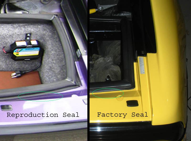

I truly admire the efforts of people making reproduction parts, I mean that. However I do want to understand what I'm getting in advance, please explain the difference shown in the below picture:
Full photo of Factory Seal to show all corner fully in position:

Interesting comparison. You might notice how the factory seal was seated on Larry's car, which is nearly identical to the new seals shape. Maybe the problem isn't the seal, but more likely the shape of his trunk lip? My car current car (the one in the video) doesn't look like Larry's either but it isn't as square as your example which fits exceptionally square (very nice BTW).
I hope this clarifies things a little.

You can see his OEM seal fits just as badly. No offense Larry, I like your car, just for the record.
If you look at the green circles I have added to cali kids image below, you can see on Larry's GT that the bottom edge of the seal starts riding right up against the part of the fastback clip that bends up towards the decklid and tail lights. In the pic on the right, the yellow GT, in the green circle you can see there is a near 1/4 inch gap that runs the entire length of the bottom edge of the seal.
On Larry's, if the seal is pulling too much towards the back of the car and up the clip as it appears to be, that could account for why the corners are pulling in to the trunk area and away from the sides of clip where it should be making a nice flush and straight seal.
The reproduction seal in his video doesn't seem to have the issue from what I can tell and it looks like the bottom edge in the vid isn't riding up the back of the fastback clip either. you can see the near 1/4 inch gap as it should be.

Thanks for the replies, appears to be a "body issue" from the comments made. I know you can stretch or compress a few millimeters on installation, his car seems to have variations beyond that limit.

Hey no offense taken. I know my GT was involved in a collision back in 1992 according to Carfax. I suspect it was rearended. The old seal never fit on properly and I never noticed the distortion or had another GT to compare it to. I would never had posted my pictures had I known it as I wouldn't wish any harm to Will's project. Even with my distorted trunk the seal fits all the way around and into the corners and it looks a world better than my old seal. Maybe someone who has the new seal and a square trunk opening would post a picture of it and put the issue to rest.
Larry (my GT's been beaten and rode hard but I still lover her)

It should be a relatively easy fix, if you want to that is. Sounds like it isn't a major issue really since the seal does it's job and is really only a minor alignment issue anyways.
I think the upper metal edge is what the seal hooks onto and if I recall it is relatively easy to bend and shape the trunk metal there. It could probably be bent or pried in towards the trunk pretty easily.
I have owned a few Fieros, and most of them had been tapped in one place or another. Over the 20+ years these cars have been on the road it is a miracle when you find one that hasn't at least been bumped at one point. Good thing these are so many parts out there to straighten them out again. Yours looks good to me!
