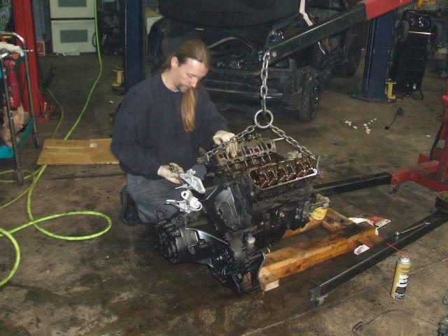

Time to post some pics from yesterday. The video will need to be edited and posted. I'm short on time now, so hopefully some time later this week.
Here is what is completed after day 1.

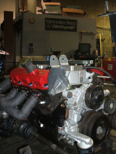

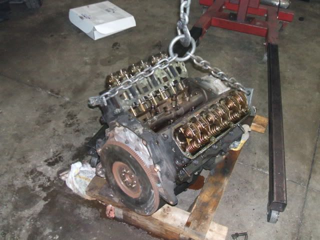

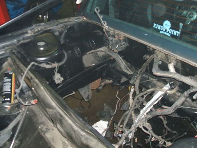

Engine is removed and engine bay is prepped and painted satin black. Normally, I remove the wiring harness with the engine, but because I need to modify it, I left it in the engine bay. We installed the solid cradle bushings and the bump steer kit. It took longer than expected to install the kit, but no biggie.
The engine and transmission were degreased and painted. The poly engine mounts were installed. We lost a few hours to repair the atrocious install of the swap. They thought it was easier to drill the cradle with a torch and we couldn't get any of the mounts to line up. They also cut the original engine mount bracket off and moved it closer to the front of the cradle. We had to reconstruct the cradle on that side and make it useable again.
I rebuilt the passenger side axle with new cv joints. I don't like aftermarket axles because the joints are much smaller than the original Fiero axles.

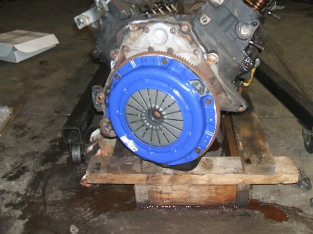

The clutch was replaced. It looked like a stock valeo clutch that was installed. The valve covers were painted.

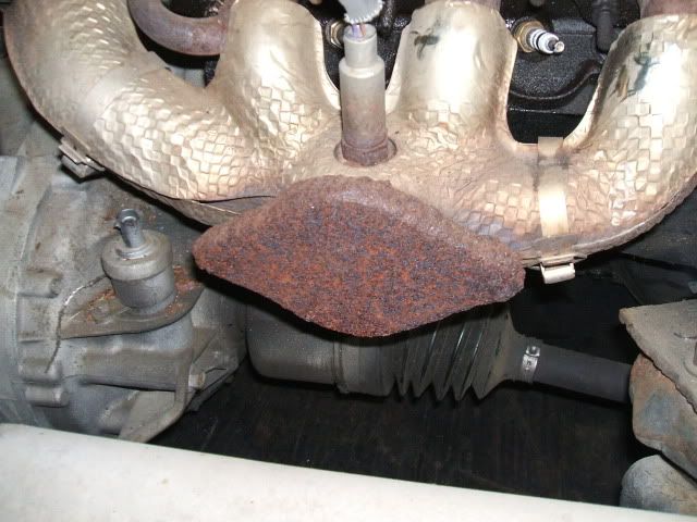

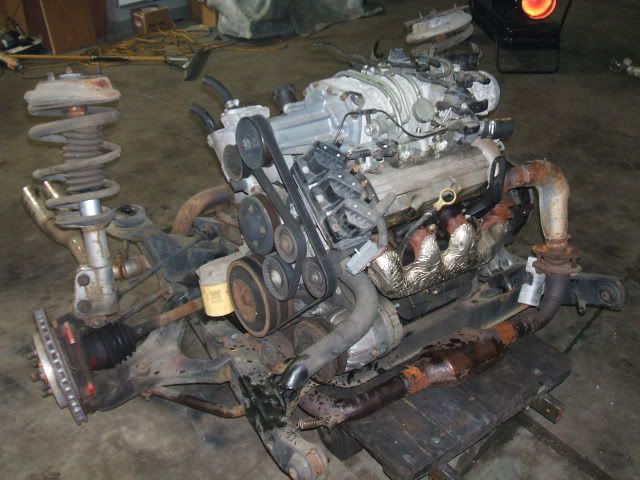

The original exhaust manifold

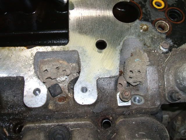

we found a lot of wasp nests all over the car...

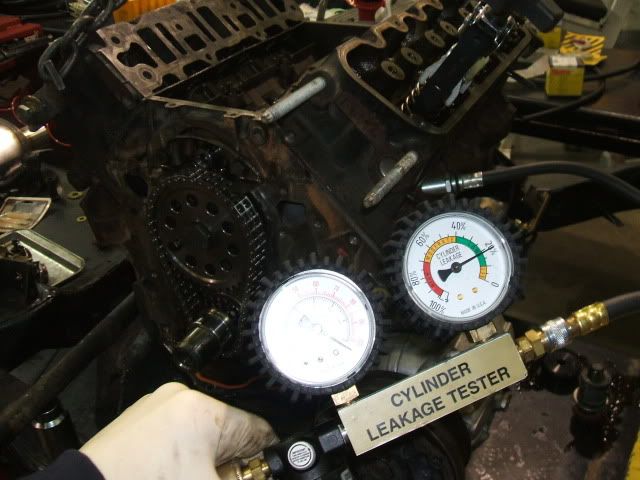

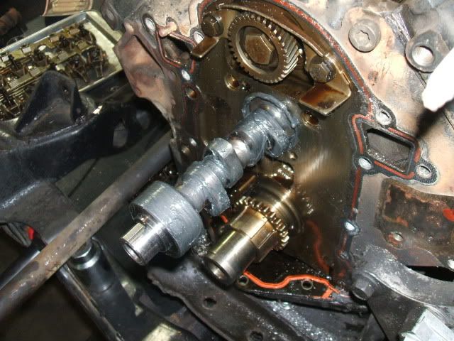

Here are some pics from today. We still have a few hours to go, but I'm finally taking lunch....

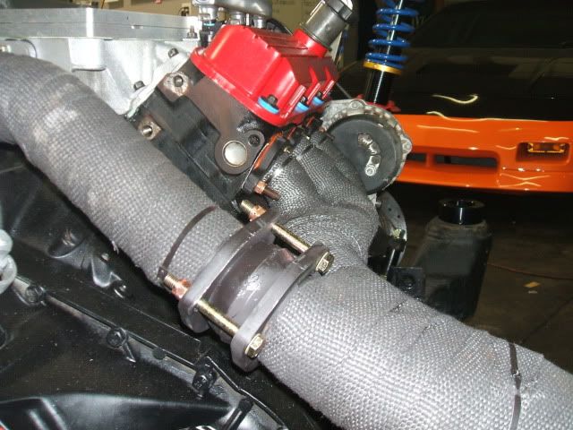

Headers fiberglass wrapped and silicone coated to be cured at 400 degrees.

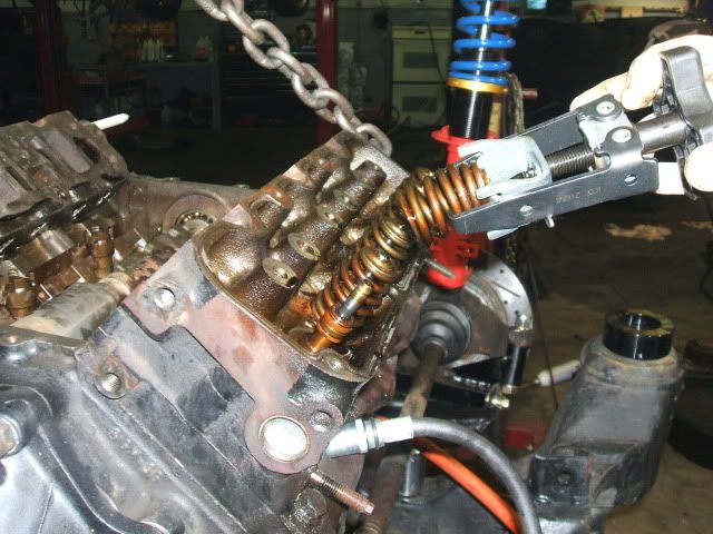

leakdown test and valve spring upgrade.

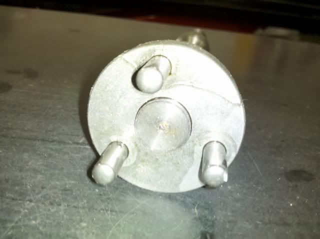

machined oil pump cover

camshaft being installed and lubed
I can vouch for doing this also. The only problem is little tiny pieces of fiberglass will be all over the first few miles of driving no matter what. We painted (rather soaked with paint) the fiberglass and torched the inside for it to bake and this still happened.

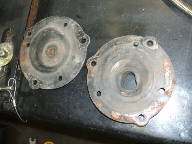

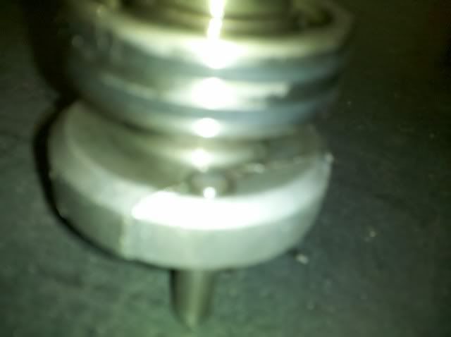

Yesterday, around 4:45pm we found one of the rear strut mounting plates was egg shaped. Luckily, the Fiero Store's UPS cutoff was made and we will have the new one in our hands sometime this morning. Today, I plan to port the blower case and modify the wiring harness. Ryan plans to finish up the intercooler plumbing install and fabricate the rest of the exhaust. We'll play it by ear for the rest of the day.

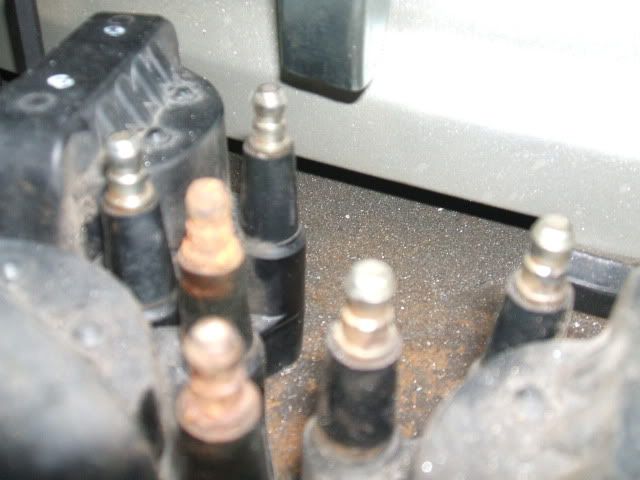

Here is our list of setbacks.....quite common on any Fiero swap. When I say setback, I mean a problem that wasn't expected.
Monday setback....
The engine mounts didn't line up with the cradle because the cradle was cut and welded for the front engine mount bracket. We had to fabricate a way to use the stock Fiero poly mounts and keep the drivetrain straight.
Tuesday setback.....
Found strut mounts egg shaped not allowing us to assemble the rear coil overs on schedule.

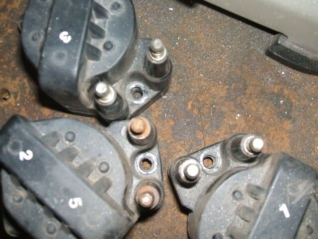

Found ignition coils to have excessive corrosion on the secondary poles. Had to order new ignition coils
Wednesday setback......
Found the blower snout bearings to sound like sandpaper. Also, the snount shaft was cracked and previously welded, but starting to crack again. I had a spare snout shaft in stock and pressed new bearings onto it for this snout.

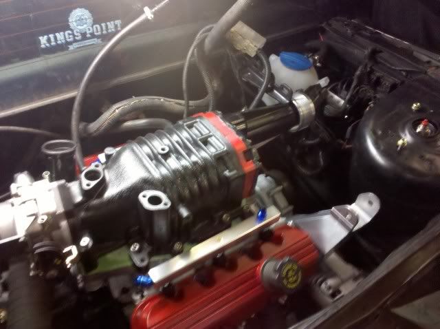

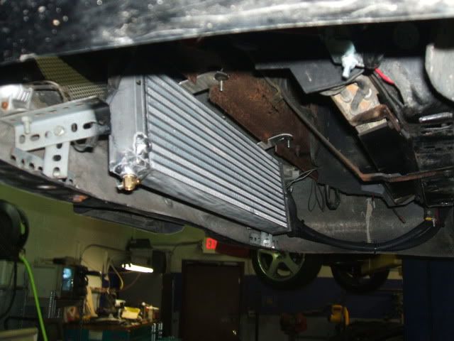

Intercooler reservoir mounted using a Volkswagen coolant bottle. It is kept at the highest point and has a bleed off hose to constantly purge air.

Looks great, what part of the front did you mount the intercooler to?
bmwguru
Posts: 4692
From: Howell, NJ USA
Registered: Sep 2006
Feedback score:    (38)
Total ratings: 131
Report this Post02-02-2011 06:48 PM Click Here to See the Profile for bmwguruClick Here to visit bmwguru's HomePageSend a Private Message to bmwguruEdit/Delete MessageReply w/QuoteDirect Link to This Post
Here is a better pic. The funky crap they use to hang garage doors is not from us, but from whoever put on the F355 bumper.

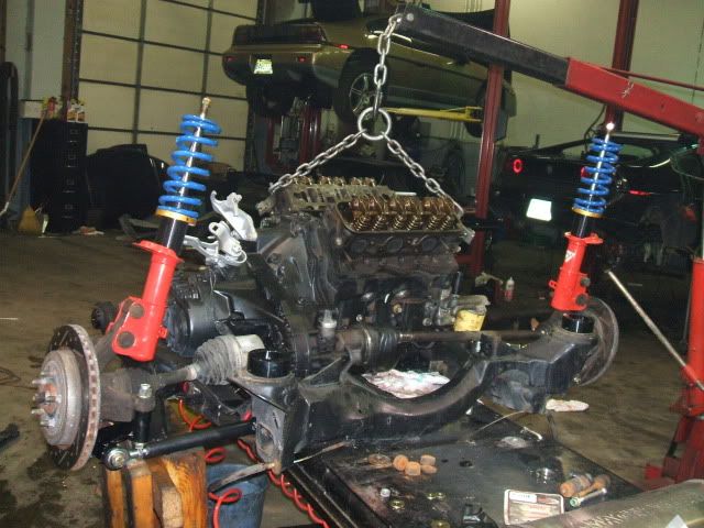

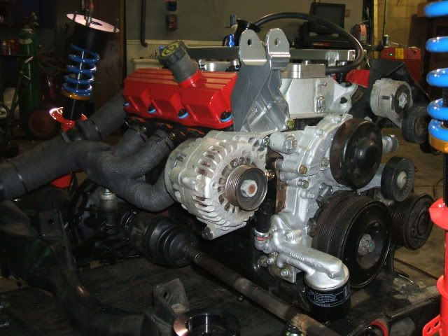

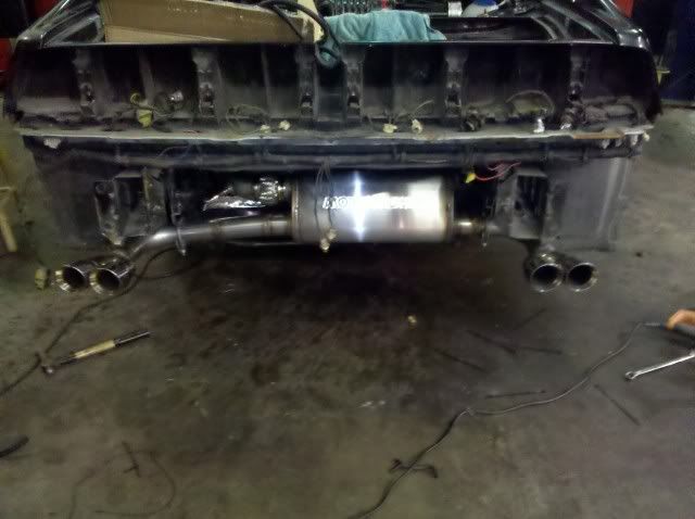

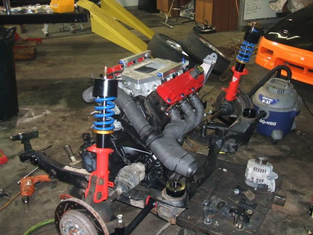

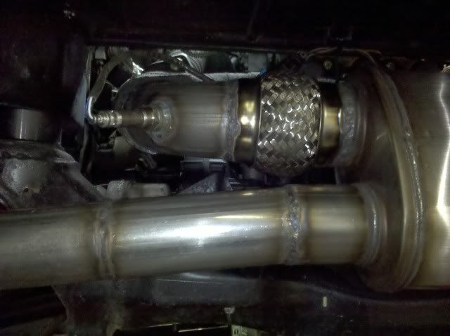

We are tired.....the engine is in....
Tomorrow, we plan to finish the exhaust, wiring harness, front suspension, tune the pcm, run the plumbing for the fuel, radiator, and intercooler, weld in the new dog bone support, and fabricate some ignition wires.
Damn SILLY Northern's....Those are what you call dirt dobber nest made by none other that a dirt dobber not a wasp.....When you break the nest open you will find tons on dead insects that the baby dobbers feed on till they break out. A dirt dobber can build one of those nest fast and tons of them.......
Swap is looking good.......

end of the day on Day 4...
The rear bumper is back on....we removed it to TIG weld the entire exhaust so that there are no parts that are not stainless steel....also a cleaner weld....the 3 wasp nests were removed from there as well. The wiring harness is completed. Tomorrow we still have a lot to do, but should still have it done by the end of the day....hopefully
