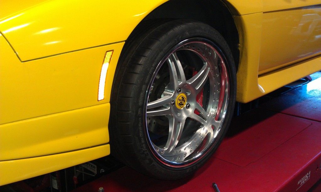

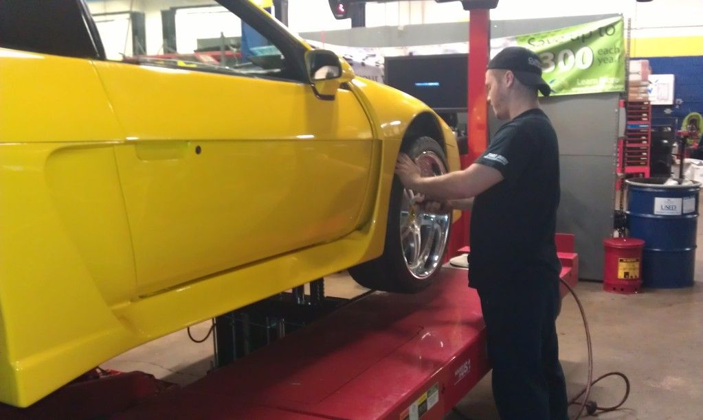

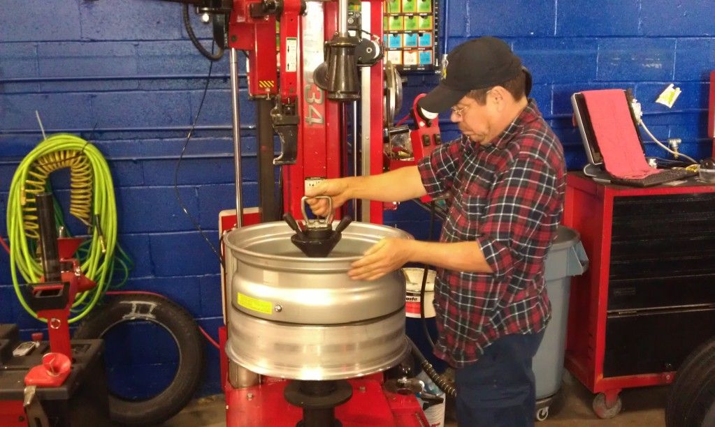

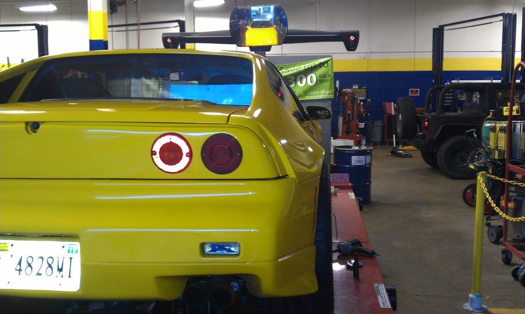

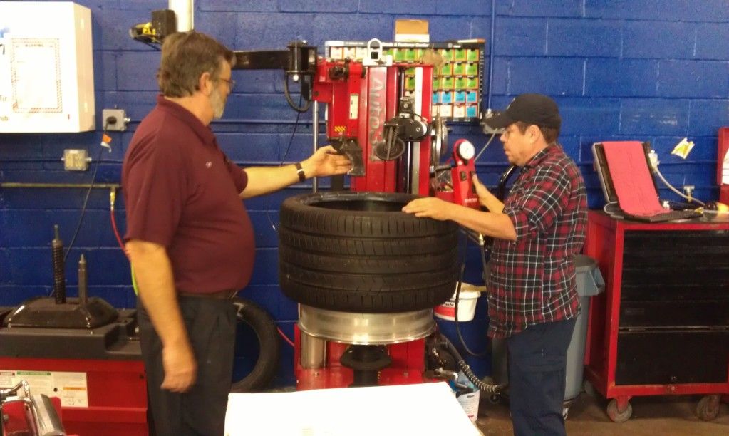

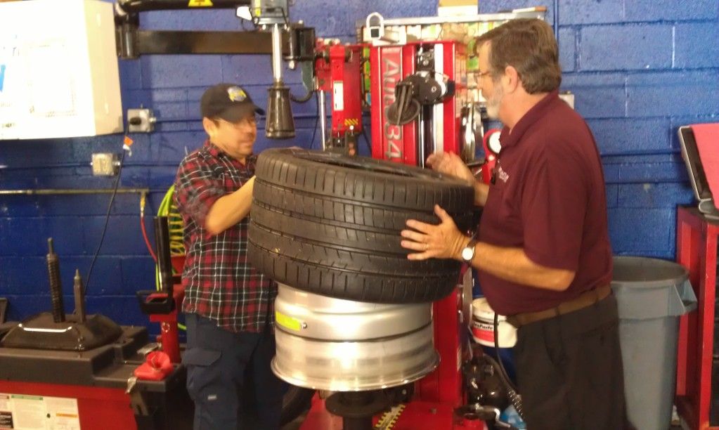

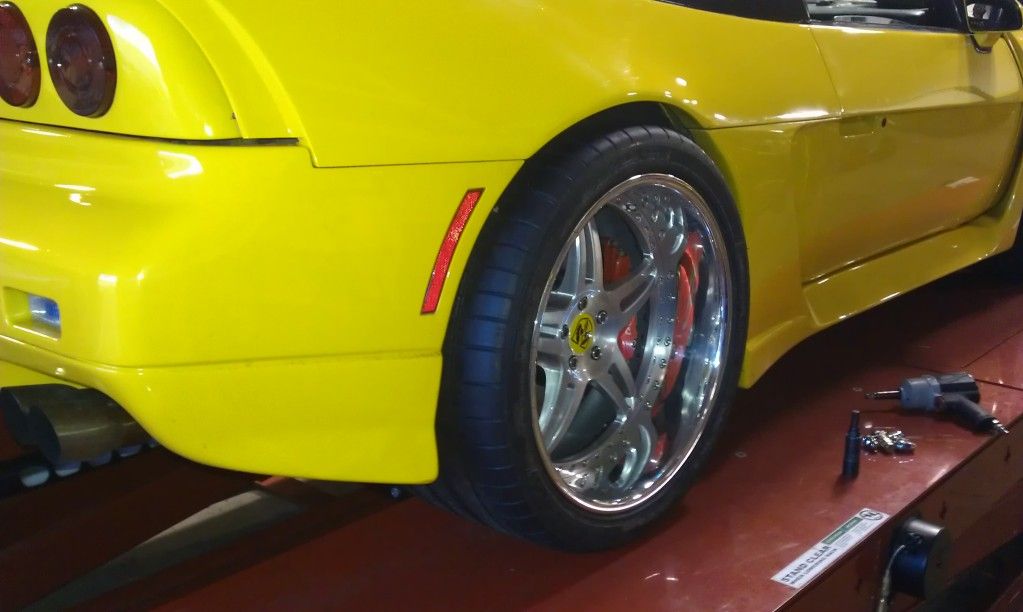

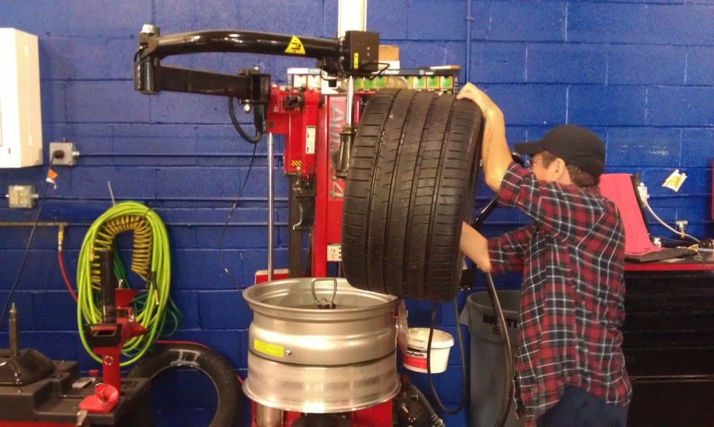

After spending several hours waiting for the replacement tire to arrive at NTB...the tire arrived at 3:30. I took it and made it to Curry's Auto Service in about 6 minutes. From there Tim Hoover, the General Manager at that location (616 South Pickett Street, Alexandria, VA) and crew went to work. With the use of the Auto34 tire changer it took less than 5 minutes. Here Alejandro Espinoza starts the mounting process.
Alejandro and Tim get the tire into proper position
Off to balancing...

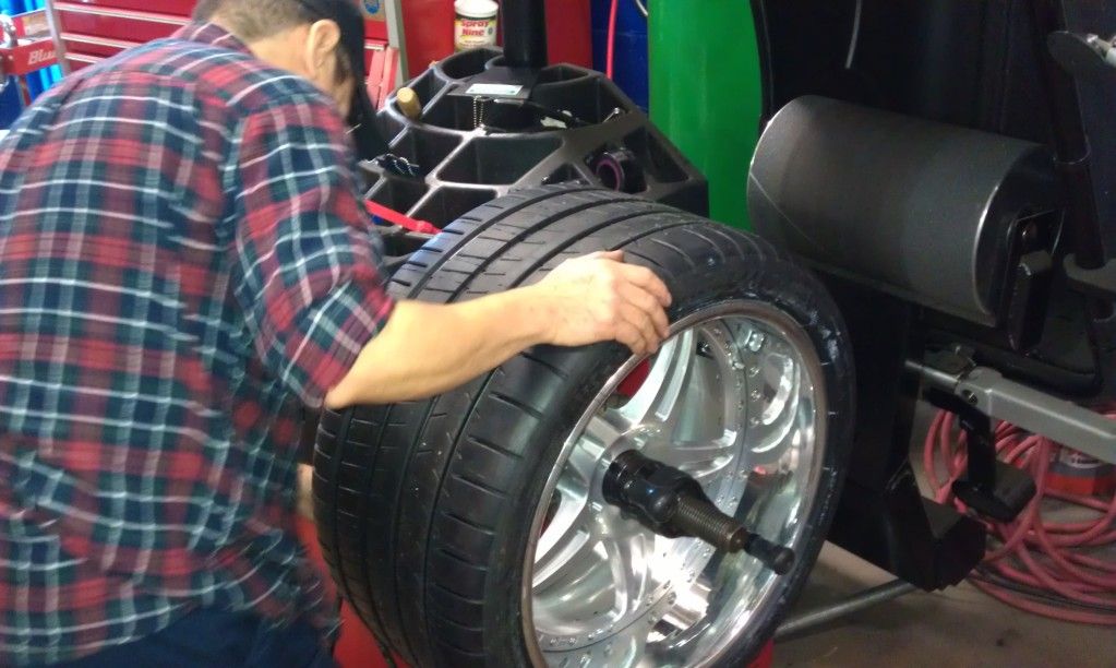

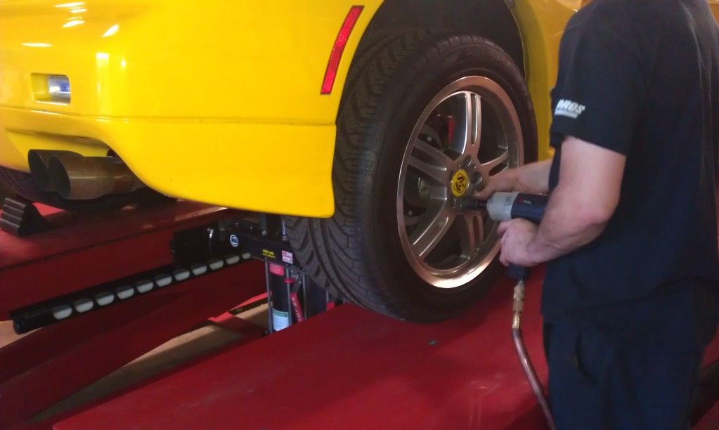

Here is where Patrick Bowe took over to mount the wheels. Since the car is so low we had to put it on the Hunter Alignment Rack.
Then it was off with the old...
and on with the new

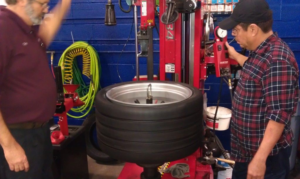

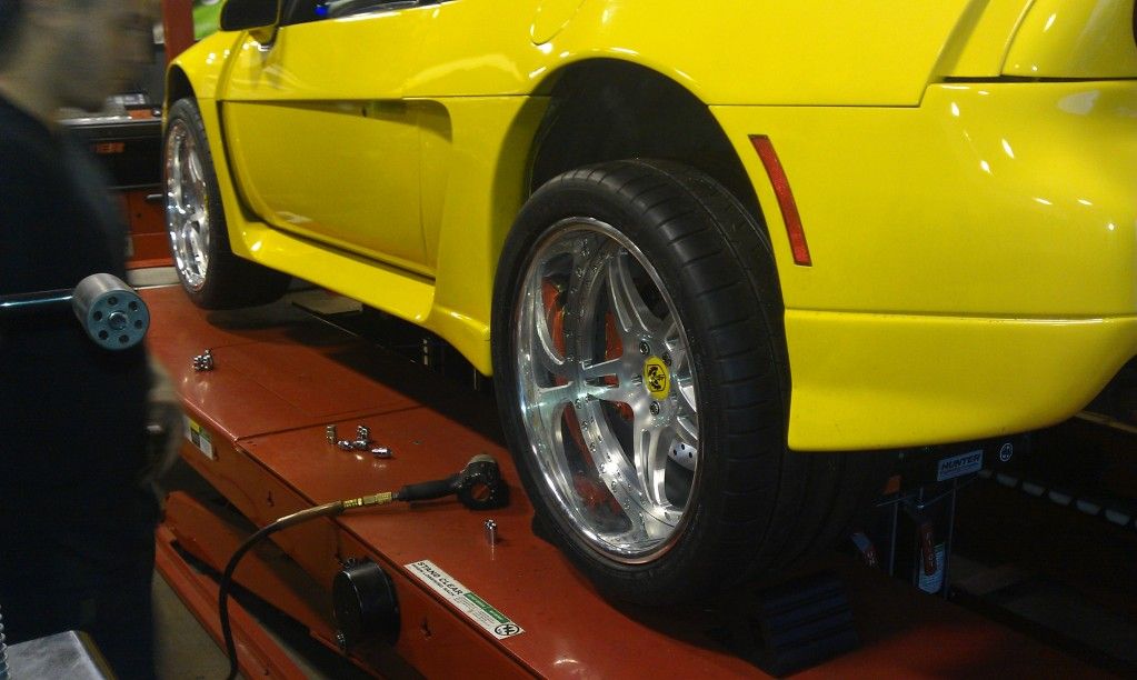

We did discover the lug nuts I used with the TSW wheels would not work with the Forgeline wheels. This required a quick trip to Advance Auto Parts around the corner. When Tim learned of the situation he handed me his keys and let me go get the lug nuts we needed. When I got to Advance Auto Parts, Clifton sold me the last set of M12x1.50 tuner lug nuts he had and they worked perfectly. Additionally they gave the wheels a much better appearance than the hex nuts.
Doesn't the 285 look tiny compared to the 325???
"PUNY TIRE!"
And then there was one!!!
REPLACED!!!
And the calculations were acceptable regarding the offsets

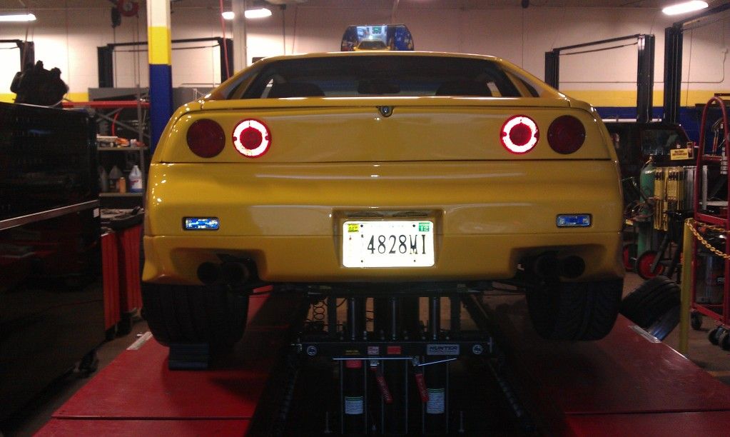

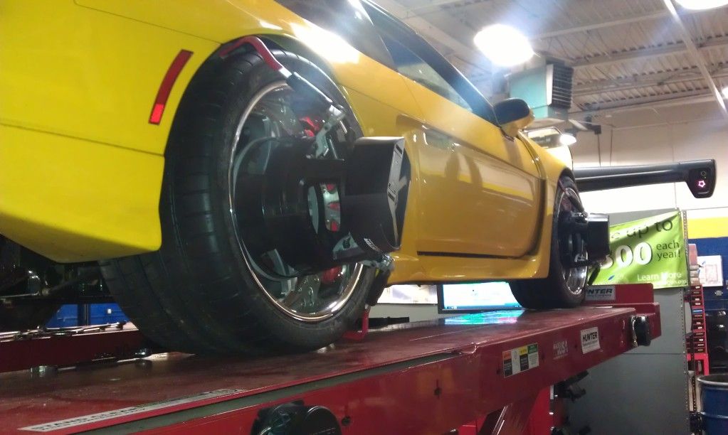

And then to the alignment completed by David Levin...
A very special thank you to Tim, Alejandro, Patrick, and David at the Alexandria, VA Curry's Auto Service for being able to complete this task without issue. Their equipment is definitely top end and for my fellow Fiero owners here in Northern VA...they'll take care of you. They were all very impressed with the work Dave did. I promised Tim I'd let him take my car for a spin on a dry day. When they finished the alignment it was a torrential downpour
Now that the car has settled I'll need to raise the front about an inch. The rear tires fit very nicely now. I'll be working on that tomorrow morning ...weather dependent of course. Next week's task...back to the paint shop to have the chips in the front removed and some touch up.

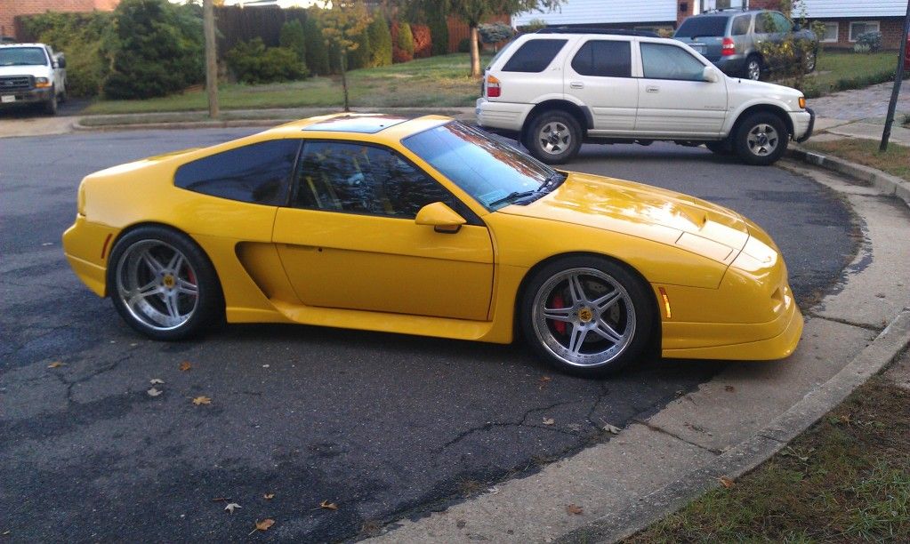

What size are those rims? Very very good job. Fit perfect !!

19x9 up front with an offset of 22.86...19x11.5 on the rear with an offset of 6.35

Top notch equipment there, especially the alignment where it doesn't touch the rim (less chance of poking it like the old style).

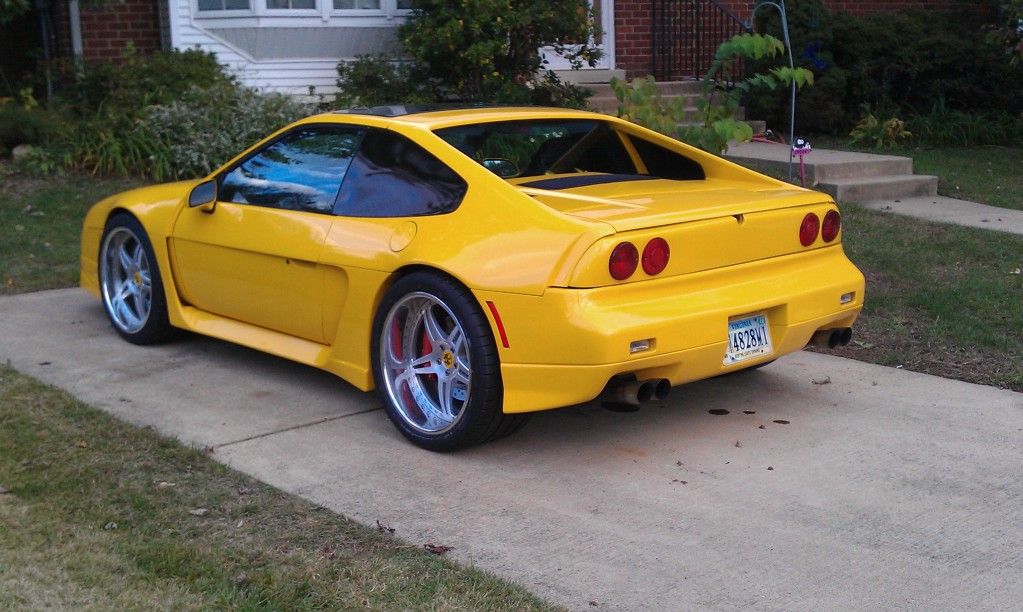

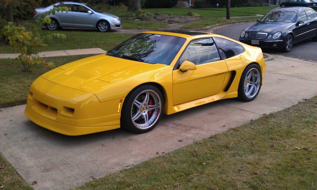

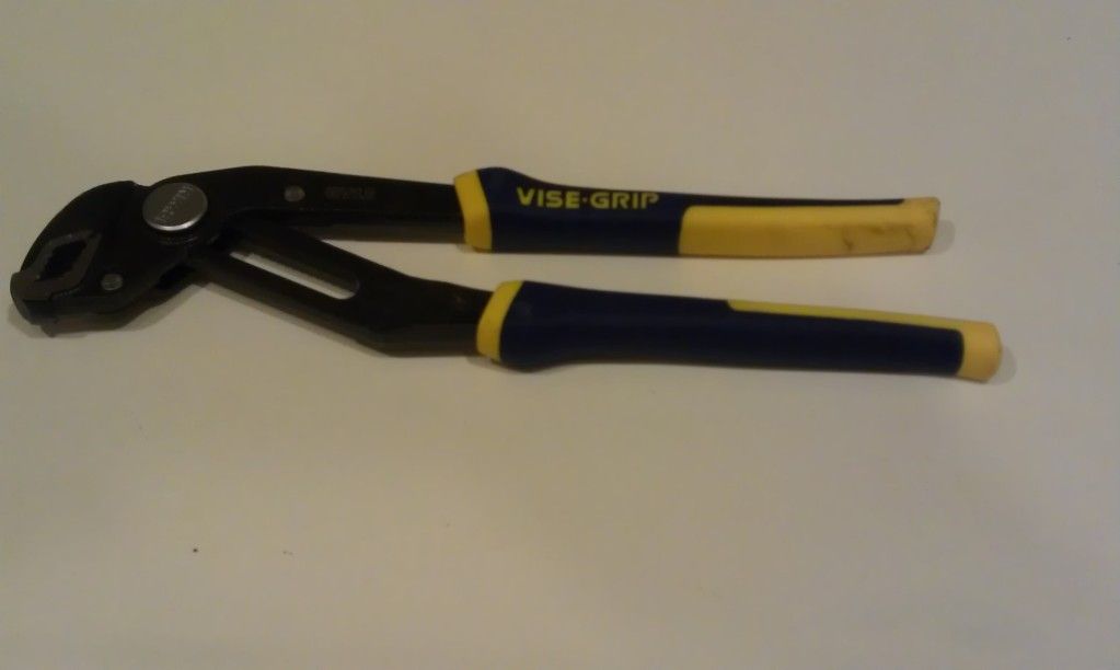

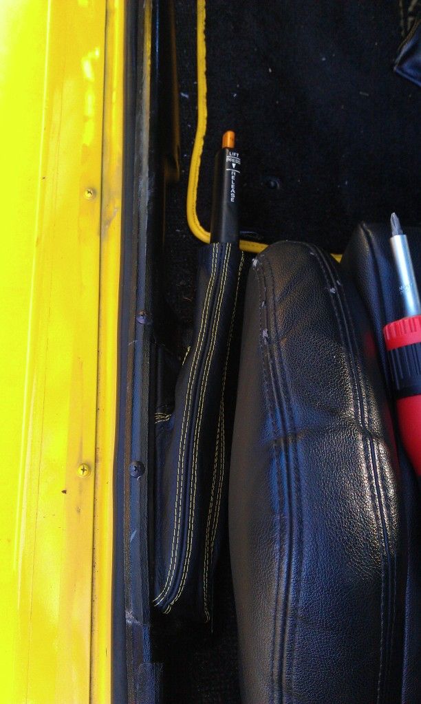

Here's how today went. Got up early this morning...decided to wipe the car down and saw how much the suspension resettled with the new wheels and tires. The rear tires were both at about 1.5" of clearance from the fender. The front right was at about .75" while the left front was a bit lower...between .25 and .5 of clearance from the fender. I learned while driving the car today this was causing the tire to rub on the fender anytime I hit a bump, made a turn, or came to a sudden halt.
Fortunately there was no damage to the fender or tire. I spoke to Dave earlier this morning after seeing the car in daylight and he explained how to make the adjustment. I thought I would have the shop do it since I didn't really want to roll the vehicle onto lawn concrete squares to get my floor jack under the car, but that didn't work out. Too many errands and besides I was enjoying driving the car on this beautiful day here...just doing it with extra caution. First I didn't have the spanner wrench for my HAL QA1 coilover shocks

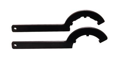

so with Dave's guidance I was able to come up with an effective alternate tool from Sears
After bringing my youngest daughter (who was more excited about the car being home again than I was) to all of her Saturday activities we were finally home so I decided to get the jack, jack stands, and concrete square out. Dave told me how easy the task was and he was right. Glad he doesn't charge for phone support I was able to adjust both sides to about 1.4" of fender clearance.
Once I figured out how to do it the adjustments were pretty easy and quick. After driving the car this evening the right side is holding steady at about 1.4" of clearance. The left side has come down slightly, but the tire is no longer rubbing the fender on bumps, turns, or sudden stops. I'll adjust it again tomorrow and monitor it. I was also able to find the issue with my bright lights with Dave's suggestion. I unplugged the adapter harness for my projector headlights from the factory plug...used one of my old hi/low bulbs and found the circuits were functioning normally. In the end one of the prongs from the aftermarket harness plug in had become indented into the plug and wasn't making contact on the associated hi-beam lead. Problem fixed. I'm all set with the paint shop for touch-up and chip removal this coming week. Once completed I'll be posting new photos from an actual photo shoot with a scenic background other than my driveway.
One of the most gratifying moments today was when two guys pulled up next to me at a traffic light after being behind me honking their horn to tell me how totally BAD ASS my car is I'm certainly enjoying this attention.

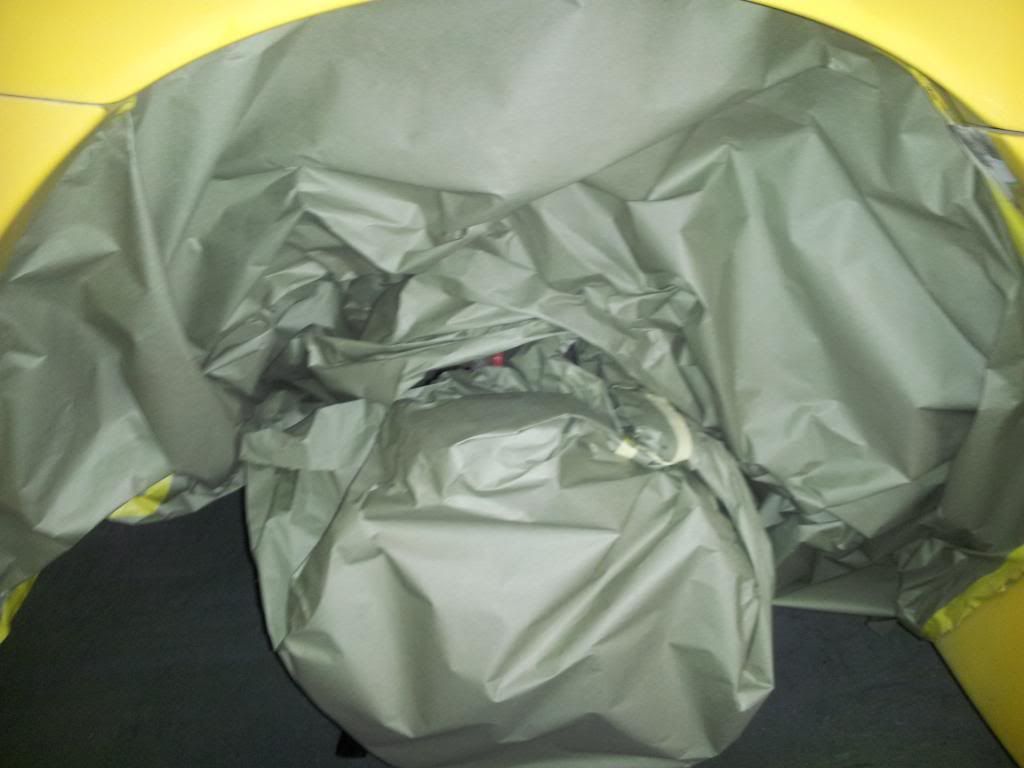

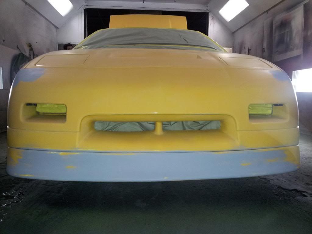

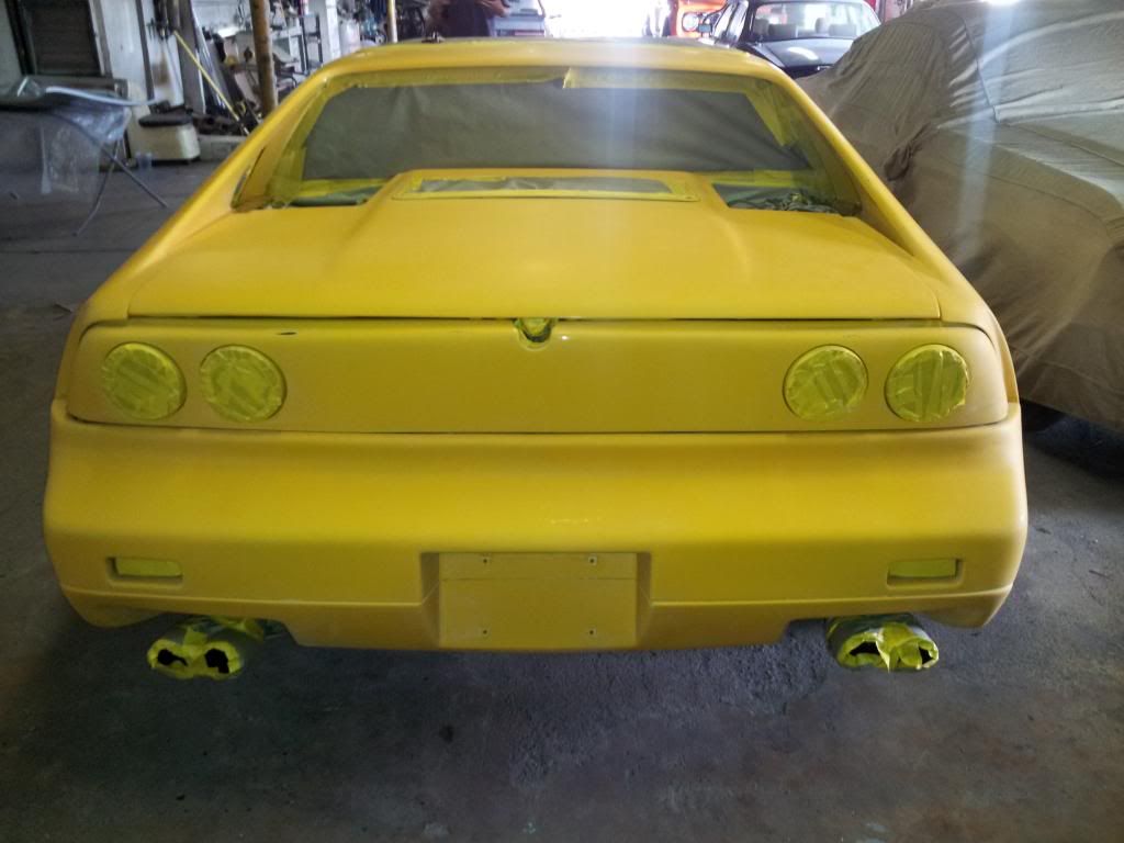

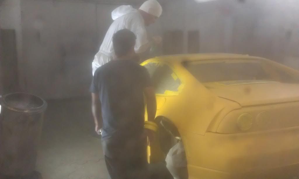

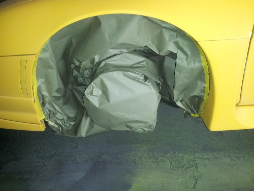

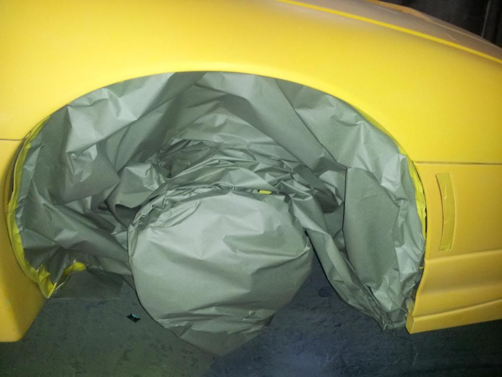

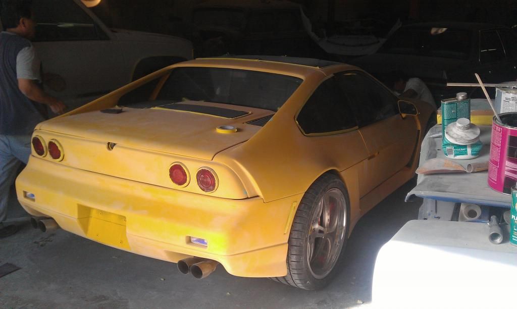

Dropped the car off at the paint shop this morning. By this afternoon the entire car had been sanded and all the road rash up front had been resurfaced. They decided to paint the whole car for a uniform color appearance so they're going to call me before they start tomorrow so I can get pictures of them painting the car.
