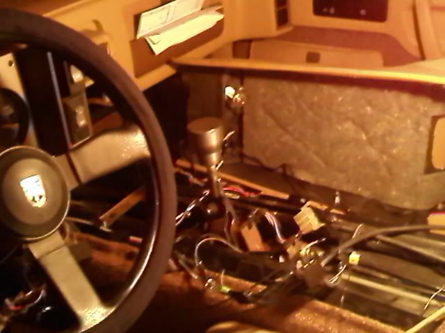

Yep, its out again, removing the auto and putting the 4-speed in its place. While I'm at it, I'll change to the dual TB intake, tighten the belts, wrap the headers, fix the oil leak, re-do the exhaust, and a few other things. Maybe roller rockers.
I already removed my whole center console and replaced my auto shifter with my manual short shifter! It has knob I turned on a lathe myself. Weighs like 5lbs. Lol.
Oh and i found out why my Cruise Control wasn't working, I had it wired to my back-up lights. DOH! So I think I had cruise when I was in REVERSE (inside joke), but that's it.

heres a pic of matts new gear shifter
o and by the way matt, REVERSE!!

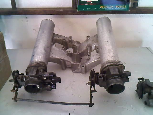

i wasn't sure if you were going to post this or not but i have a picture of your duel throtle body intake when i was over today.
should work well with your engine becuase of less restriction of the intake. might need to fix the control arm for the duel throtle body though. if you can get it to look like the pic of the one on this page, it would be really awsome looking.

I have been busy the past few days. Got my dual TB intake in, it needs work to make it perfect, it is a prototype after all. I really do need to re-do that rod linkage, thinking of doing it like TT Slick did, weld a rod where the TPS goes, and into the spring area of the other one.

Well today i cut and re-welded my magnaflow exhaust system as I plan to use that, I moved the tips down, as they were way too high. Next i need to figure out how to position my muffler so it doesn't sit too low and scrap the ground like it used to. I also did soldered all the wires i needed to on the engine wiring harness for the manual swap, mainly shorting 3 pairs of wires and extending the VSS wires. I also helped Alex with his project again.

I installed my fog lights today. They work great, very bright. The switch is were the defog would be, looks 100% factory. It's from a Pontiac 6000. Also, Alex helped me fix my door lock rod problem yesterday, so I put my door back together. Then I did a bunch of soldering, including the A/C sensor I need to get the A/C to work. But then there is the bad part of the day (as usual), it keeps blowing the gauges fuse when i turn the ign on. I think the problem is some wires are shorting at the big wire loom that wasn't letting me get the pedal assemblies in/out easily. It's now impossible to get too. Scratching my head on this one, will taking the cluster out help get to it any? I doubt it.
Here is what my interior looks like now. Not too pretty, wires everywhere! I gotta find which wires in that huge bundle are the back-up lights, because there's several blue and green wires. I'm also getting a different console skeleton, as mine broke in half and a lot of screw holes are badly cracked (all the work i have been doing hasn't helped either).
