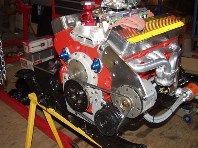

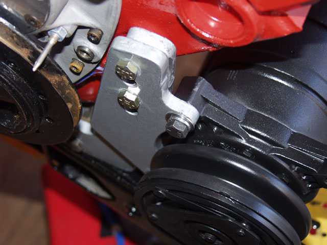

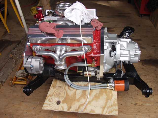

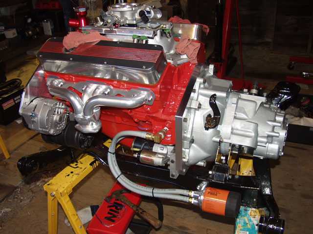

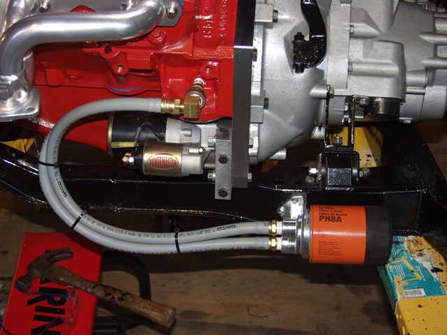

Got the A/C and Alt mounted on the motor today, the front mount bolted to the cradle (for the test fit) and the remote oil relocation kit installed and mounted.
Should be doing the test fit by next weekend.
A/C compressor on the new mount.
Bolted down the front mount to the cradle
Mounted oil relocation kit.
Installed the alternator and belt.
Side shot
Slowly but surely.
Rob D.
[This message has been edited by chester (edited 11-03-2002).]

Report this Post11-03-2002 04:59 PM Click Here to See the Profile for JncomuttSend a Private Message to JncomuttDirect Link to This Post
Woooooooow.
<Picks jaw up off the floor, and presses back button>
19 Year Old Fierophile.
--1986 GT Daily Driver, 4:10s, NX 50 Shot, Borla exhaust, ported manifolds, and a few other goodies
--1984 SE 4.9, IMSA spoiler, Duel exhuast, GT rear bumper, Konis, drop spindles, Rear adjustable perch, Poly total kit, Poly cradle bushings, Big front bar, Added rear bar, 11.25" brakes on all corners w/SS hoses, Fancy wheels wrapped w/soft rubber, and much much more.

nice hammer

Originally posted by The Aura:
nice hammer
gotta pound somethin

the safety glasses aren't bad either... oh yeah.. almost forgot.. the engine... the engine looks great!!

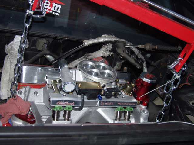

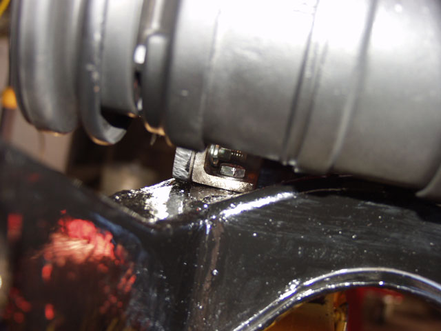

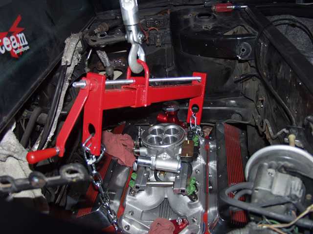

Well, got the test fit done this past Sunday and already removed, welded and reinstalled the motor onto the cradle. My mandrel bent exhaust tubing and water pump setup came in today. Too bad the pump is blue and not red like I ordered. But Summit made it right by shipping another out to me. Next is to finish in the engine compartment and then hopefully get the motor installed this weekend...Some pics...
Motor on dolly
Under car getting ready to hoist in.
In the car. I didn't want to take it back out!

Thanks for the compliments all!! My plans were to have this installed this weekend, unfortunately, as my luck would dictate, there is a major winter storm heading for us destine to give me grief on Saturday...
I am lining the engine compartment with a Thermo-Tec heat barrier. The water pump is a CSI remote pump. Don't know the sustained pressure rating but it flows 37 gallons/minute.

Report this Post11-15-2002 10:02 AM Click Here to See the Profile for 88CoupeV6Click Here to visit 88CoupeV6's HomePageSend a Private Message to 88CoupeV6Direct Link to This Post
Ouch, a FORD IAC.
Josh Pics of my cars
Join New England Fiero Association
chester
Posts: 4063
Feedback score:    (42)
Total ratings: 153
Report this Post11-15-2002 10:19 AM Click Here to See the Profile for chesterSend a Private Message to chesterDirect Link to This Post
Originally posted by 88CoupeV6:
Ouch, a FORD IAC.
???? According to the Edelbrock manual, all sensors are GM...

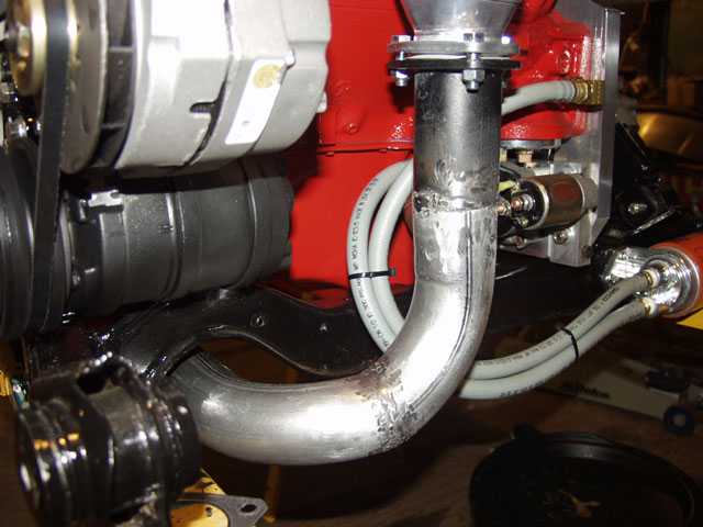

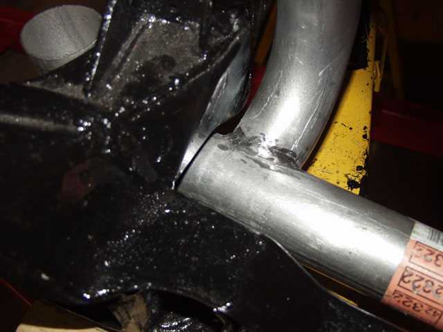

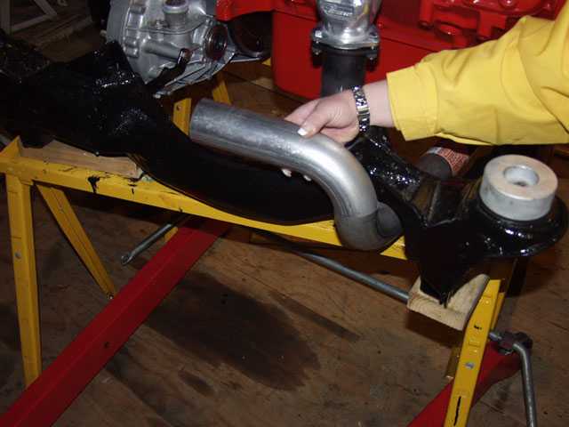

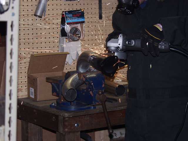

Report this Post12-01-2002 06:37 PM Click Here to See the Profile for chesterSend a Private Message to chesterDirect Link to This Post

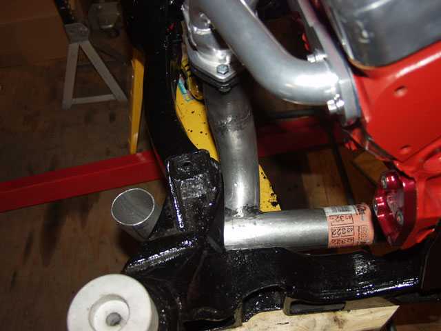

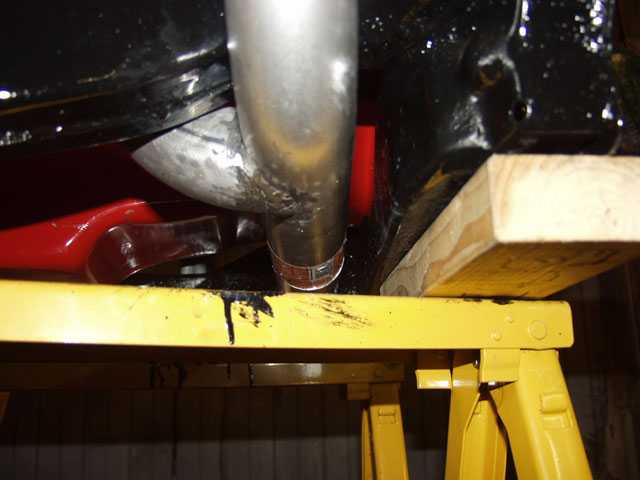

Well, finally got to weld and grind 101. Did I mention that I NEVER welded before? Heheheh...melt metal...arh.. I decided to fabricate my own exhaust for my conversion. I also decided to go with the rumble of a flowmaster over the dual cats. I ran 2 1/2 inch exhaust to a flowmster 40 from West Coast Fiero. I'm debating if I want the exhaust to break down in the middle or not. Anyway, here are the progress pics. Let me know what you think!
Rob D.
PS. Once I'm done it getting jethot coated.
Weld and grind
Not too shabby
Front header
Rear header
Underside
[This message has been edited by chester (edited 12-01-2002).]

Report this Post12-01-2002 06:42 PM Click Here to See the Profile for chesterSend a Private Message to chesterDirect Link to This Post
chester
4063 posts
Member since Jun 2001
This is the last bend to weld in. The muffler will be clamped on.

Where ya putting the oxygen sensor?
chester
Posts: 4063
Total ratings: 153
Report this Post12-01-2002 06:54 PM Click Here to See the Profile for chesterSend a Private Message to chesterDirect Link to This Post
Oh yeah, thats going off the back header. I have the fitting, just haven't welded it yet. Thanks for the reminder.
Rob D

Looking pretty good Rob! I wanted to switch to the 2 into 1 exhaust route before I sold the car.
Just a tip, you may want to double nut the bolts that hold the pipe to the header flanges. I had a problem with the nuts falling off untill I double nutted them.
chester
Posts: 4063
Total ratings: 153
Report this Post12-01-2002 07:01 PM Click Here to See the Profile for chesterSend a Private Message to chesterDirect Link to This Post
Thanks for the tip. I'm using crimp style lock nuts.

Report this Post12-01-2002 07:04 PM Click Here to See the Profile for avengador1Send a Private Message to avengador1Direct Link to This Post
You might want a heat shield of some sort for your oil lines too, they look awfully close to the exhaust.
chester
Posts: 4063
Total ratings: 153
Report this Post12-01-2002 07:06 PM Click Here to See the Profile for chesterSend a Private Message to chesterDirect Link to This Post
Actually the picture is deceiving. The oil lines are about 6-8 inches from the exhaust. They will get a clamp to hold them against the cradle.
Rob D.
I agree with Jelly, I had to double-nut mine. Not trying to be an 'Ogre' here Rob, but with such a beautiful hp SBC, I'm a little concerned as to the TEE setup of the rear bank of cylinders... When mine was done (very similar in fact), the rear bank was bent around (allowing better flow) as the front bank was cut/angled into the bend.(more of a Y angle) Now, I'm no exhaust expert, and my pipes were smaller diameter, but I'm worried you may have a bit of a flow problem with the rear bank...
And then I said to myself, "who wants to hear the negatives?"...
Much better welding than I started off with... nice aluminum rear mounts!
great job
Sandy

Report this Post12-01-2002 08:58 PM Click Here to See the Profile for chesterSend a Private Message to chesterDirect Link to This Post
great job
Sandy
Thanks for the response Sandy,
Do you think that there will be a flow problem? There's not really much room to play with considering the drive axle goes thru there. I figured given the pipe diameter I should be ok. I tried to angle it some, its not at a direct 90 degree but close.
I guess only time will tell.
Rob D.

Report this Post12-02-2002 01:49 AM Click Here to See the Profile for jstrickerSend a Private Message to jstrickerDirect Link to This Post
Chester,
Flow problem aside, the problem I'd be afraid of is think of the exhaust path there and what it will hit. NOTHING likes a sharp 90° turn at high velocities and it will attempt to go straight. Hitting the back side of your pipe will really push the temperatures way up and shorten the life of that pipe. Make sure nothings behind that area that you don't want melted WHEN (not if) it finally fails.
Other than that, you're doing a great job and it's a very clean install. My hat's off to you.
Oh, as far as the oil filter goes, I wouldn't mount mine like that simply because I like to prefill them at oil changes. You're not going to be able to with a horizontal filter. I know a lot of factory cars do it that way, and they seem to work, but that doesn't mean I have to like them.
John Stricker
Rob D.
