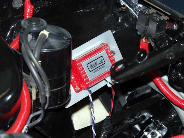

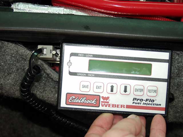

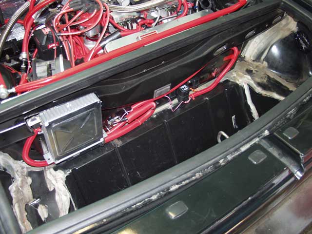

Well, trunk area is complete for now (until I mount the N2O bottle. I readjusted the firing order on the distributor and set the timing on TDC. Primed the oil system...'bout killed my drill!
Checklist of things to complete:
1) Fill radiator fluid
2) Fill tranny fluid
3) Hookup one wire on the ignition
4) Hookup coil to ignition amp
5) Wire water pump.
6) Extend oil pressure sending unit wires.
7) Check, double check and triple check entire install!!!

Wiring completed in the trunk.

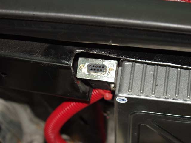

Control unit plug. I plan on running one into the car as well so I can tweak it from either location. But, to speed things up, this will be the only one for now.

Here's a shot of the controller. I got this setup because you don't need a laptop to tweak it!
Ignition amp mounted. I used some existing mounting points because this ignition amp is a temp. I have a Mallory unit with nitrous switch built it that will replace this eventually.

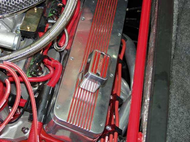

And the finishing touch on the valve cover - the breather...
