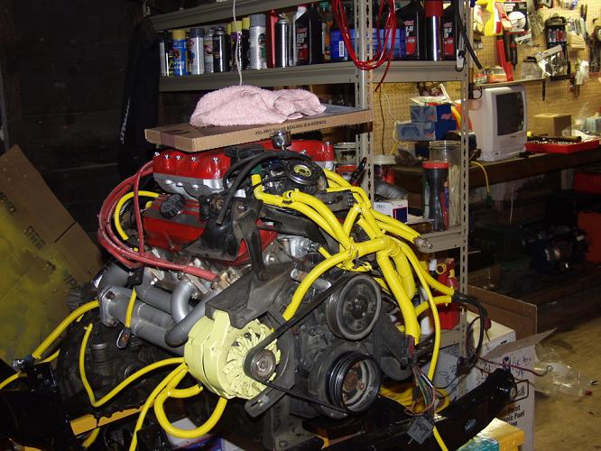

Fiero5
Posts: 8882
From: Arecibo, PR
Total ratings: 367
Report this Post08-30-2002 09:38 PM Click Here to See the Profile for Fiero5Click Here to visit Fiero5's HomePageSend a Private Message to Fiero5Direct Link to This Post
Originally posted by Elvira:
Hehe, stop by Sunday after the show and you can see it in person! We will be working on getting the engine compartment cleaned up and ready for painting and insulating this weekend. I am going to be getting my cradle ready for MY engine and tranny! I can't wait, especially since I helped build this motor that we just pulled! It is going to look nice in my blue (after I do it up in yellow, of course! )
You are of course assuming that we will have the Indy done in time
We just got done tearing down part of the front under the hood and the whole dash area and part of the interior to get to ALL the wiring.
It's going to be a long day tomm, as we have to make a Fiero run to Maine on top of trying to get the Indy all rewired.
Steve

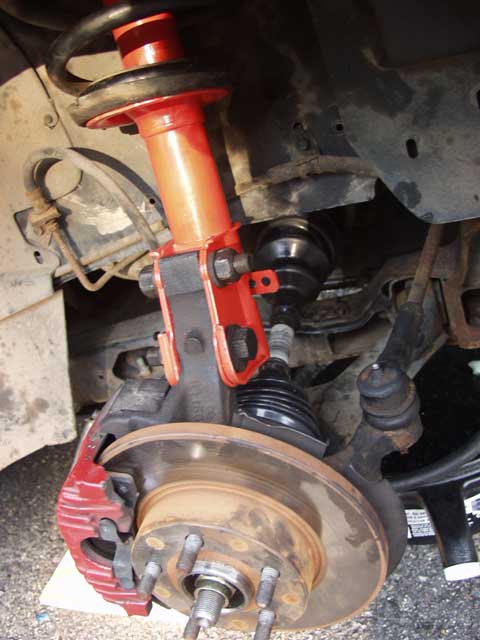

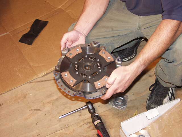

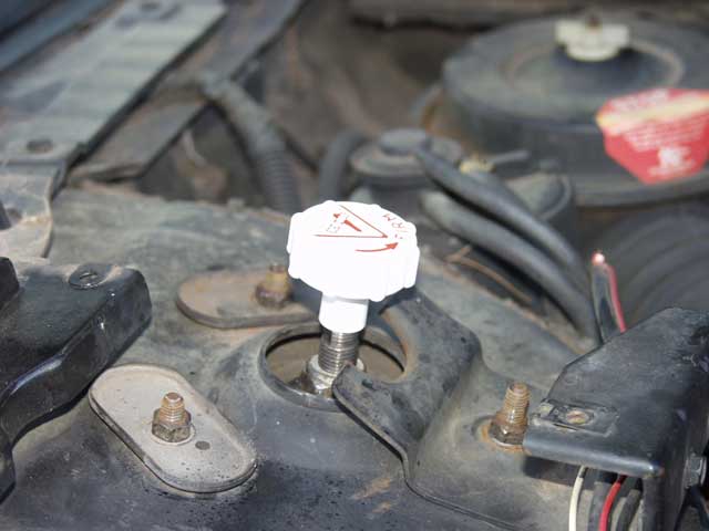

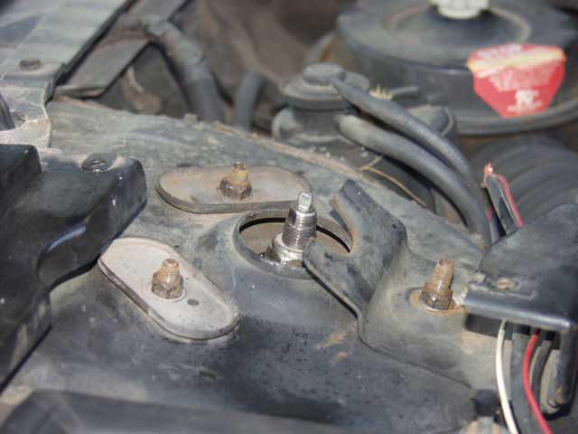

Since I'm waiting on the POR-15 to come in I decided to get some other things done. Auto-X was in dire need of new struts. Low and behold I found a new set of koni adjustable struts on EBay for $250! Can you say BUY IT NOW! So, since I'm kinda at a standstill with the Dirty Rat, I decided to change them today. It amazes me on how things can snowball. Needless to say the new struts are in, with a drivers side half shaft (old one had a torn boot). Also had to fix some bolts that decided to break on the way out. Well, typical two hour job turned into a full days work. Didn't get to the alignment shop but first impressions with the new struts and the ebachs are WOW! Can't wait to throw Auto-X into some turns once the alignment is set! As always, here are a few pics for your viewing enjoyment
Me and Auto-X
New strut and half shaft
The adjustments are pretty simple
Stick on knob and twist! SWEET!
Time to go have me a tall Gin and juice!

Great buy on the Koni's, running the same one's in my car. Guess I should break down and buy a replacement adjustment knob.

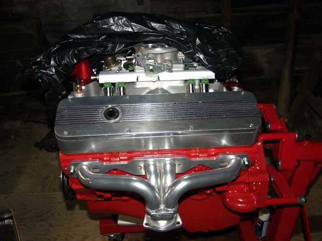

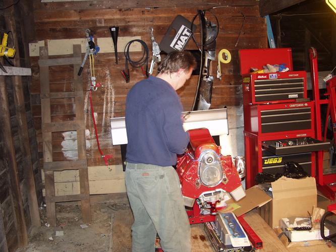

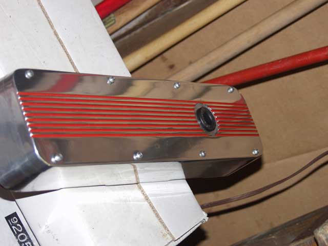

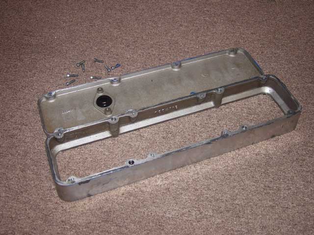

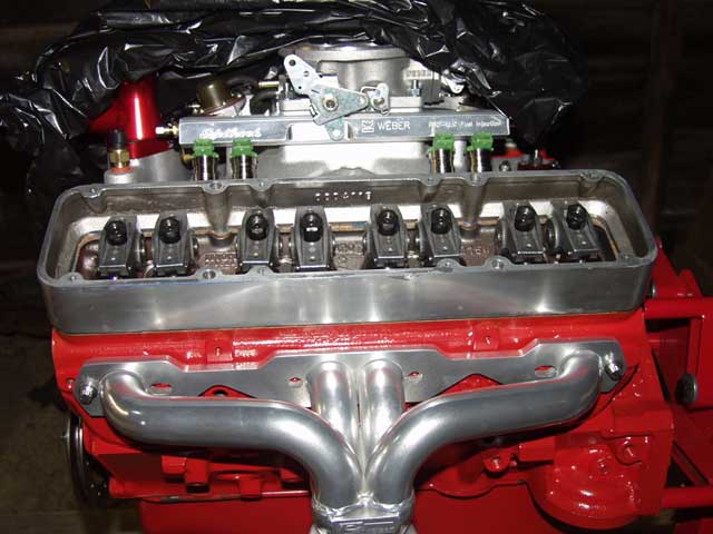

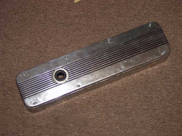

On a better note, some of you know that I've been on a quest to find some short true 2 piece valve covers. After calling every speed shop on the planet (or at least that’s what it felt like) and getting the "never heard of those" over and over, I was getting ready to give up my search. Well, yesterday we attended Spindles car show in Mass. Was a great time even though our Fiero participation went from 13 last year to just 5 this year, with a late arrival of Steve and Marion Kelly to bring it up to 6 . Along with the show Spindles hosts a swap meet. Well, we go rummaging thru all the "stuff" and Elvira calls me going "Aren't these the two piece valve covers like you were looking for?" Ah, holly crap - there they are! I knew I wasn't loosing my marbles just yet!
In the box lay a nice set of B&M two piece valve covers! SHWEEEEEEET!!!!! And their SHORTS! I was stoked!! Best $75 dollar investment into this project yet. Have I been 2 minutes later, a fellow with a 350 in a Porsche would have skanked them. He was all over me with one of those “I know your going to take them but can I see how there made?" Sure - check them out and weep buddy! He was a pretty nice guy - was in search of the same thing for quite some time. Anyway, here's what they look like. Will help ease the valve adjustment blues once the motors in the car
Thanks babe!!!!
Even got the box
A little shine and they'll be good as new!
Split apart
Bottom half installed. Will make valve adjustents cake!
With the top on
I'm a happy camper.
Rob D.
[This message has been edited by chester (edited 09-02-2002).]

Looks nice I bet those covers would polish up nice if you wanted them to. Once again good job... Keep us posted. You will be very pleased when you are done.

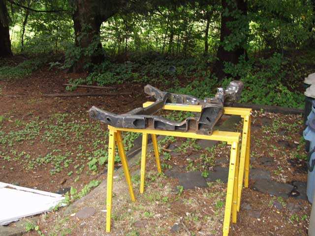

Report this Post09-11-2002 12:36 PM Click Here to See the Profile for chesterSend a Private Message to chesterDirect Link to This Post

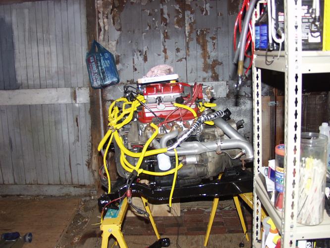

chester
4063 posts
Member since Jun 2001
Old motor off cradle
Stripped with wire wheel, ready for final prep
Little elbow grease to get the rest of the $hit off
Better then new!
Had to go thru this TWICE! Glad it done. Will start the assembly process hopefully tonight!
Lates for now!

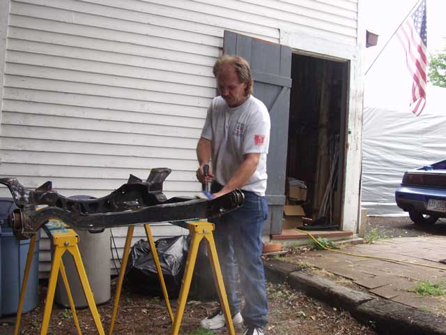

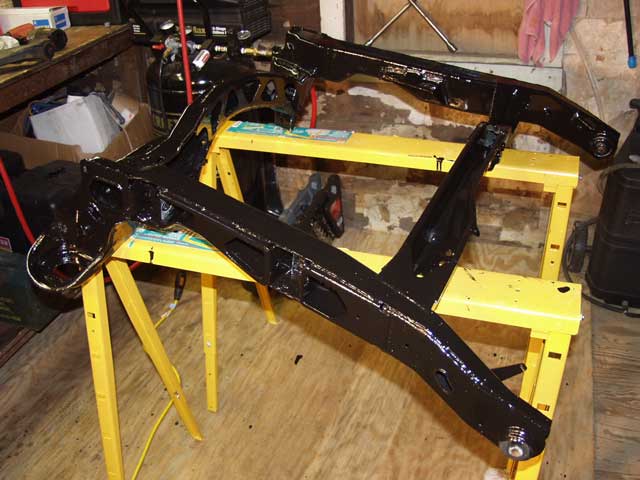

Just curious to see if you know an easy method to cleaning the cradle. I've had mine out now for a while, and its taking forever to scrape all that crape outta the inside rear section. Any tips???
Leper
No longer registered
Report this Post09-12-2002 04:13 AM   Send a Private Message to JncomuttDirect Link to This Post
I hope that you're not spraying POR-15 in the garage. There's some pretty nasty chemicals in it. That's why they suggest that you brush the stuff on.

Originally posted by Bazooka:
Nice package setup, Rob. Very valid point about doing the job right the first time. Good tips on the Por-15 with black or silver mixed in. Also, what does the Thermo-Tec Insulation look like and how thick is it? Your conversion is developing nicely.
Marty
Thanks Marty.
The Thermo-tec is a aluminized insulation thats about 1/4" thick. I'll break it out and snap some pics soon.
Rob D.
chester
Posts: 4063
Feedback score:    (42)
Total ratings: 153
Report this Post09-12-2002 06:30 AM Click Here to See the Profile for chesterSend a Private Message to chesterDirect Link to This Post
chester
4063 posts
Theres no real "easy" or I should say "clean" way of doing it. I started with a regular off the shelf degreaser like simple green and a scrub brush. The grime that was in the cradle openings I had to scrape out with a screwdriver and degreaser. Rinse, check, repeat Final cleaning was done with the stuff that comes with the POR-15, called marine clean. Really good degreaser! After that I wire brushed the real rusty parts and Elvira applied the metal etch and POR-15 coating.
It was brushed

Well, made some progress last night. Got the old motor on Elvira's new cradle so she can continue with her own project. Staged my cradle and cleand up the garage. We sat thru some of Achies video last night. WHAT A RIOT! The video is funny as hell. Good info! We're going out of town on business over the weekend so no workie on the V8 but that's ok, all in due time. See ya when we get back!

I've made some headway but have been delayed with other obligations. Only so much time in a day. I'll try to post an update later this week. Thanks for asking!!

Report this Post10-01-2002 08:39 AM Click Here to See the Profile for ElviraSend a Private Message to ElviraDirect Link to This Post
I am sneaking in a couple of pics from last night. Sorry Babe, HEHEHE
Isn't he a cutie!!
Elvira
President, New England Fiero Association (NEFA)
www.dirtyratracing.org
Blue 87GT 5sp (TruBlu)
Black 86GT 5sp (The Dirty Rat)
87 GT 4-seater (2+2)
Maroon 88 T-top Formula (Fun-In-The-Sun)
85 GT autocrosser (Auto-X)
chester
Posts: 4063
Total ratings: 153
Report this Post10-01-2002 08:46 AM Click Here to See the Profile for chesterSend a Private Message to chesterDirect Link to This Post
Thanks babe.
Elvira
Posts: 933
From: Frankfort, Kentucky
Report this Post10-01-2002 08:53 AM Click Here to See the Profile for ElviraSend a Private Message to ElviraDirect Link to This Post
Hmmm, this could be interesting!
Nice new screws!
And MY motor, getting it's yellow transformation while patiently waiting to go in my Blue GT!
Yellow plenum and valve covers just about ready to go on!

Report this Post10-15-2002 10:04 PM Click Here to See the Profile for chesterSend a Private Message to chesterDirect Link to This Post

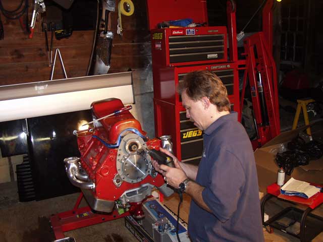

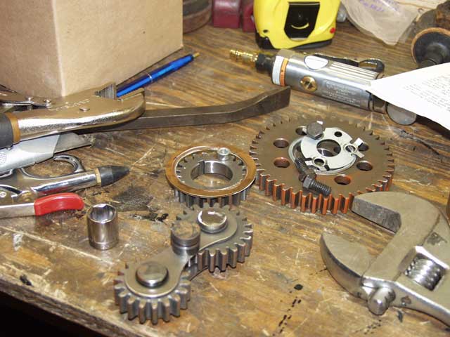

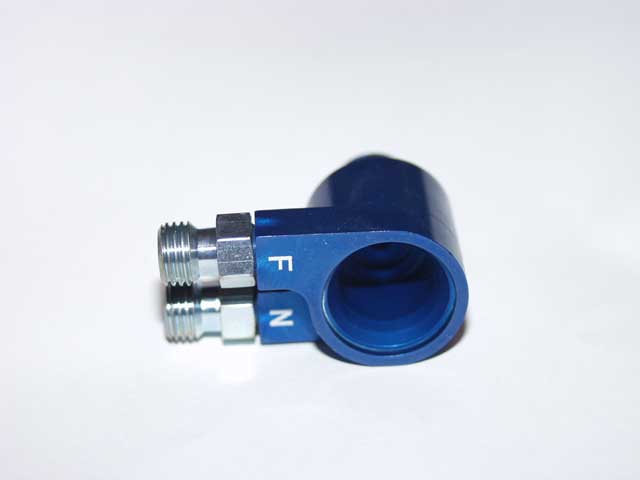

Well, finally got some time in the garage. I had a few set backs like a REAL sloppy gear drive (I mean like 1/4 inch of crank play ) Supposed to be a Dynagear but who knows. So it got replaced with a Milodon 3 gear unit. Direct port nitrous setup wouldn't work on my intake. Got that repalced. Anyway here are some pics of the steps along the way...
These are the NOS piggy back injectors I wanted to use. Real trick setup.
The Dyna Gear? gear drive I took out.
The Milodon 3 gear drive that was installed.

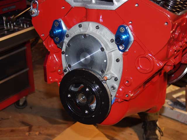

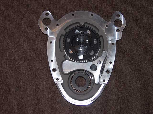

Drilling new guide pins for the timing cover. you have to adjust the gear lash before you do this.
Here it is all installed.
[This message has been edited by chester (edited 10-15-2002).]

Report this Post10-15-2002 10:10 PM Click Here to See the Profile for chesterSend a Private Message to chesterDirect Link to This Post
chester
4063 posts

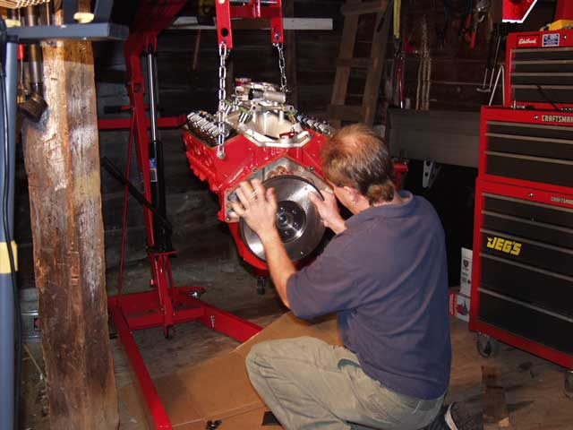

Of course I spend half my time running back and forth to the hardware store. A bolt here, a brass fitting there...phew!
Finally got her off the engine stand! puting on the flywheel.
Making progress

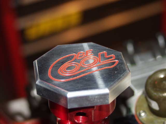

Valve covers polished up nice.

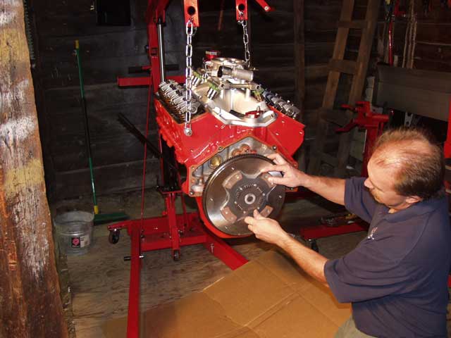

Clutch disk up aginst the flywheel.
Clutch and pressure plate. this is the clutch pack that CrazyD is currently using. So far so good!
A few details...
