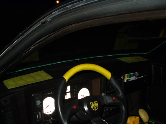

Here is a shot showing Jordans custom made Altezza tail lights lit up:
As for pics of the neons all lit up, I still have not figured out how to get the digital camera to take any good pics of them.
Here is one attempt to get a shot of the interior neons lit up:
As you can see, they barely show up and only the lower section of the windshield ones really showed up. The shift boot neons barely show and you can't see any of the under dash ones ;(
The shots I have taken of the full set of green under the car neons have all come out terrible so far.
We will keep trying though

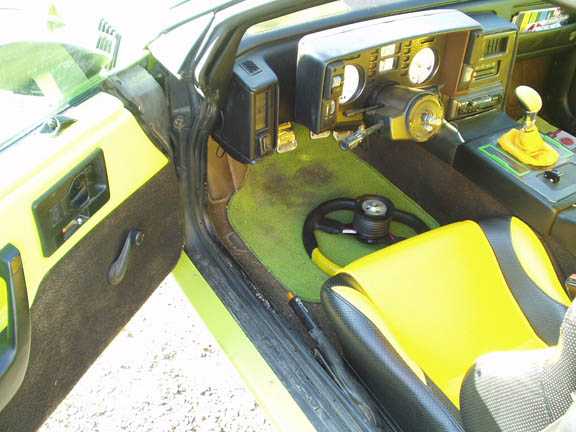

Here is a shot of Jordans newest feature.
A break away steering wheel
Steve

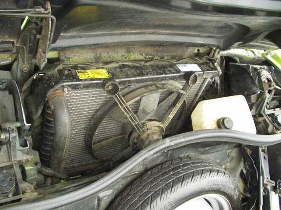

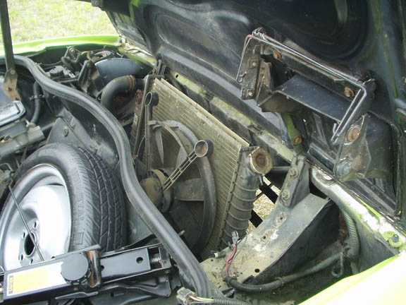

Last week, the radiator in Jordans green beast decided it wanted to make my life even more hectic than it allready is
It started as a small leak that caused the car to begin to overheat if I stopped in traffic for even a few minutes. Before I could get anywhere to take a look at it...Blam!... the radiator blew a hole so big in the cheap plastic side housing that I was barely able to make it to a parts store before causing serious damage to the engine.
After over 4 hours stuck at the Advanced Auto parts place in West lebanon trying to fix it myself (My father the mechanic was gone for the day), I was finally able to patch the hole with some of that "turns to steel in just 5 minutes" crap just long enough to hold enough water to get me home without blowing up.

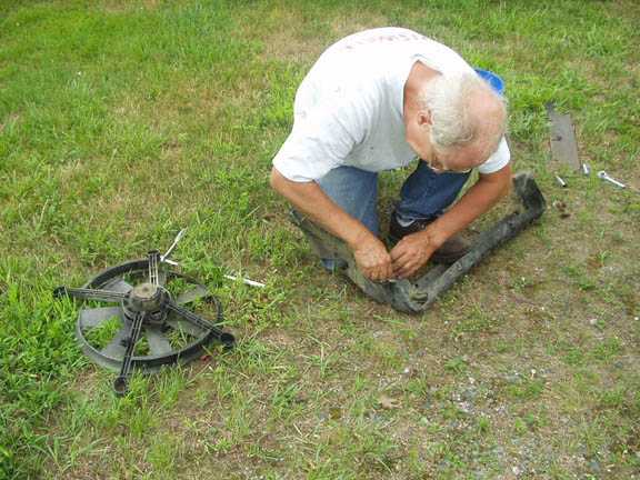

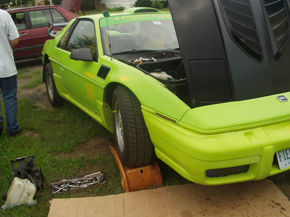

Here is my "mechanic" and I finally having some time to fix the problem.
I had allready freed up most of the radiator a few days ago when I patched the hole, so it didn't take us long to finish taking out the old radiator. My Dad first removed the headlight assembly on the pass side and took out the overflow bucket to give him more room to work:
Due to the low front end I could only get one side up on a ramp, which was fine as we really only needed to get that side up to reach the lower hose on the passenger side anyway:

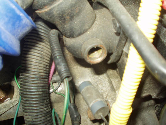

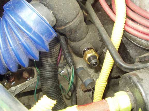

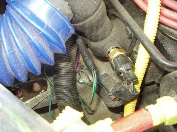

With old radiator now out, we could easily see what the problem was. In a winter sometime back the fluid in this radiator had apparently frozen and bulged out this side of the plastic housing causing it to split. When the engine overheated on me due to the temp module in the engine area being defective, the pressure found an out in the weak area of this split:
My Dad picked up a new temp module and he also picked up a better V6 radiator from Bob Parker at Kick Hill to replace the smaller 4 cyl one.

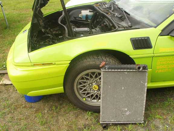

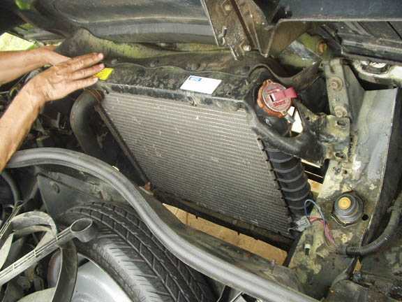

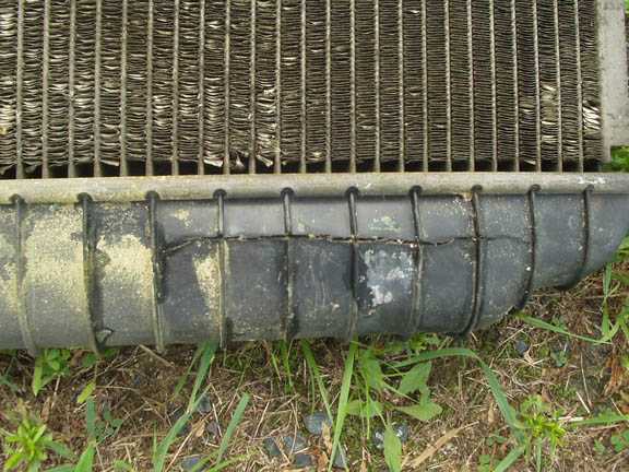

My Dad discovered that the radiator we were taking out was a replacement of the original. Jordans Fiero is a 5 speed, and the radiator we were taking out was an automatic. That is assuming that this isn't just another manufactureres error.
The bottom of the radiator and the support had been damaged (someone had at one time driven into a curb or something) so he had to take that support piece out first and repair it before we put in the new radiator.

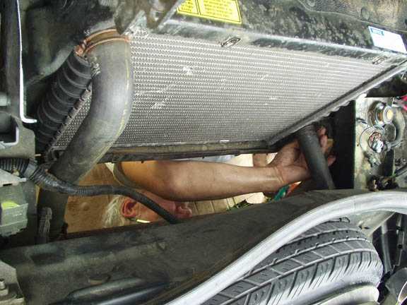

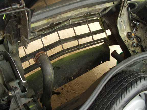

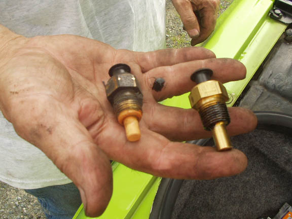

We then cleaned up the radiator area to get it ready for the better and bigger V6 radiator:
Here is the new radiator going in
Here you can see my Dad doing some last minute adjustments and tightning up the clamp on the lower hose
Now to take out the defective temp module that was not turning on the radiator fan causing half if not most of the overheating problem to begin with
Here is the old defective module and the new one
The empty hole waiting for the new module
Fiero5
Posts: 8882
From: Arecibo, PR
Total ratings: 367
Report this Post08-05-2003 12:58 PM Click Here to See the Profile for Fiero5Click Here to visit Fiero5's HomePageSend a Private Message to Fiero5Direct Link to This Post
Fiero5
8882 posts
Member since Jun 2000
Test fitting the new module
Once the module was tightened in the plug is snapped back on the end
With new module now in and the radiator and the fan all put back together and installed,
it was time to fill her back up with 50/50 radiator fluid and then fire Jordans beast up.
A test drive a few minutes later and Jordans green Fast & Furious beast was back on the road again

Doesn't the module on the front of the cylinder head control the fan? Better check that out, you may need another module as well.
Ira
87V6GT
Posts: 771
From: Plainfield NH USA
Report this Post08-05-2003 05:39 PM Click Here to See the Profile for 87V6GTClick Here to visit 87V6GT's HomePageSend a Private Message to 87V6GTDirect Link to This Post
Hi IRA. No this is it.I allready tested out the wire that went to this module and the fan came on(with the key on) and it worked.How about those WHEELS,I didnt know Steve was doing it.Have FUN! Russ.K.

We actually had the steering wheel off to work on something else and while it was laying on the floor I took the pic because I thought it made for an interesting pic.
Sorry to see that you still don't have a sense of humor

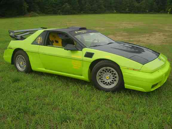

Not to flame here, but the paint on the car and the paint on the bumper/ground effect do not match. Why not ? I used to paint cars that's why I ask where the mistake was made.

On a "normal" stock 2.5 the sensor in the thermostat housing is the ECM temp sensor. The radiator fan switch should be the one sticking out of the left front of the head.
Pat
We have had 3 different places try and match the paint with no success as you can see. The local Maynards even has the correct exact paint chip and still can't match it, and Sanels has a paint color matching system with a portable unit that they take out to your car and shoot the paint on a selected spot to get an exact match and they can't even get close either. I wish we were closer to better paint people as these guys don't have a clue and obviously don't care
