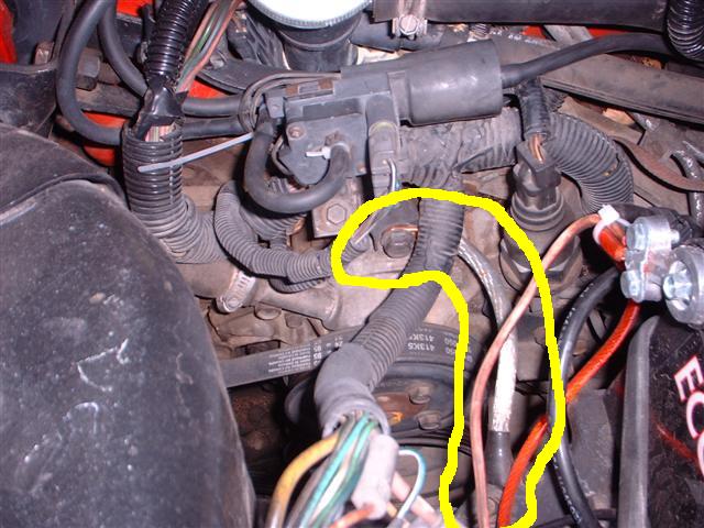

i added another Ground Strap
about a 6inch pc. of 4Ga. Wire that goes from the 15mm bolt that holds the EGR Solinoid Bracket on, to the bolt by the battery tray where the small ground wire is that comes off of the negative Bat. terminal with the 10mm bolt,
and my car runs ALOT smoother, it idles better, and seems to all arround have a little more Get up and go to it
i suspect that the stock one was just getting a little crusty, so i added another one and im amazed at the differance a 6" Pc. of wire has done!!!
somthing to think about
just thought id share
EDIT to add pic
Rich AIM one fast 2m8
[This message has been edited by $Rich$ (edited 01-19-2004).]

Apicture would help to see more what you mean, if possible. Thanks for sharing though.

Outlaw: i my batterys Just died in my cam wile taking pics of my new headlights, but i think it would be hard anyways because its kinda tucked in there,and wouldnt show up well
just look at yours, there is a ground wire going from the negative battery Terminal down to the chassie, its held in by a 10mm bolt, one end of the new ground goes there, and the other end goes to the 15mm bolt that holds in the bracket to the EGR, its either ON or right above the Waterpump
easy

Thats a cool piece of info, if someone else can get a pic that would be cool too.

I too added an extra earth strip last year. See the pic below. From the Fiero Plenium to the right hand rear strut. And then from the Strut to the Battery. Thus creating a new Chassis earth at the same time. Before i had over 100ohm's resistance from the Chassis to the engine. Now its 0 Ohms.
I also noticed Smoother Idling, and about 2MPG better gas millage.

$rich$, do you have a pic of where you added this wire? i dont really know where you added it. and i d like to try this myself.
i think i may have a ground problem.... light sometimes dont come up, crappy ideling, and when i start the car the volts meter light comes on, and stays on until i rev the engine.

are these in the right spots?
i just added the wire and i saw no difference at all so i thought id check.
my car runs like hot garbage.
http://www.members.shaw.ca/rmhome/wire.jpg
Looks like your trying to ground the mounting bracket. I ran mine to a bolt on the head.
Try to keep it short as posible.

Report this Post01-19-2004 09:40 PM Click Here to See the Profile for rmphotoSend a Private Message to rmphotoEdit/Delete MessageReply w/QuoteDirect Link to This Post
ok i moved it off the bracket and onto the bolt that holds that bracket in place.
this is the right spot and yes i did notice a difference in idling, and brighter lights..
cool, and cheap

wow this thread is back from the dead, im glad too see that my info is helpfull
ill go out now, and tra and snap a pic for ya'll, its dark outside but ill see how it turns out, ill post the pic in the first post on this topic

Report this Post01-19-2004 09:59 PM Click Here to See the Profile for $Rich$Send a Private Message to $Rich$Edit/Delete MessageReply w/QuoteDirect Link to This Post
$Rich$
14575 posts
Member since Dec 2002
OK i posted it in the top too but here it is again
Geez,... its cold as hell outside and Dark as hell too, the things i do to be helpfull
so why do i have the little red showing in my bar;?)
edit: also be sure to scuff up the contact points for better grounding abilitys
