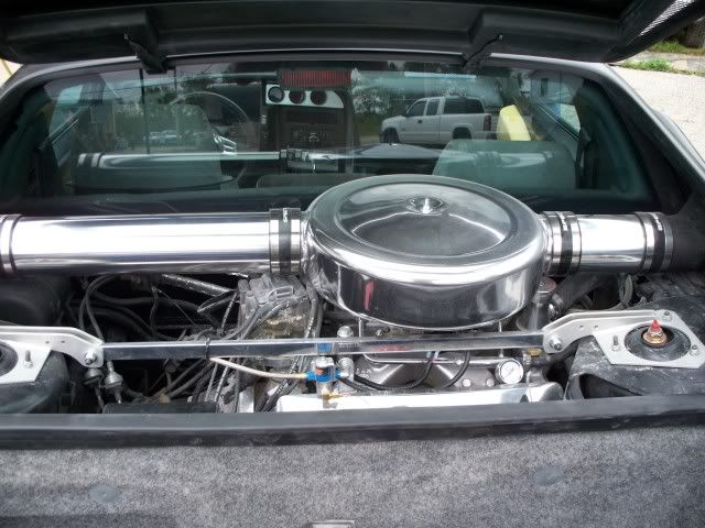

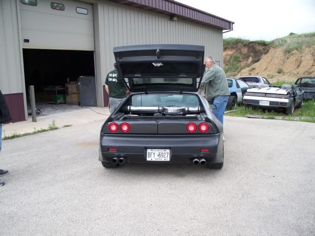

Bringing this thread up to date....

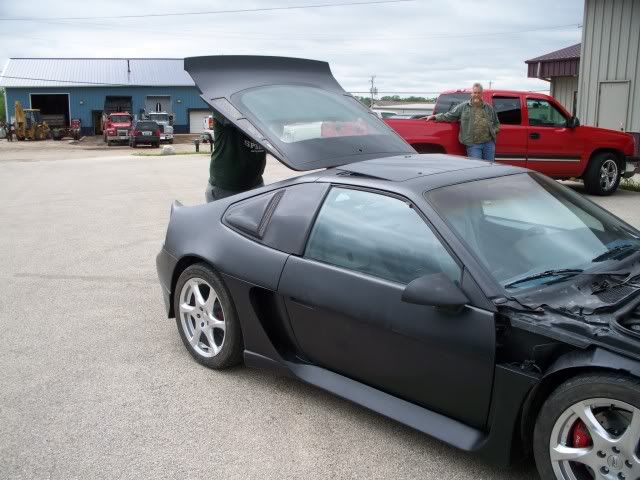

I don't think I ever described the hinges we made for the hatchback lid.
As I've stated before I wanted this hatchback kit done so that no mods needed to be done to the rear clip to install the hatch. So we modified the old Fiero decklid hinges to fit under the plastic upper rear roof section of the rear clip.
We then inserted a threaded plate between the 2 layers of the Fiero spaceframe behind the sunroof opening.
The hatch is setup to use the original Fiero decklid bumpers, Key Lock & latch....

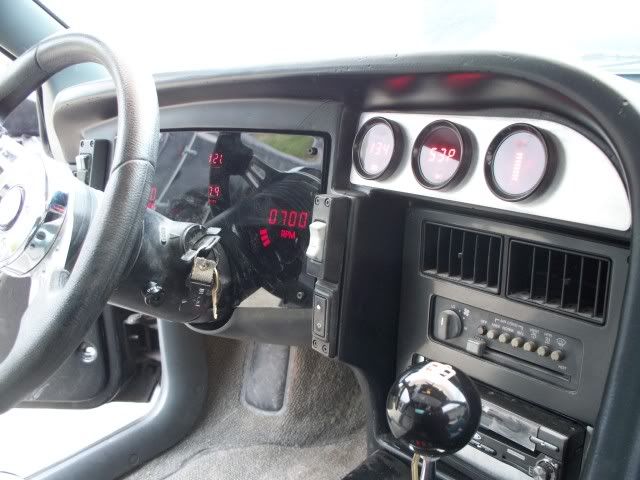

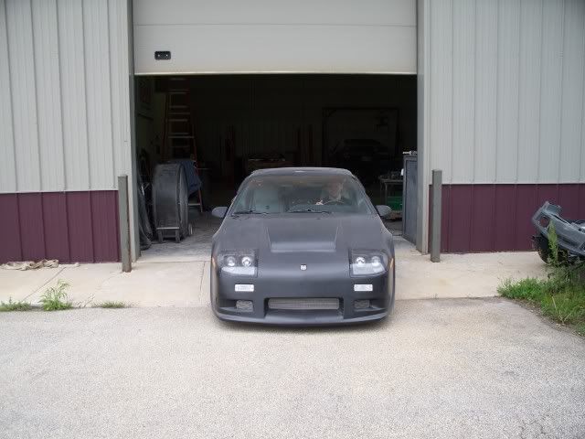

On the underside of the hatch where the screens are, we made a flat fiberglass trim pc. to give it the same finished look as the rest of the underside of the hatch. It's glued on at the same time as the screens are installed with 3M Window Weld.
With most of the mods we do here, we don't do final paint here & most paint guys want to do their own prep for paint. Considering that it may be a few months before this car is painted, it was decided that We'd put a coat of primer on it to get it presentable. The guy who will be painting it was consulted as to the primer we would use so that it's compatable with the stuff he will be using when he preps & finishes the car.
So we set about scuffing up the body, Masking it off & putting 2 coats of primer on it.....
Now we're putting it all back together for the last time.
Since Clayton has been having trouble getting the wheels he had on order & since the car will be shown at the Dells this month, clayton decided to get some wheel adapters to move the wheels out 2.75" until he gets the new wheels.
More pics later.

Sorry, I'll have more pics tomorrow morning.
We put the 350Z rear window into the hatch today & it needs to sit for a few hours before we can take the weights off of it.
If it doesn't rain, we'll get it outside for some pics tomorrow as early as I can.

Report this Post05-14-2009 11:21 AM Click Here to See the Profile for ArchieClick Here to visit Archie's HomePageSend a Private Message to ArchieEdit/Delete MessageReply w/QuoteDirect Link to This Post
The plan is that this car will be at the Dells show in 2 weeks.
Archie

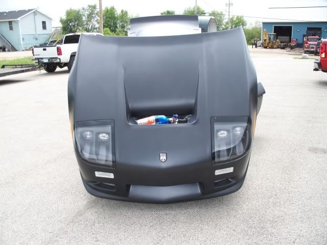

Report this Post05-14-2009 11:44 AM Click Here to See the Profile for ArchieClick Here to visit Archie's HomePageSend a Private Message to ArchieEdit/Delete MessageReply w/QuoteDirect Link to This Post
Archie

Report this Post05-14-2009 12:00 PM Click Here to See the Profile for whodeanieClick Here to visit whodeanie's HomePageSend a Private Message to whodeanieEdit/Delete MessageReply w/QuoteDirect Link to This Post
Now that looks great!

Report this Post05-14-2009 12:09 PM Click Here to See the Profile for Tony KaniaSend a Private Message to Tony KaniaEdit/Delete MessageReply w/QuoteDirect Link to This Post
That looks awesome in flat black! Very nice looking car.

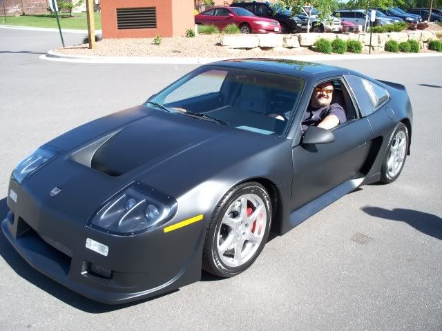

Report this Post05-14-2009 10:15 PM Click Here to See the Profile for ArchieClick Here to visit Archie's HomePageSend a Private Message to ArchieEdit/Delete MessageReply w/QuoteDirect Link to This Post

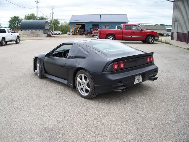

A few more pics with the Sun at the other end of the parking lot.
Archie
Sig by Custom2M4
Fiero Thomas
Posts: 4671
From: Round Lake Beach, IL
Registered: Jul 2005
Feedback score:    (170)
Total ratings: 124
Report this Post05-14-2009 10:30 PM Click Here to See the Profile for Fiero ThomasSend a Private Message to Fiero ThomasEdit/Delete MessageReply w/QuoteDirect Link to This Post
Archie
Posts: 9436
From: Las Vegas, NV
Registered: Dec 1999
Total ratings: 547
Report this Post05-14-2009 10:42 PM Click Here to See the Profile for ArchieClick Here to visit Archie's HomePageSend a Private Message to ArchieEdit/Delete MessageReply w/QuoteDirect Link to This Post
Originally posted by ducattiman:
WOW,,i am sorry if this question has allready been asked.(skimming real fast)
Is this hatch going to be made as a kit and what is the cost?
Yes, the hatch is available as a kit.
The price is $675.00 & includes the upper hinge bracket. (you'll have top modify the Fiero decklid hinge to work with it)
It is steel reinforced in several places. The kit doesn't include the 350Z rear window because you can get them locally cheaper than we can ship you one.
Note that the hatch doesn't include the rear spoiler that we installed on this car. You can see pics of the hatch without the spoiler on this same car back on page #3.
Archie

I think it looks great in semi gloss black... with some nice wheels it would set it off...

Nice job on the completion. I have a question about the digital dash. Where did it come from? That's exactly what I want to do with my Fiero and the digital dash, it looks great.
Enjoy!!
Jun 7th, 2009
ClayTonto
Posts: 524
From: White, GA, USA
Registered: Dec 2008
Report this Post06-07-2009 01:12 AM Click Here to See the Profile for ClayTontoSend a Private Message to ClayTontoEdit/Delete MessageReply w/QuoteDirect Link to This Post
Clay do you have any more body modifications planned or is it ready for paint ?
What color do you plan to paint it ?
A couple of minor tweaks involving some more carbon fiber and the mirrors. I'm still trying to decide on paint. I was dead set on black, but after driving it a few days in hot sunny weather. I may go with a lighter color.
Originally posted by Alex4mula:
Are those wheel spacer I see back there? Sorry if mentioned before. I didn't read the whole thing.
No wheel spacers, I had temporary billet hub adapters made.
Cyberdyne gauges in a custom built housing.
