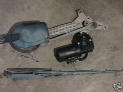

How does $40 sound?
1995 E320 wiper gear
Click Here
Here is a picture of how it looks on the car.
[This message has been edited by Songman (edited 02-20-2007).]

Crap! The eBay item number is 280083266842 but now someone has bid on it and the Buy It Now is gone. Oh well, the bid is at $9.99 and there is 1 day 18 hours left in the auction.

Mercedes uses single arm controlled as shown above. It has that little extra cam in there to make the arm pivot as it goes across the windshield. A little more complicated but worth it for range of vision.
There is a company called Bonrath that makes a single wiper conversion that is popular with the VW crowd. They recommend a place called CFI Motorsports for the kit which is a little over $200. I tried to reach them but their website is down and no answer on the phone.
Here is another kit that from VWs but I don't know if it is rectangular pattern or just a sweep.
http://www.dubstopimports.c...earch.x=0&Search.y=0

easy one to find is from the 190 e model they go back as far as 86 and are faily cheep
E Bay Item number: 140087800490 here is one
[This message has been edited by bubbajoexxx (edited 02-20-2007).]

Yeah, it'll have to be late 80s or so. newer MBs don't have them.
I saw an old SL500 in the parking lot today and it had the single wiper. I could confirm from the wipe pattern on the glass that it used the controlled pattern. Pretty cool looking.
You didn't see any Lotus Elise in the parking lot did you? I like that one too.
