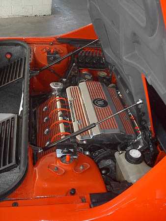

Taylor wires came in last Friday. I'll remove the coil pack from it's current location to the location behind the rear bumper. I would've had it mounted, but my aunt forgot to call me.
bubbajoexxx
Posts: 1630
From: Ontario Canada
Total ratings: 112
Report this Post03-06-2011 08:19 PM Click Here to See the Profile for bubbajoexxxClick Here to visit bubbajoexxx's HomePageClick Here to Email bubbajoexxxSend a Private Message to bubbajoexxxEdit/Delete MessageReply w/QuoteDirect Link to This Post
at that distance you are going to have some bad misfires that is to far for the wasted spark system to funtion properly way to much wire there will be way to much resistance in the wire and you can not use wire wound core wire to reduce it
[This message has been edited by bubbajoexxx (edited 03-06-2011).]

Thanks for the headsup. I'll call CHFAB on Monday. Currently, the wires I've used are at least 34" in lenght with no issues. Keith Huff also used similar lenghts, but I'm not sure of his Taylor ignition wire measurements. Keith's wires appear to be at least 34" if not more. I'll call Chris West on Monday to confirm.
I need to talk to bmwguru.
Your relocated ignition coils.....
[This message has been edited by madcurl (edited 03-06-2011).]

Wire day: cutting the excess.
Nearly 2 feet removed for one ignition wire. I found a way to snake the Taylor wires in and around thus eliminating several inches. On number #015 I'll use the same sizes.
Nicely tucked underneath the Caddy plenum.
Chris West demonstrated how-to crimp the first two ignition wires as I did the rest.
I love my big and round tips.
On Wednesday we're moving onto the emergency brakes.
[This message has been edited by madcurl (edited 03-15-2011).]

Report this Post03-16-2011 09:47 PM Click Here to See the Profile for madcurlClick Here to Email madcurlSend a Private Message to madcurlEdit/Delete MessageReply w/QuoteDirect Link to This Post
Clean-up:
madcurl
Posts: 21401
Total ratings: 314
Report this Post03-16-2011 10:30 PM Click Here to See the Profile for madcurlClick Here to Email madcurlSend a Private Message to madcurlEdit/Delete MessageReply w/QuoteDirect Link to This Post
madcurl
21401 posts
Member since Jul 2003
Moving items around: The Plenum issues.
Before:
The desired location.
After.
The PCV was in the way:
Part removed:
Chris stamped out four 1/14" flanges.
We moved the plenum cover forward to reduce the gap between the Caddy cover and valve cover.
Cut out a section for PCV.
Also the other side too.
Gone are the black Caddy plenum nuts. Replaced with chrome caps.
finished:
[This message has been edited by madcurl (edited 03-17-2011).]
