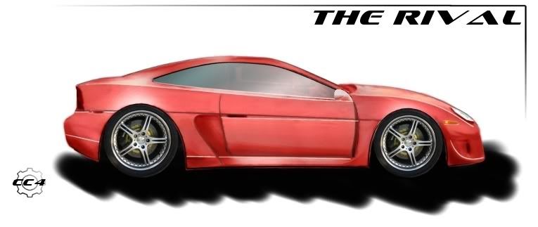

Here we go:
tell me what you think. I spent quite a bit of time on it.
EXCELLENT!!!!
However, the hood scoops will follow along these photoshop designs.
EXCELLENT!!!!
Both photoshops are excellent and both go beyond the normal photoshop and captures the Mad-Arch game plan. You're photoshop skills will not be wasted nor forgotten...trust me. Once #020 is finished (I hope), everybody from "Archie and the Crew" -to- "ALL Photoshoppers", and even from the constructive comments (they're needed to keep a person on track and to prevent "Homer-Moble-tunnel-vision) will be able to say, " Hey, I had a part in making this car."
Btw, Bubbajoexxx suggestion is still ringing in my ear. Thanks Bubbajoe.
"Anyone can make a copy of something, it may look good but it ever is the real car. Make something from your imagination, something unique, something nobody has, anything is possible and, ideas can be a reality."
