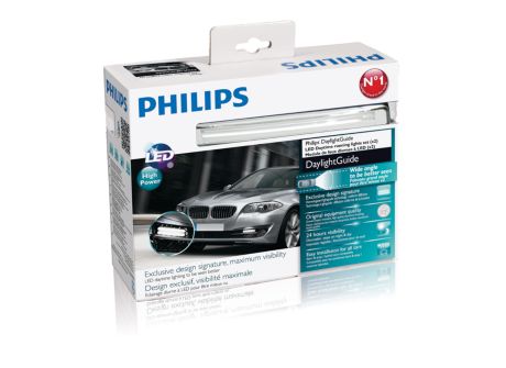

I just picked up a nice set of Daytime driving lights, when I'm at Archie's in two weeks we will have to find a spot to mount them, I'm looking at the "shark gills" on the side of the nose or in the grill what do you think?
