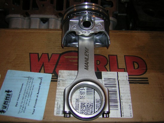

Hey Darth you are absolutly correct, but you don't need to run alot of boost in a SBC to make alot of power .
As for stock internals STOCK SUCKS !
I'm pretty confident on these parts abilities to handle some boost
HARDCORE SBC FAN AND PROUD OF IT ! GOT TQ ?
