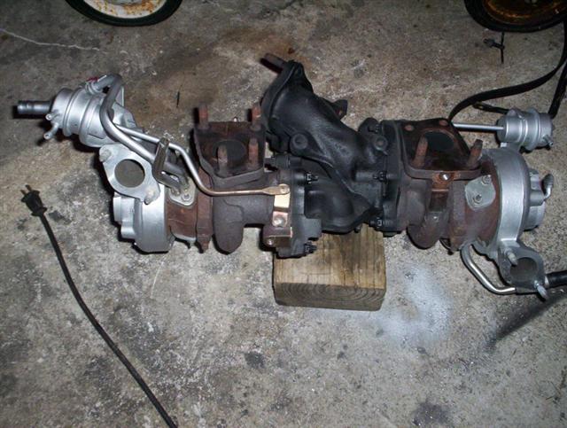

Did you know that the 4.9 can be made to go much faster and blow a lot of car away with simple mods by changing the cam for a more aggressive cam grind stiffer springs and using an adjustable cam sprocket to degree in the cam that allows you to increase your redline to 6000rpm or torque curve from massive low end or more mid range to high output .
"King of the Hill" Twin Turbo V8 GT,
250hp Direct Injected Nitrous Oxide System
To the tune of 450 horsepower, if i'm not mistaken? Just imagine what would happen if you built it up with quarters instead of dimes?? You'd kill some ferrari's..
Or you could just install a N* and blow away said 4.9 Sounds like way to much work for not alot of benefit. May as well go with a newer motor with 300hp stock then spend a ton of money modifying a motor that was never designed for high hp.
And more you're surely mistaken!!!! and if I used $$$ instead of quarters I would buy you some sense and some more green on your red ratings

MTA, what kind of numbers are you looking to make with a TT that was designed for a 3L motor? Obviously the "5.1" may need a few more cfm than that turbo can produce efficiently.

I am very optimistic as to what I am looking for but will keep that till it is done tuned in and yes it came off a Supra that was converted to a bigger single turbo but at least it will be very competitive plus I will have the nitrous system .What ever the results I will send you personally a time slip from the track as dyno #s is not my performance indicator.
