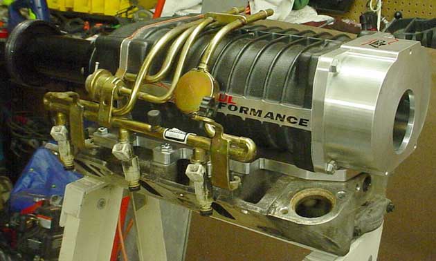

Originally posted by cadero2dmax:
Only a Rootes type blower can give full boost at idle, and you will never see a Rootes-type blower on a production car unless it is an expensive exotic - it is too costly for standard production cars, and the engine life would be very limited!
"Roots" styled SC installed on a Stock SSEi Motor.
I think that the blower that you are thinking of is a WHIPPLE, not the Eaton's that are installed by GM on their SC'd motors.
Here's a guy form Club Grand Prix that is actually putting the Whipple ( what I think that you were refering to ) onto the L67 blocks via a super cool adapter plate:
[This message has been edited by mcaanda (edited 07-04-2005).]

mcaanda
No, you are completely right. I blew it - -.
I should have compared the Eaton M90 supercharger (as used on the 3800SC) to a centrigugal type such as the ProCharger style that you pictured - - in performance! I know that the Eaton unit has a belt drive that turns two helix rotors. This is a spin-off of the true Rootes type blower (like the Whipple you pictured, and the GM family of 3-71 to 14-71). But the Eaton DOES offer a little more boost at idle than the centrifugals, and almost as much boost as when they are spooled up.
The Eatons are MUCH smaller, however, than the true Rootes. Their smaller inlet and deep tapered outlet are what makes them similar in performance to a centrifugal. The Eaton's are more efficient and quiter than a true Rootes (or a centrifugal, for that matter). That and the fact that they offer (comparative) nominal boost make them practical for mass production a lot more than a true Rootes type blower.
I am not bad mouthing the Eaton's, either. Quite frankly, at one point I was looking for a M112 Eaton for my 4.9 - - - - after I learned about the ProCharger's lag (similar to what you stated about your Powerdyne) - - but that's another story.
Anyway, sorry for the misrepresentation.
That "stock" motor you pictured has a pretty large set of headers, maybe 3 inches??. That should indicate just how stock that motor really is!
G
G
Definition of "stock" huh... LOL...
I do have a few "go fast" goodies installed, the modular 3.4" pulley, and the headers are non-stock, but essentially the rest of the block is. No EVAP, EGR, Boost Control Solenoid & CAT round out the list of "non-stock" items either removed and or disabled.
Good call, I should have been a little more specific on what I had stated as stock and what not.

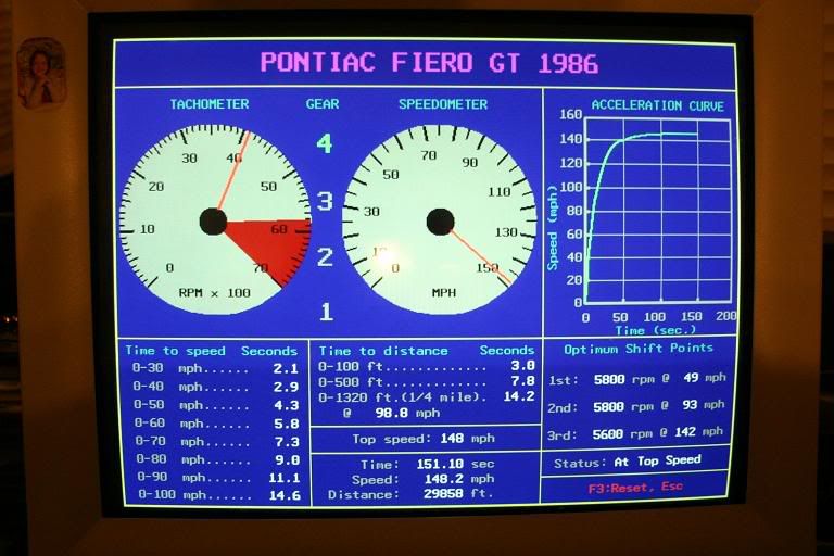

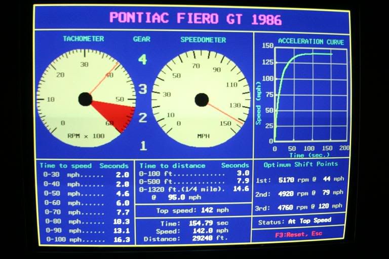

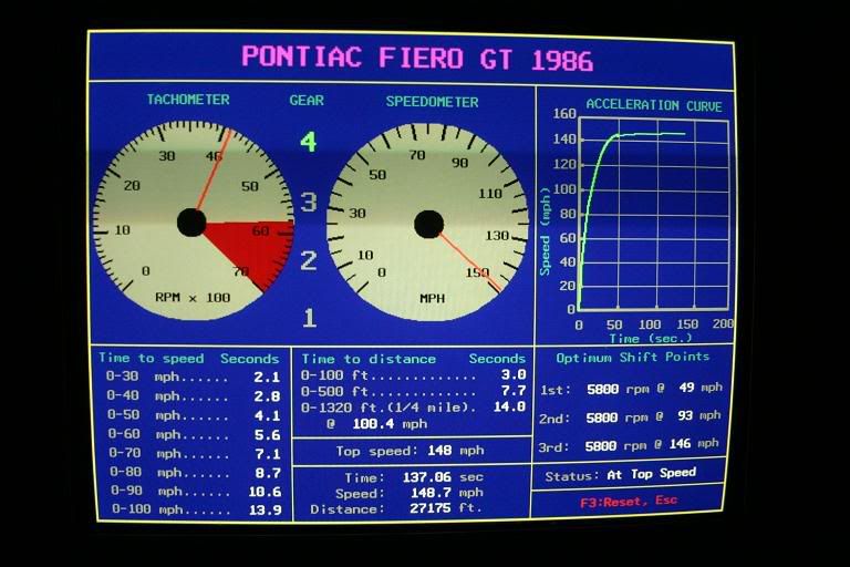

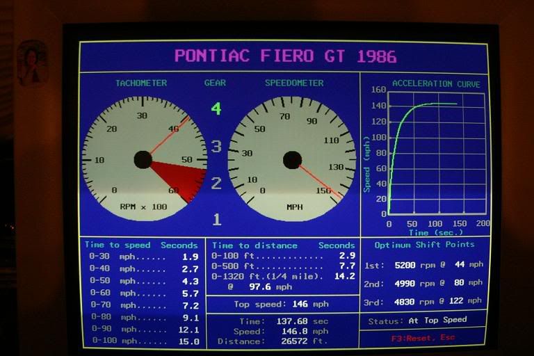

Originally posted by lildevil:
And there is NO way a 4.9 beats a 3800 to the 1/8 mile. Just face it...the 3800sc is a better all around motor then the 4.9
All things being equal, I would say that its a close call.. Using the ever popular program "Car test", which is supposed to be over 95% accurate with it's predictions, i plugged in the specs of each engine and ran them using the stock weight and specs of an '86 fiero GT. Here are the results with screen captures of them. ALL tests were run using the 4t60eHD transmission with the following specs:
2.97:1 final drive ratio
2.92:1 1st gear
1.56:1 2nd gear
1.00:1 3rd gear
0.70:1 4th gear
a test weight of 2700 pounds was used for the 4.9L and a weight of 2800 pounds was used for the 3800SC engines:
Stock 4.9L, 200 hp@4400rpm, 275 lb ft@3000rpm, 0-60mph in 6.0 sec.,
0-100ft. in 3.0 sec., 0-500ft. in 7.9 sec., 1/4mi. in 14.6 sec.@95.0mph
Fastchips ($150 eprom) 4.9L, 220 hp@4400 rpm, 290 lb ft@3000rpm, 0-60mph in 5.7 sec.,
0-100ft. in 2.9 sec., 0-500ft. in 7.7 sec., 1/4mi. in 14.2 sec.@97.6mph
Stock 3800SC S2, 240 hp@5200rpm, 280 lb ft@3600rpm, 0-60mph in 5.8 sec.,
0-100ft. in 3.0 sec., 0-500ft. in 7.8 sec., 1/4 mi. in 14.2 sec.@98.8mph
Stock 3800SC S3, 260 hp@5400rpm, 280 lb ft@3600rpm, 0-60mph in 5.6 sec.,
0-100ft. in 3.0 sec., 0-500ft. in 7.7 sec., 1/4 mi. in 14.0 sec.@100.4mph
Of course, real world results may vary from driver to driver and engine to engine, depending on many variables, but all in all, it's a close race. The reason why i threw in performance numbers using the superchips eprom, is because MOST of the people on here use rockcrawl's chip, which is pretty maximized, so i would assume it uses a timing/fuel curve similar to that of superchips, or perhaps even slightly better. Do the 3800sc engines have more potential? Of course they do, forced induction always is a big advantage, however, it takes loads of money to do so. But, there is no denying it now, a rockcrawl chipped 4.9L is more than likely faster than a stock 3800 sc series 2 off the line. the series 3 3800 is a different story all together, however, MOST of the 3800sc swaps are series 2 swaps. Everyone can argue, " with a simple SC pulley upigrade I can get 'x' amount of HP from the 3800, and blah blah blah"... well, of course you can! The point is, the 4.9L is a cheap swap, and it puts up virtually the same numbers, and to most people, it SOUNDS a whole lot better. It's the smarter buy, period, not to mention, if something breaks, they are a dime a dozen in junkyards now, since early nineties cars are the most abundant in the yards now. Anyways, anybody can feel free to ask me questions about the tests i ran using car test. please email me directly too, aside from repsonding to this thread, aaronrus@earthlink.net
Interesting to note that a Rockcrawl, but otherwise stock 4.9 should run about 14.2 in the 1/4. Like you said there are tons of mods to make 3800SCs faster, but you stated the main point beautifully, the 4.9L is a cheap and easy swap that yields pretty good results.
